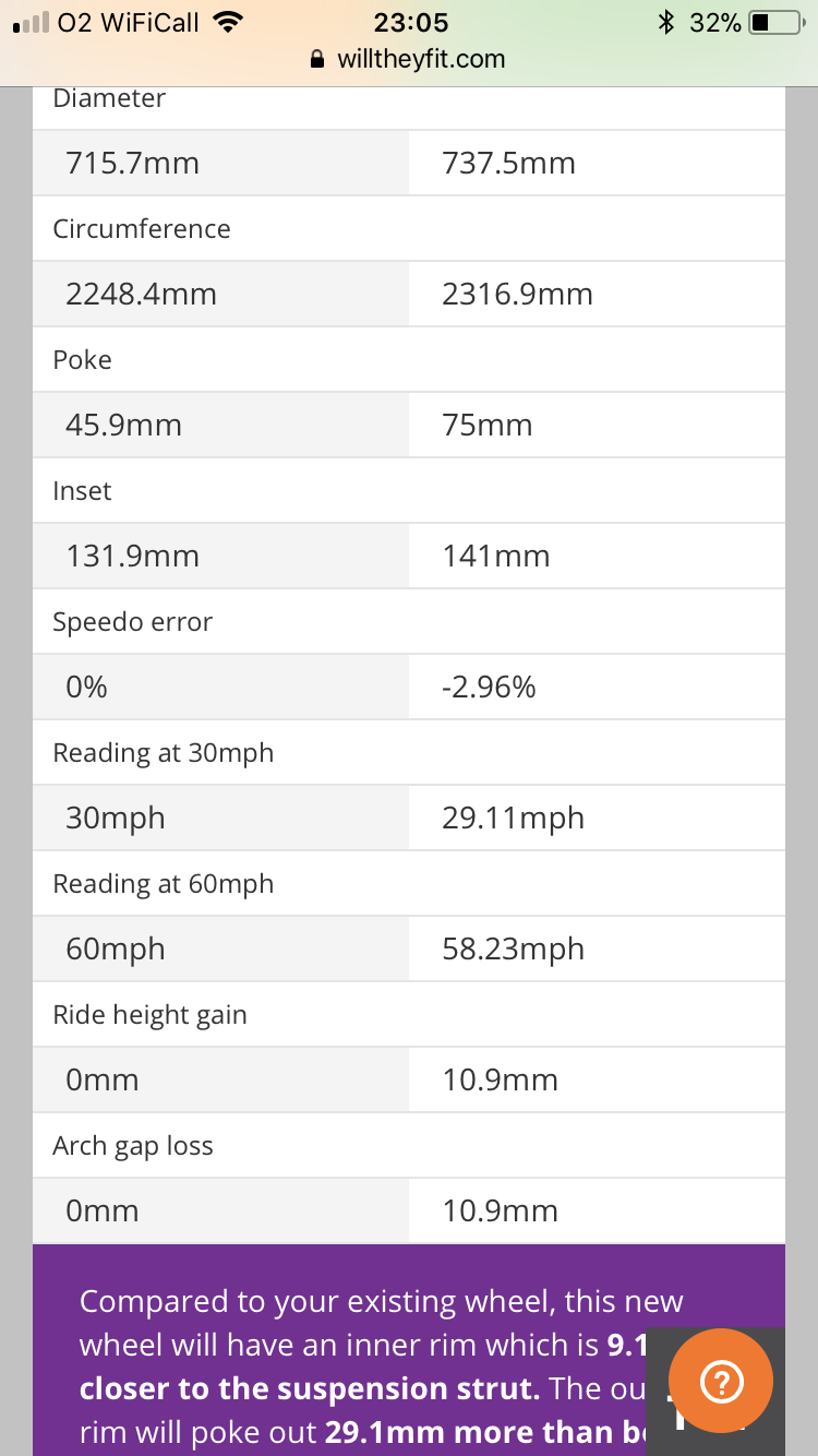

I tend to use this website as a good guide when looking at new wheels,
https://www.willtheyfit.com/
It's only a guide but if you use it to give you an idea of how the new wheels will fit then it can help inform your decision.
D7428039-5B11-4C75-A7A9-3A67EC25453B.thumb.png.ecc24da0d6f23b6a8c91f55d77f6dc24.pngThabks
I suppose it gave me an idea but I just don’t know enough to make a decision based on the pic it provided and the details ..

Does Es anyone think this looks ok
