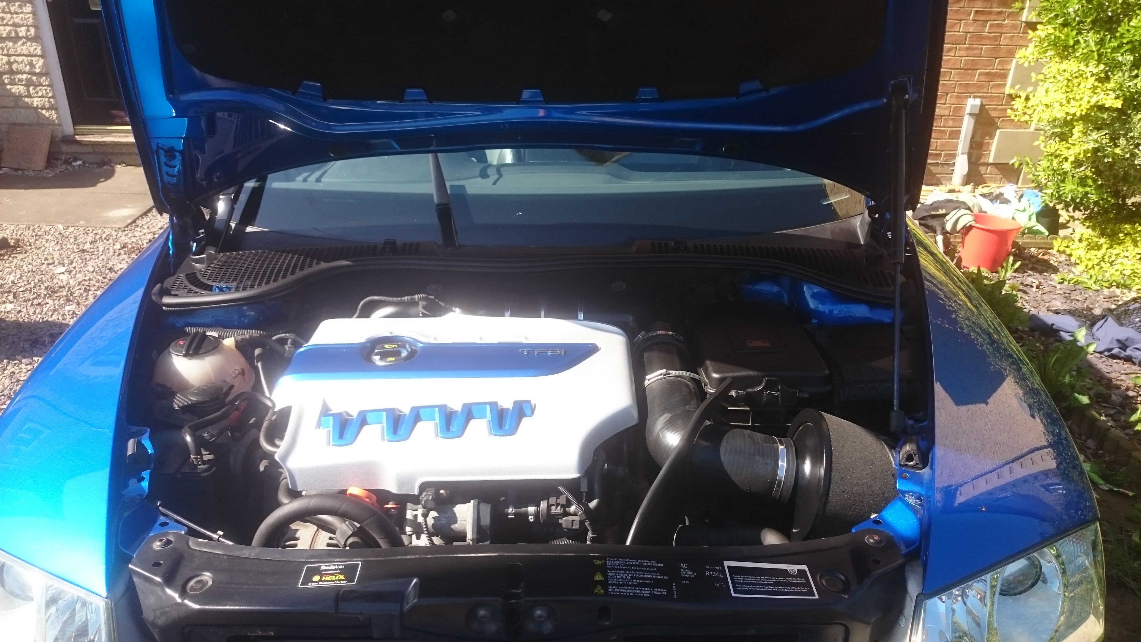

I've just fitted a Ramair kit to my 06 VRS, see here https://www.briskoda.net/forums/topic/447791-engine-cover/
But I've now been reading about heat soak and water in the sparkplug hole issues........
Has anyone fitted a heat shield to the rear engine cover mounts or to the filter as additional protection?
If so, where did you get the parts from? (Garagemidnight on Ebay??)
What about the water issue? Has anyone made a water cover for the top of the engine?
Or am I just being paranoid???
ATB,
Kev.

I've got an Audi TTS cover on mine which I guess would solve the problem. Or you can modify the original cover to fit around the induction kit.

No additional ducting, I've left the original air box feed in place, and the induction kit turbo Heatshield helps keep radiant heat away from the main intake pipe.
I can't say I've noticed an issue with heat soak. But I mostly do A road journeys. In stop start, and urban driving it may be more of a problem
