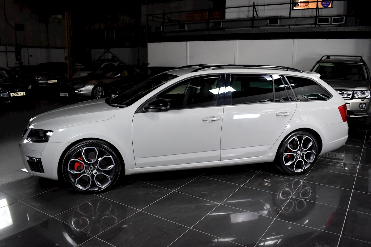

 I am a relatively new owner of a 65 plate (2015MY) Octavia vRS tsi dsg, loving the car and obligatory showroom pic is attached because its not that clean anymore and it really is meteor grey not white lol.

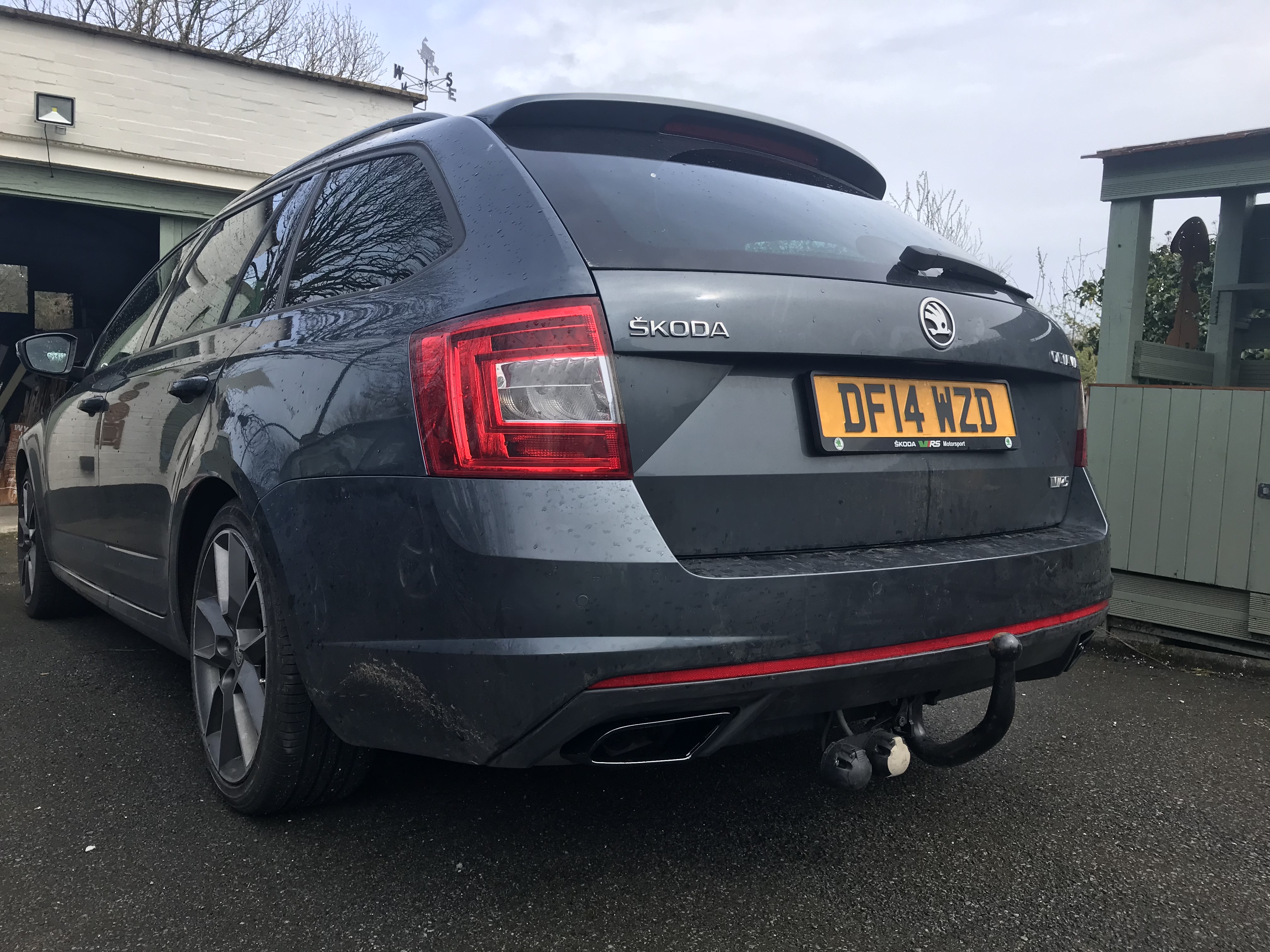

A blackline is an SE based model that has a body kit. I have a witter fixed swan neck bar on my vRS, fits fine. All vRS towbars are interchangeable :)

Yeah, that’s the one, black edition, black line, I get them mixed up, but on the Mk3 there’s one of them with a deeper rear bumper skirt that will present issues when fitting towbars. vRS wise, they all fit. Witter also use the same part number for an Audi A3 btw. BE is a nice body kit considering though :)

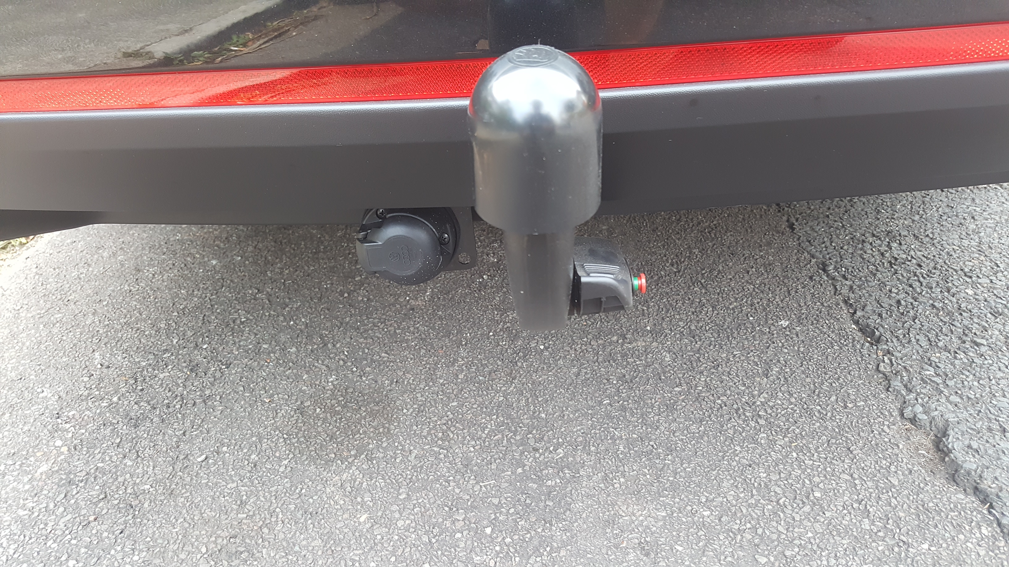

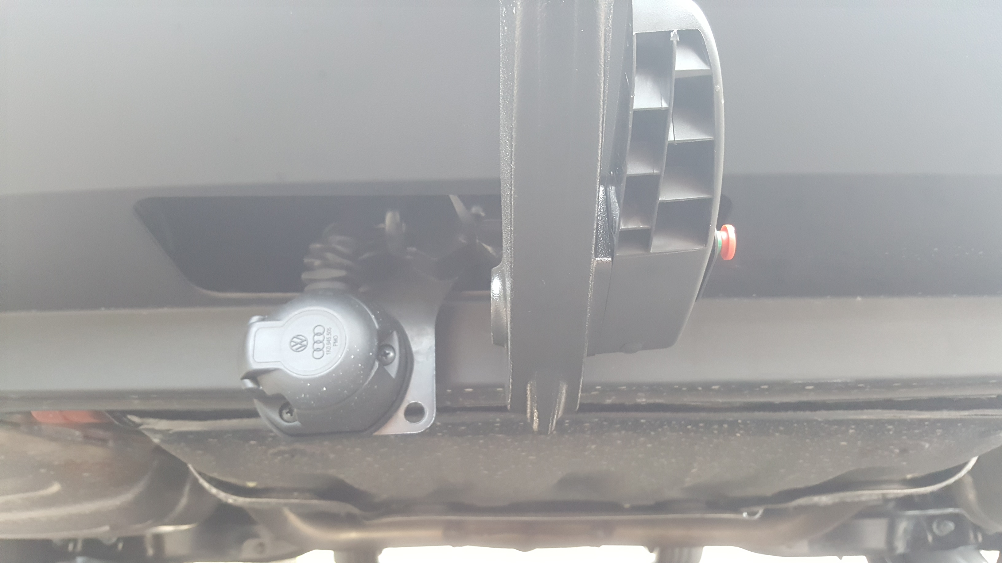

Wouldn't have thought the rear valance will present any more issues that the standard valance.
It's just a square cut hole in the very under side, it's both small & not visable
Is that a Westfalia one? On my Witter one with the folding the electrics the cut has to be huge!! It works though, which is the main thing I suppose :)
