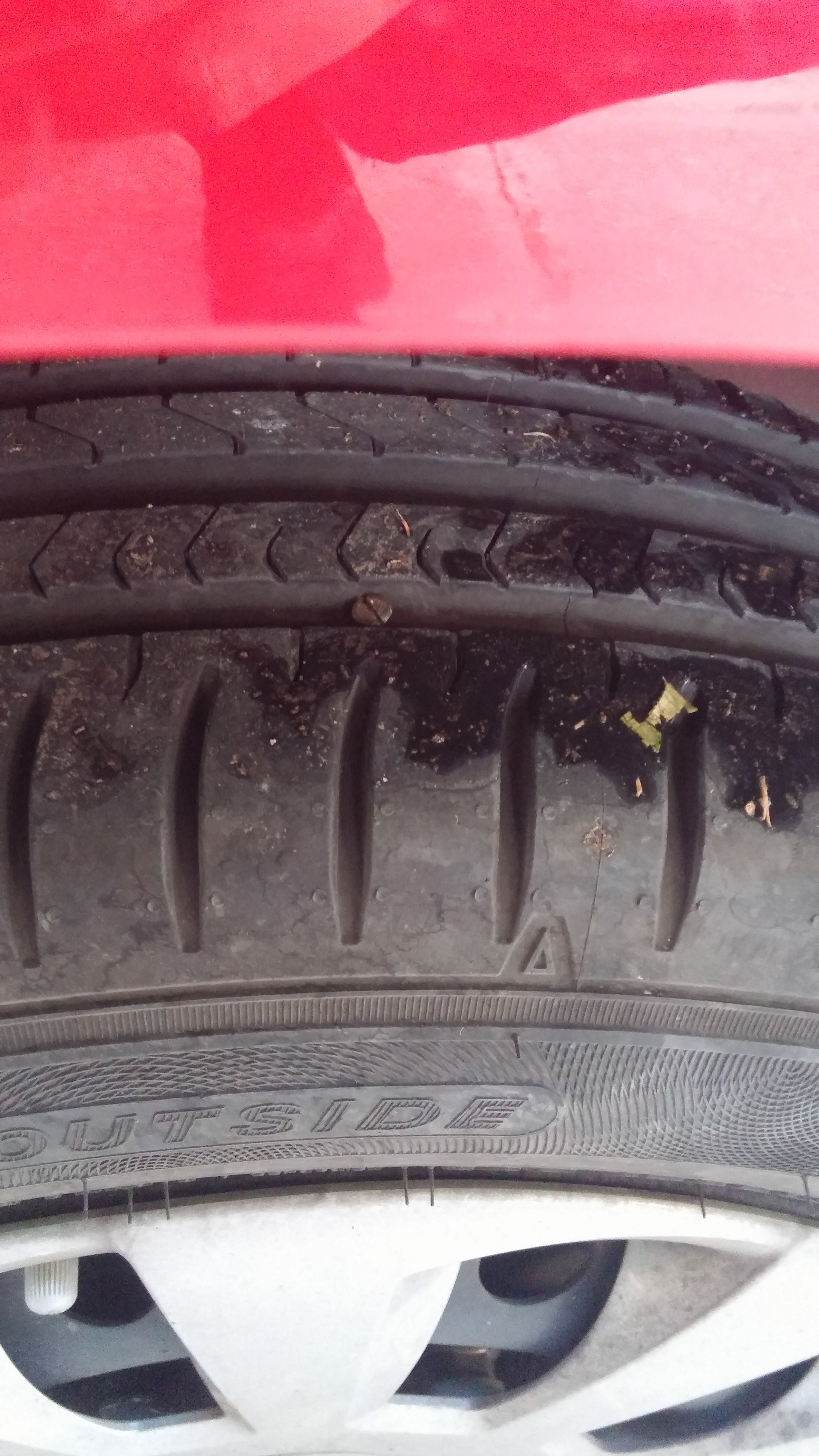

Slow puncture?

Slow puncture?
Yes. Mystery solved upon closer inspection today. How well can problems like this be resolved? It's still a pretty new tire, I'd hate losing it so soon or not being able to trust it later.
I'm pretty sure they can help you at a tyre shop.
Oh I know they can help me. I just never had a puncture like this, so I don't know how reliable is the fix over time in the hot Mediterranean climate.
Puncture repairs can be done within the centre (75%) of the tyre. I think yours is within this boundary.
Might be different in Greece however
Edited by Jonny118118
10 euros for the repair, it is as good as new, no reason to worry about longevity, so says the technician.
