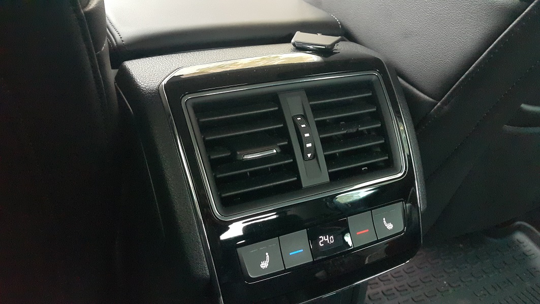

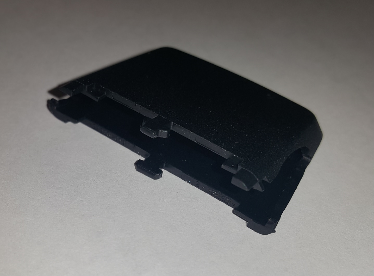

Please look at the following pictures where the rear air vent adjuster has broken away:
This particular fault raises very serious health and safety issues… especially for younger passengers.

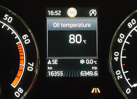

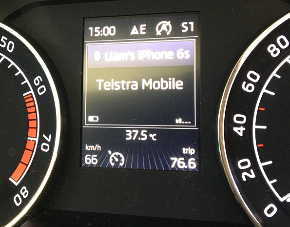

I noticed that there was a software update issued in the summer of 2016 to correct the problem of the Start-Stop indicator obscuring the Drive Mode/Gear indicator on the Maxidot display.
For some reason this update is not available for cars produced just a few months earlier so I’m now stuck with this problem even though a fix is available.
The following images show the issue:
my 2016.03
corrections met on 2016.06

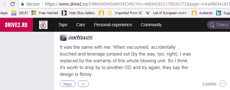

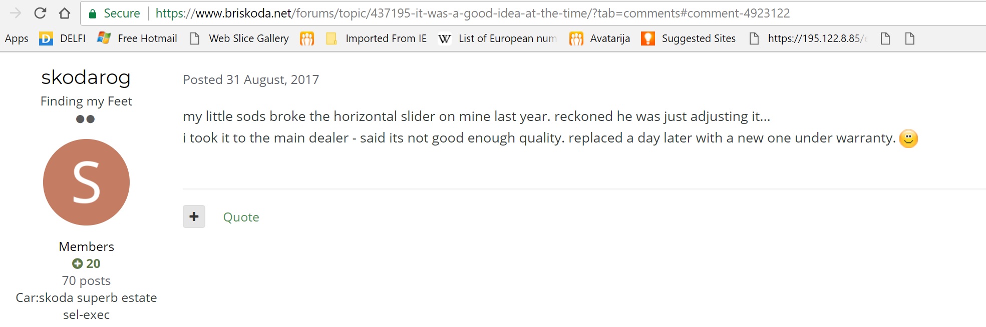

my rear vent broke too - came off in my oldest son's fingers - thankfully he is old enough not to put in his mouth - but others may not be lucky. i gave my son a telling off, accusing him of breaking it, but then saw it appeared to be common. skoda uk agreed to replace mine under warranty last year.

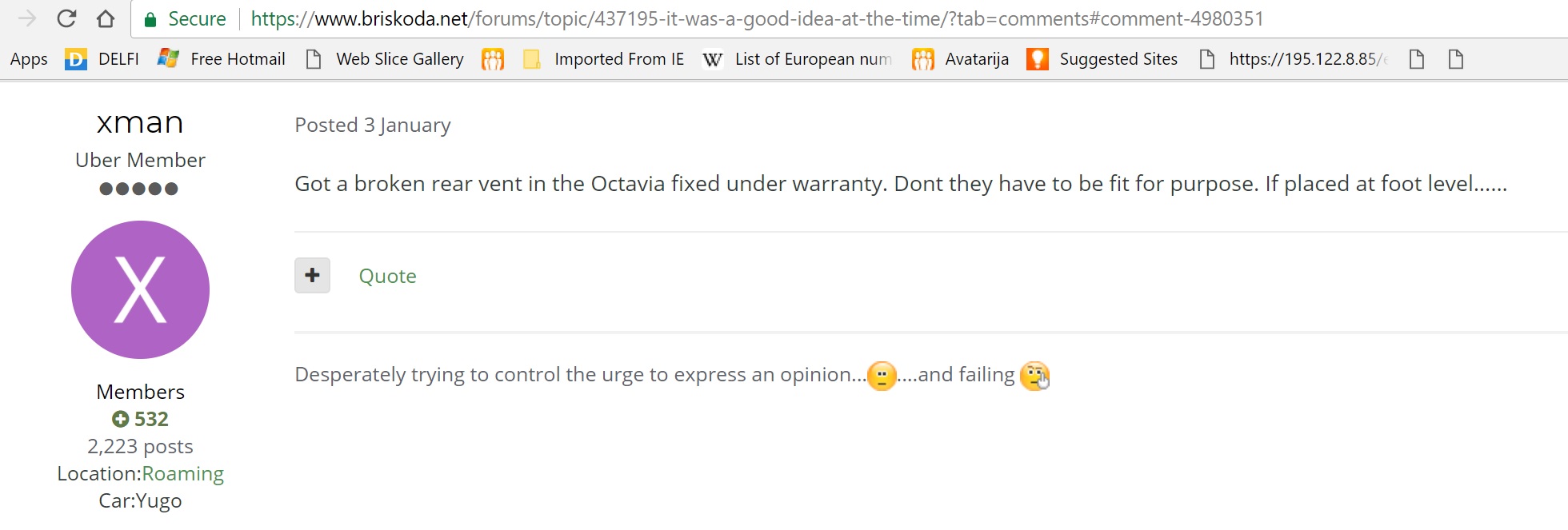

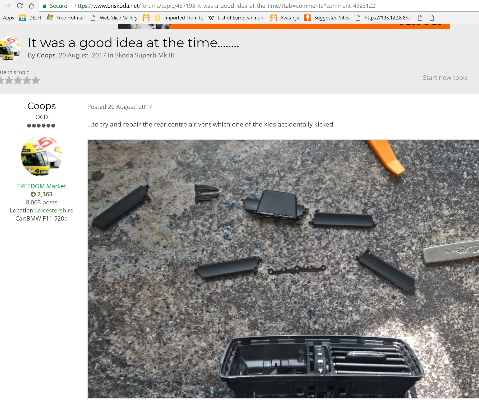

BUT, completely rejected warranty repair for rear air vent, their conclusion is, it has been kicked
where this looks as kicked?!
later i made screenshots from BriSkoda and Drive2, to prove i'm not unique and how does look kicked one
and sent them by e-mail
but they suggested not read much forms cause Skoda Auto official resources gives there only one answer - REJECT
