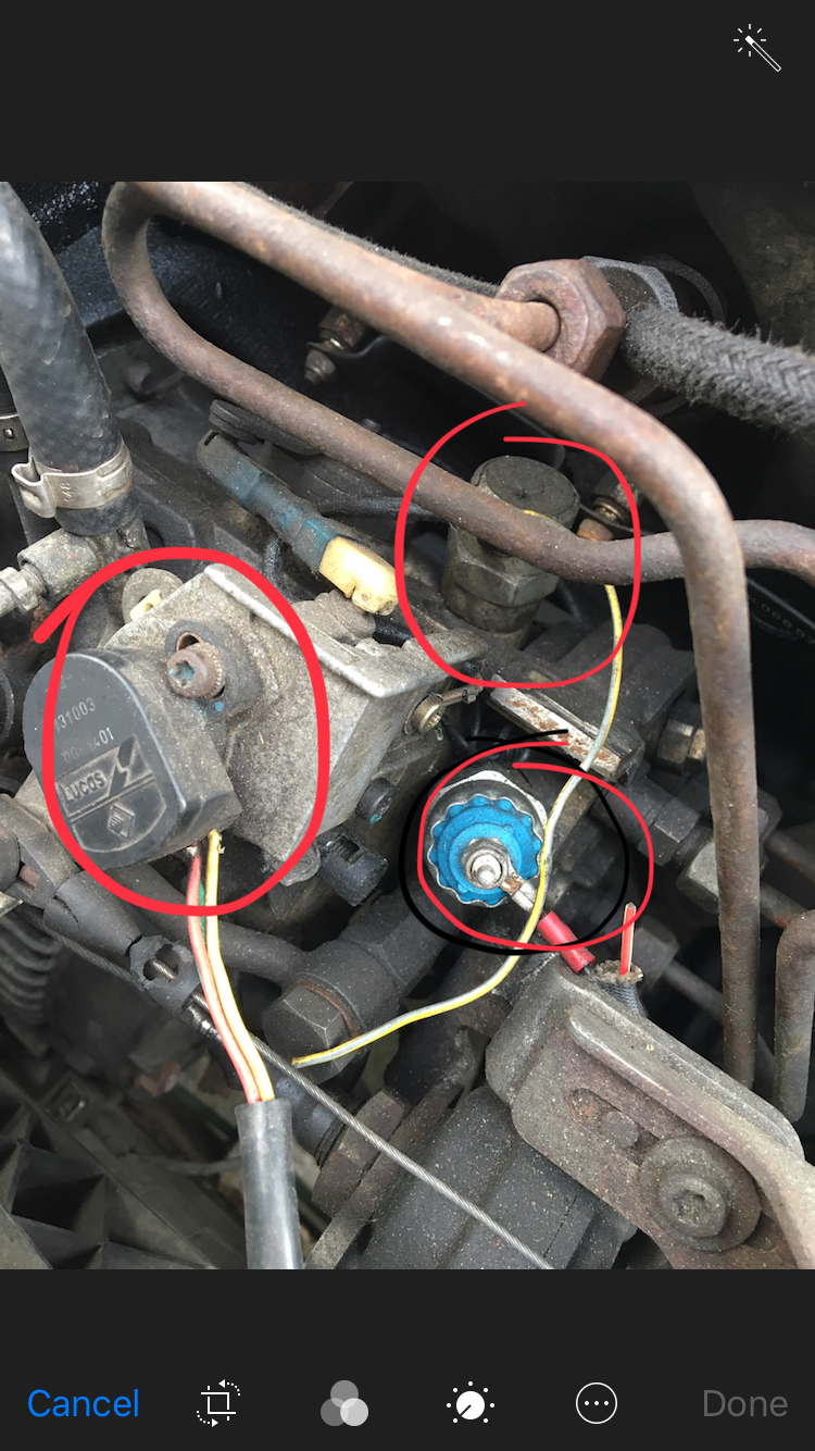

What are are these sensors ? 1.9D Felicia pickup. Assuming the one on he right is the fuel cut off but none of the sensors has all of its wires connected ...

Is there any info regarding the wiring for these three sensors ? Each one has at least one of its wires disconnected ...
I found the missing N108 wire.
but, the red wire near the cut off solenoid N109 looks like its been cut and the other half is hidden under a bracket. Is this an immobiliser wire?
