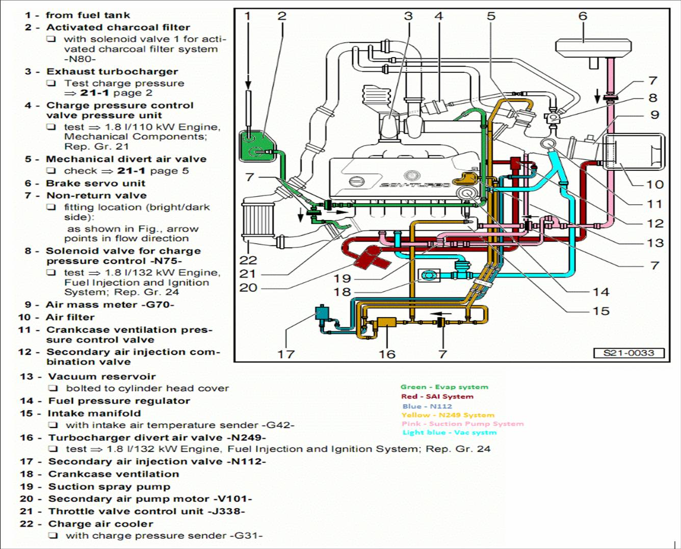

The first pic shows the engine breathing system N249 is item 16, the second pic (thanks to Bowders) shows its location of
being underneath the perforated metal cover at the front just below the inlet manifold and alongside the dipstick. The N75 controls the turbo wastegate.
5ae31ab1e31da_BreathingSystem.thumb.jpg.9ba58333daf4f864407fe4a74bd60fba.jpgN249.jpg.b4bf254fac34ccd8fa7b460978f64282.jpg
