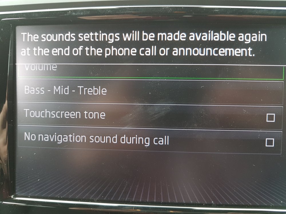

Hi, I've just fitted a MIB2 Columbus in place of my MIB1 Amundsen, I was expecting a 'component protection' error and but instead I have no sound on the unit and the following error
"The sound settings will be available again at the end of the phone call or announcement"
The volume control does nothing. Has anyone seen this error before? I have tried the reset (hold power for 10 seconds but that did not work)

seems like its locked in a loop thinking either theres an active call or the nav is making(or thinking) its an announcement,
have you tried to do a reset (press and hold the power button till it turns off and boots up again)

Yeah tried that. I'm sending it back as faulty, the eBay seller agrees something is not right with it.

Does anyone know if the Columbus requires an external amp? Mine hasn't got one so that may have explained the no sound issue
Edited by Dave77
If you have an external amp then you'll have the Canton sound system. I have, and I couldn't get mine to work with either the old amp or the new MIB2 amp I'd bought. If you don't have an external amp then the Columbus would just be coded to work without the sound system and it should work.

Just in case someone else has this issue and finds this post. See halfway down this post which suggest the issue could have been component protection
http://www.vwwatercooled.com.au/forums/f128/component-protection-out-nowhere-116087.html#post1207726
Quote
If this is not the case for a control unit, then the component protection is activated in this control unit, which has an impact on its function. For example, a classic symptom of CP for the infotainment unit (i.e. J794) is for the sound to be permanently muted (the unit otherwise works OK, but without sound). Another example is when the Dashboard module is locked by CP -all of the lights and the two clock dials permanement flash on/off and the center display keeps flashing the message "safe CP"!
I'll write up my Amundsen(+Canton) -> Columbus retrofit-adventure on a separate post (coding, installation, problems, seller etc.) a bit later (maybe to the end of that long Columbus retrofit -post), but, I think I had some of the same issues you're facing now.
1) Your unit probably was coded for external amplifier (Canton sound system) and not for basic speakers (- or the other way around, can't remember when I got that message).
2) Some of those Ebay units wont show "CP Active" -message on screen but with VCDS you'll find it still active (but doesn't seem to affect anything) - that seems the "no CP" -workaround but I'm not sure.
3) I had MIB1 Canton Amplifier [8V0 035 223], and confirmed, it doesn't work with MIB2 Columbus - You'll need second generation amp [81A 035 223] or [3Q0 035 466 A].
4) Active component protection on amplifier causes sound to come out only from the driver door. MIB1 amp causes the volume button to have no effect.
