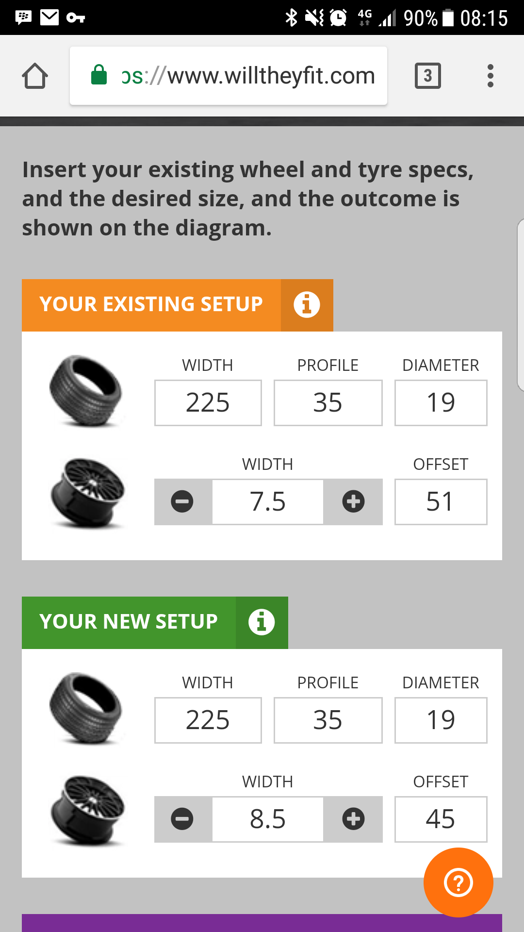

www.willtheyfit.com is very good to help visualise your options.
They are 19x8.5 so u think a ET45 is best ? I’ll go for that

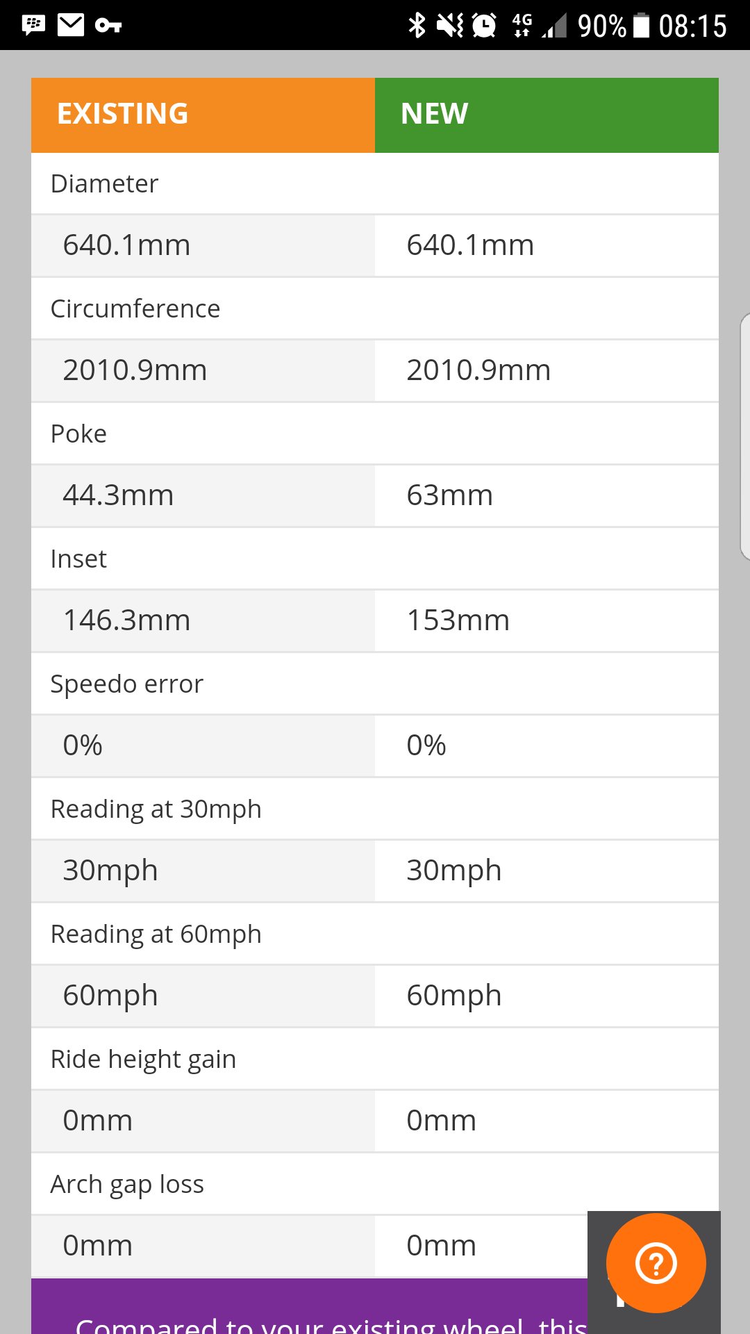

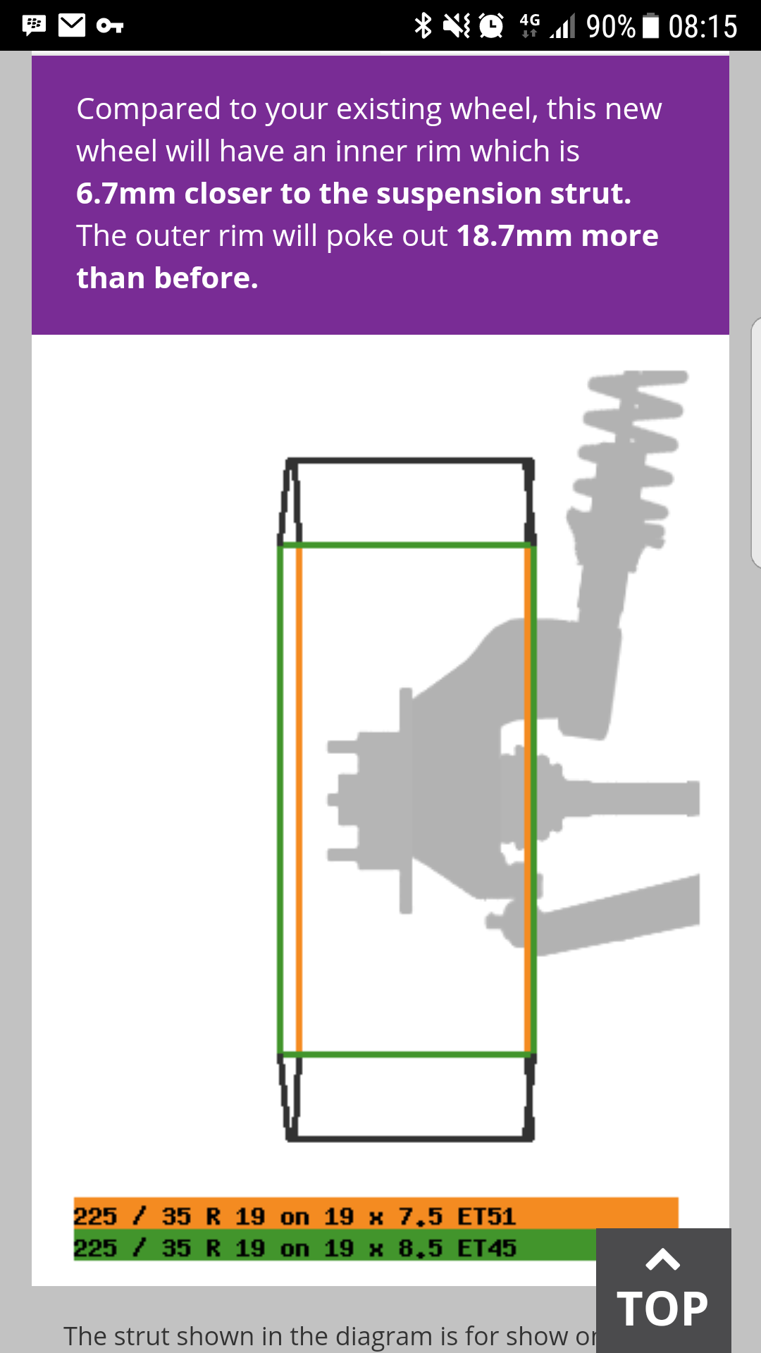

Willtheyfit tells us this:
So you have approx 19mm more poke - I deffo wouldn't go more than that.
