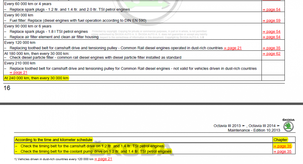

From WORKSHOP MANUAL SKODA OCTAVIA III:
If someone has other official document from VAG who specifies when the timing belt must be changed, please post it here.
Thanks,
So, correct me if i am wrong but every 210 000km - Replace tooth belt for camshaft drive and tensioning pulley...
Is this all i need to be concerned about? Not a certain number of years?

@peugeot_205_gti At 210 000 km is for DIESEL engines;
The table I posted is from SKODA.CZ MAINTENANCE MANUAL 2013( not Workshop, sorry). I didn't know that Skoda UK build Skoda cars so they can give the real and correct time to change the timing belt, but they must have something to work it. I think that, in time, the problem will be the coolant pump, not the timing belt, even if it's driven by another belt. I have the impression this will be a discussion like " which is best, 95 RON or 98 RON". So do what you think it's best for your car.
PS. I search in Maintenance Manual from: 10.2013/ 12.2014/ 01.2017/ 03.2017/ 05.2017/ 10.2017. The same thing, nothing changed.
look at the edition....October 2013.....not up-to-date!

Yes, that's correct. But, Skoda Octavia MK3, 1.4 TSI 103kw/140HP was made until May 2015. So, I think this table is good enough(12.2014):
