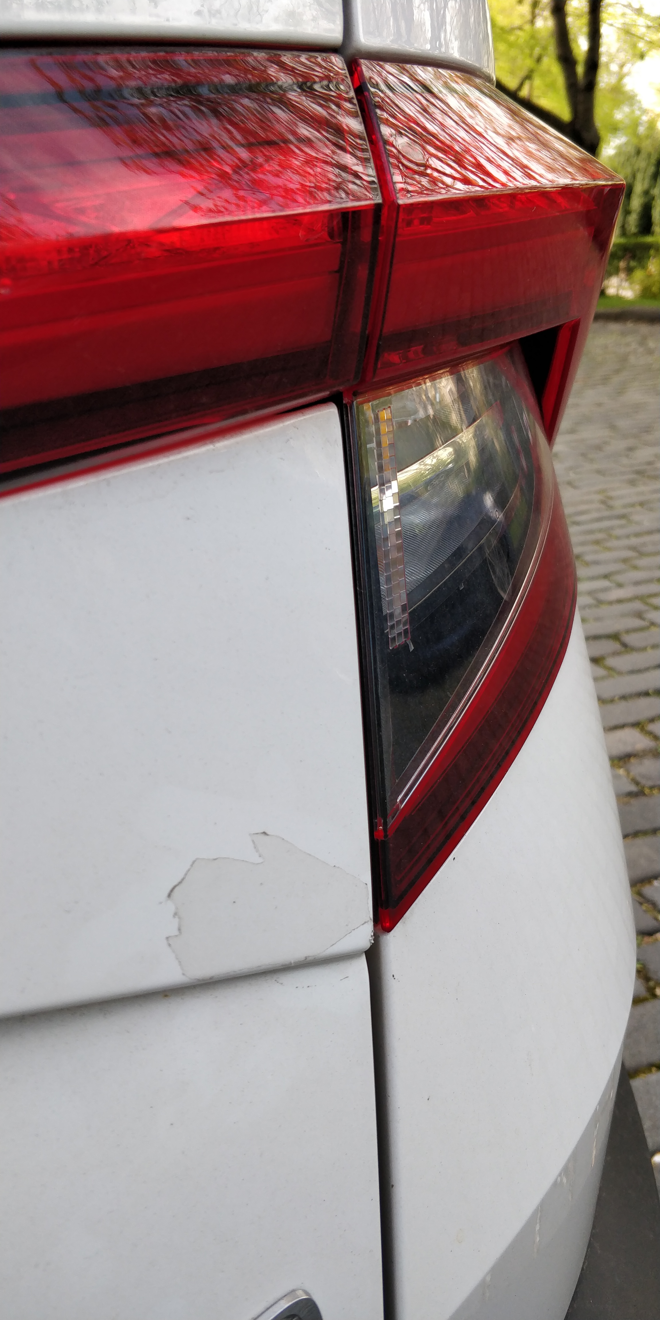

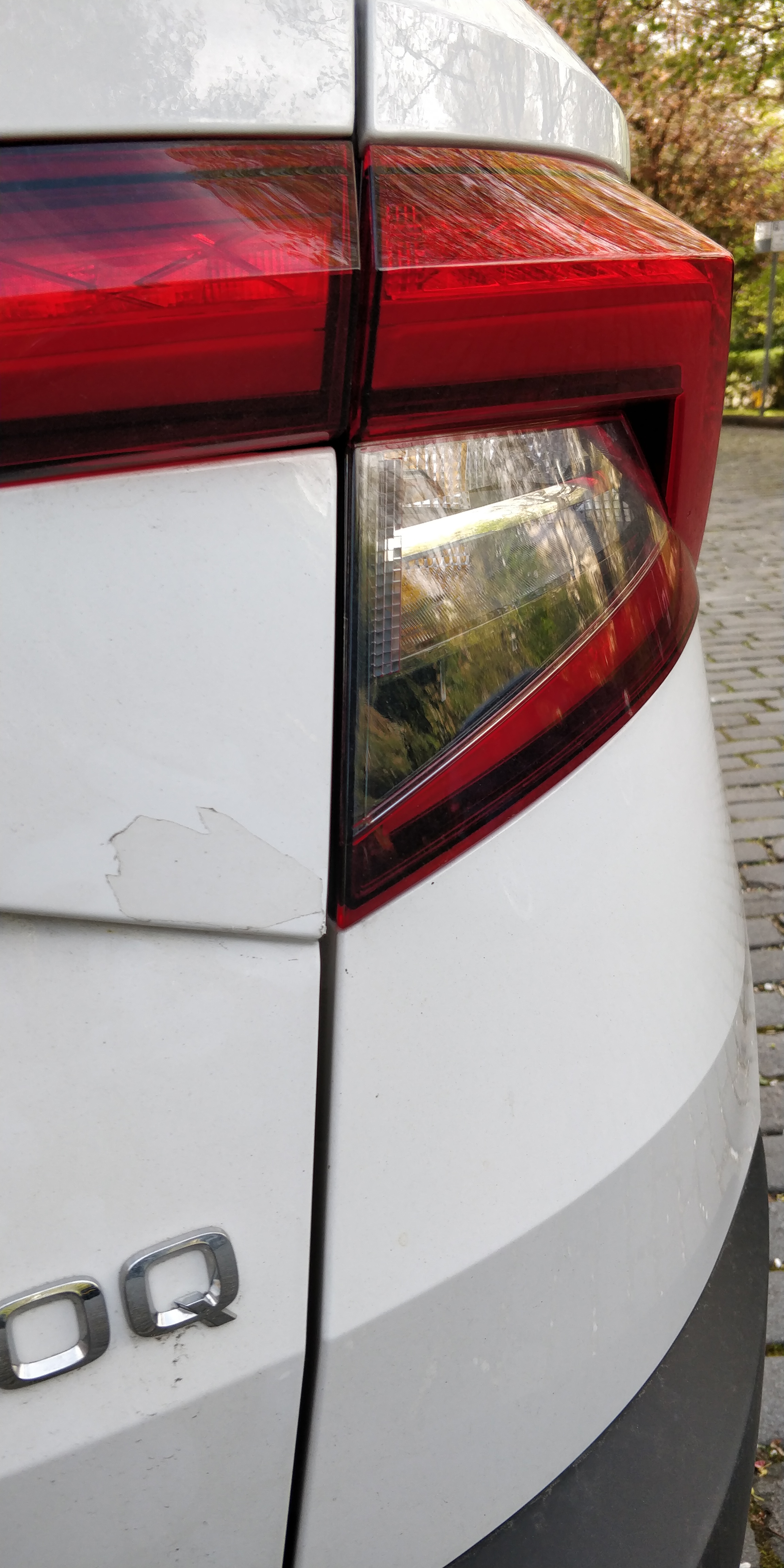

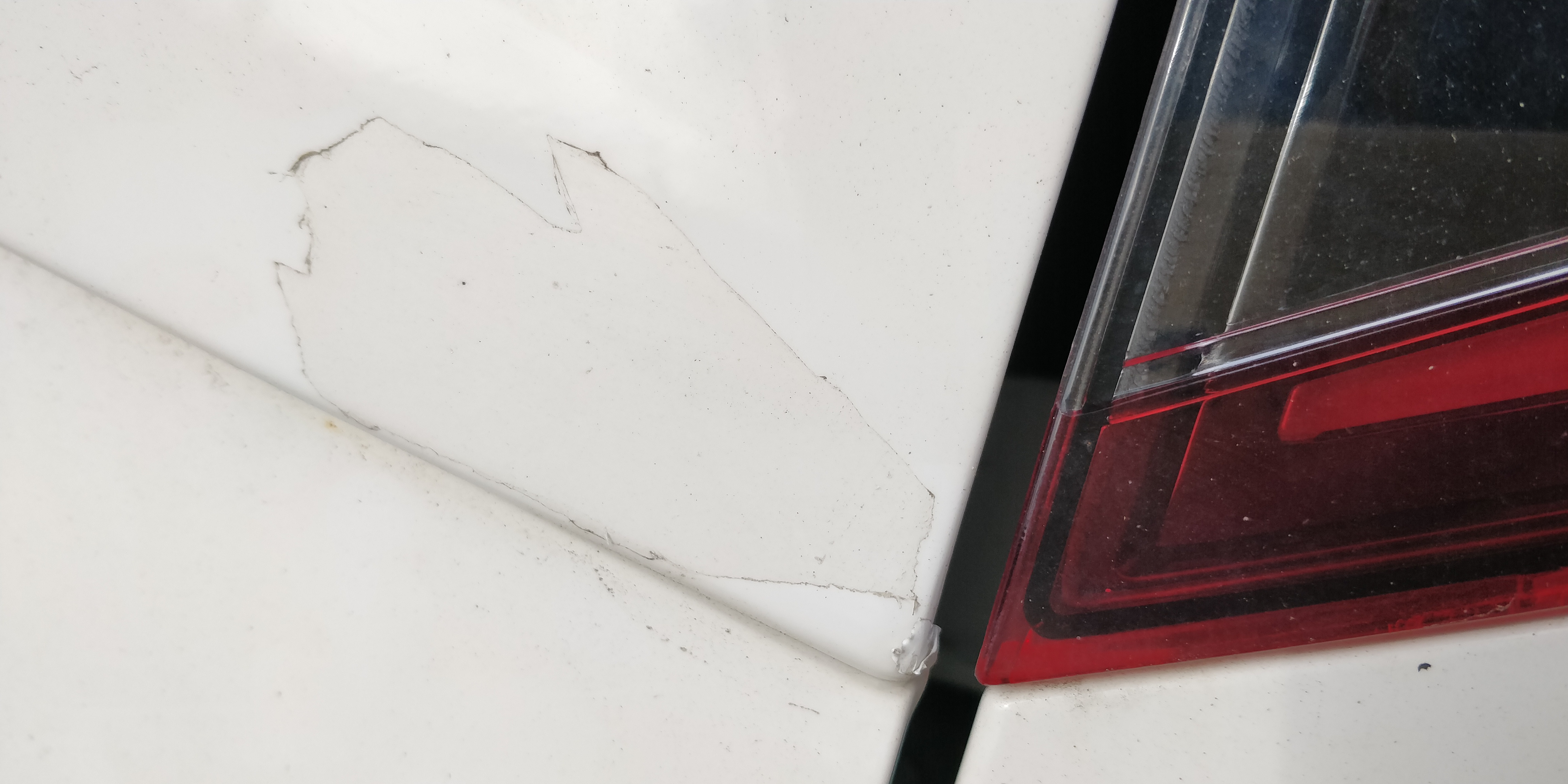

I've just spotted that a layer of paint has peeled off on the back boot door.
Absolutely no chance it's a scrape...
Check out the photos.
Anyone spotted similar issues?
I'm arranging a warranty inspection with a local Skoda garage.
Hopefully this will get resolved, but it's rather disappointing...

I think its protection tape !
I was going to say that!
Hope thats what it is.
Not long after we got our last Yeti I went so far as getting a quote from Chips Away for what I thought was a scrape right in the crease line on the boot lid.
Before they turned up, I peeled it off. Paint perfect underneath.
Errant sliver of the delivery vinyl wrap :blush
If it is tape the dealer gets 0 out of 10 for their PDI procedures.
I would certainly hope it is just some of the protection tape.

OP, it looks (as said) like a poor PDI by the supplying dealer. Personally I'd take it back in and (ignorantly) have them remove the film, then ask if there might be anything else they missed when they were preparing it for initial sale. Too much time on my hands though, so you could always do it yourself.  :D
