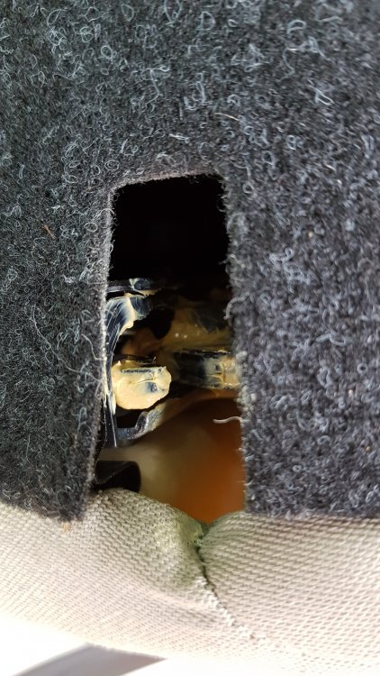

Rattle/vibration identification
Why are the fuel lines inside the car, or are under that area, but transmitting vibrations?
The fuel lines run through the chassis underneath but the subsequent vibration could be heard up through the door.

Morning BenSH,
I have checked the invoice which states 'Confirmed fault on inspection. Removed O/S under trim of vehicle to find fuel lines touching the body of the car and vibrating. Supplied and fitted new modified pipes. Tested all ok'.
Unfortunately, there is no part reference.  The dealer I used was Startin Skoda in Powick, Worcester who can be contacted on 01905 830361. To be fair they identified the source of the vibration very quickly although it took another couple of months to get the modified part shipped over, which they tell me is a rubber coated fuel line.
If your dealer rings them and they need to refresh their memory, the job number on my invoice is 68524 with W.I.P. No. 53802 (whatever that is).
I can confirm that the irritating vibration has gone.
Regards, Mark.

Update, for others info. They had it in and it IS the fuel pipes vibration as suspected on here. A possible fix was done and seem to be working) but they wanted to get Skoda to confirm the finsl fix but they had not done so in the time the car was in. Been a week since then and I have asked for an update.
Just to complete this thread with final status (hopefully)
The fix is still working, and Skoda tech said they had not had this issue before and the fix done by garage was approved, so did not have to go back. I am assuming that my car did not have the same issue as others )I think the fuel lines were already 'rubber' covered correctly but is similar as it was the fuel lines causing the issue.
Fingers crossed the fix is good enough, but see no reason to doubt it currently.

Hi All,
I had exactly the same issue on My Superb M3 L&K Petrol (reg. Jul 2018).
The dealer found that the fuel lines had crossed causing the vibration at about 2200 revs (car either stationery or in motion).
They probably got dislodges after hitting a large bump/pot hole on the road.
They put some sponges around the fuel lines and this fixed the problem.
