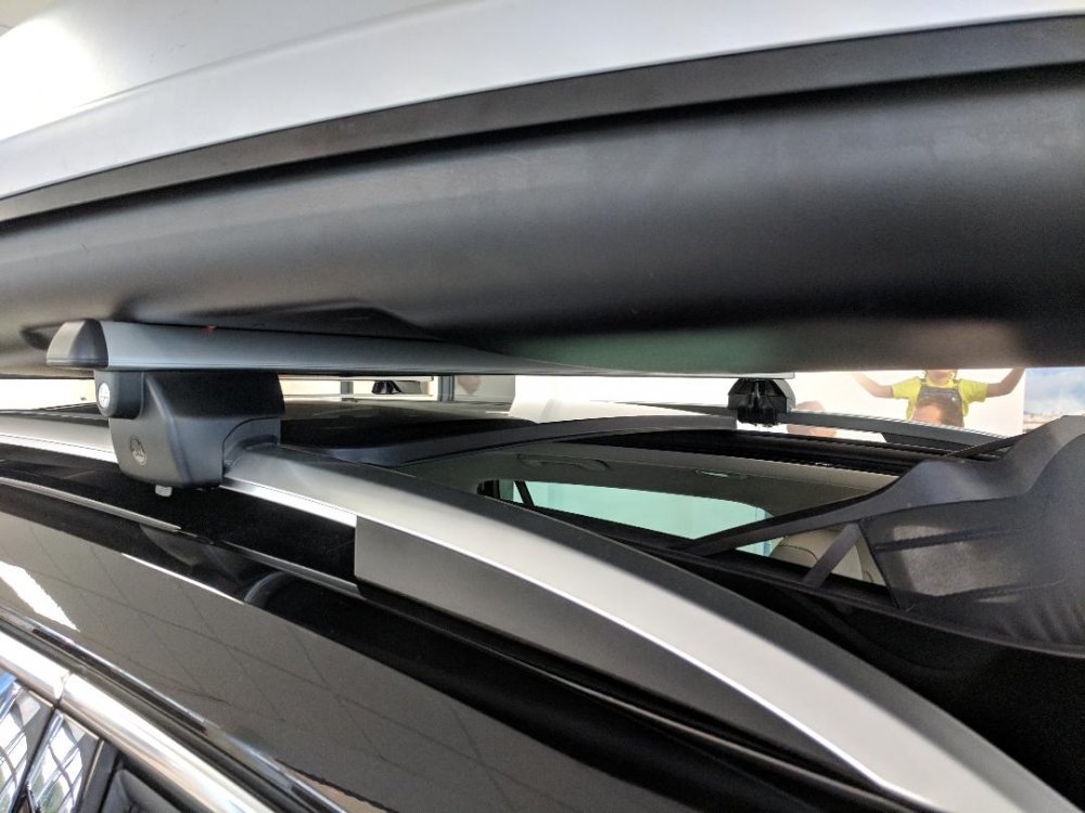

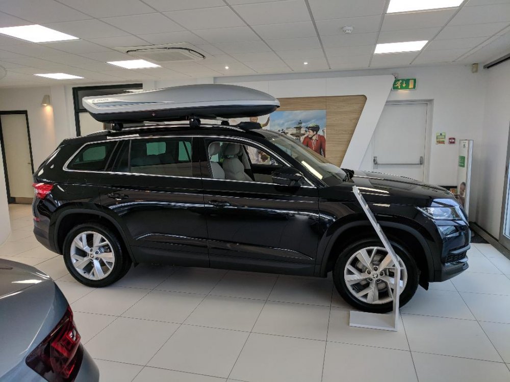

Just seen a set on a Kodiaq in the showroom. The sunroof doesn't go much higher than the tops of the bars, so looks like plenty of clearance. I think this is the 'official' skoda bar/box combo.

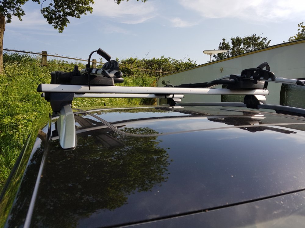

First time away for us this weekend with the genuine Skoda roof bars, and two Thule cycle racks attached. The roof has plenty of room to open. No trouble at all.
