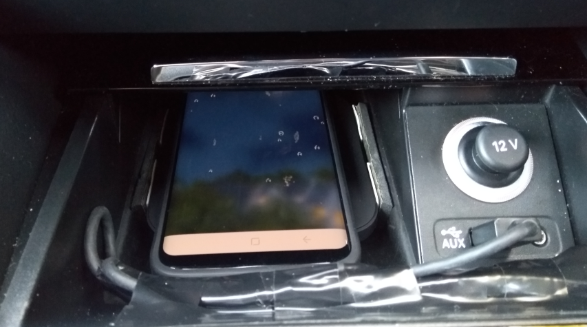

Photos attached. The cable is really untidy but the cover slides closed without hitting it and it works fine.  When I get time, I'll locate a better USB cable and/or rewire to improve the look.
Do yourself a favour and buy a 10 or 20 cm MicroUSB cable, you can eve get them with right-angled USB plugs. Should only be a couple of quid at most.
The cable does look ugly so I've just ordered a couple of really short ones to try out.  If it works out as expected, I'll update the photos and link to the correct cable.
Hers mine with the smaller Anker Charger. Apologies for the mitt prints, she needs a good clean !
A 15cm Right angle Micro to Left angle USB cable does the trick if you keep the plug on the right hand side, if you want it at the rear you would need a 20cm cable.
Added 2x 10cm square by 6mm thick neoprene foam pads under the charging pad to give the phone clearance, and a couple of pieces at the side so the phone stays within the charging area when cornering or covering bumpy roads :blush:
I just hope I don't have a flat battery when I next take the car !
Edited by Mr Grump
@Mr Grump - nice. Does the lid close when the phone is removed?
Yes lid closes with phone in or out. (Samsung S9). That's with the USB plug left in or out.
