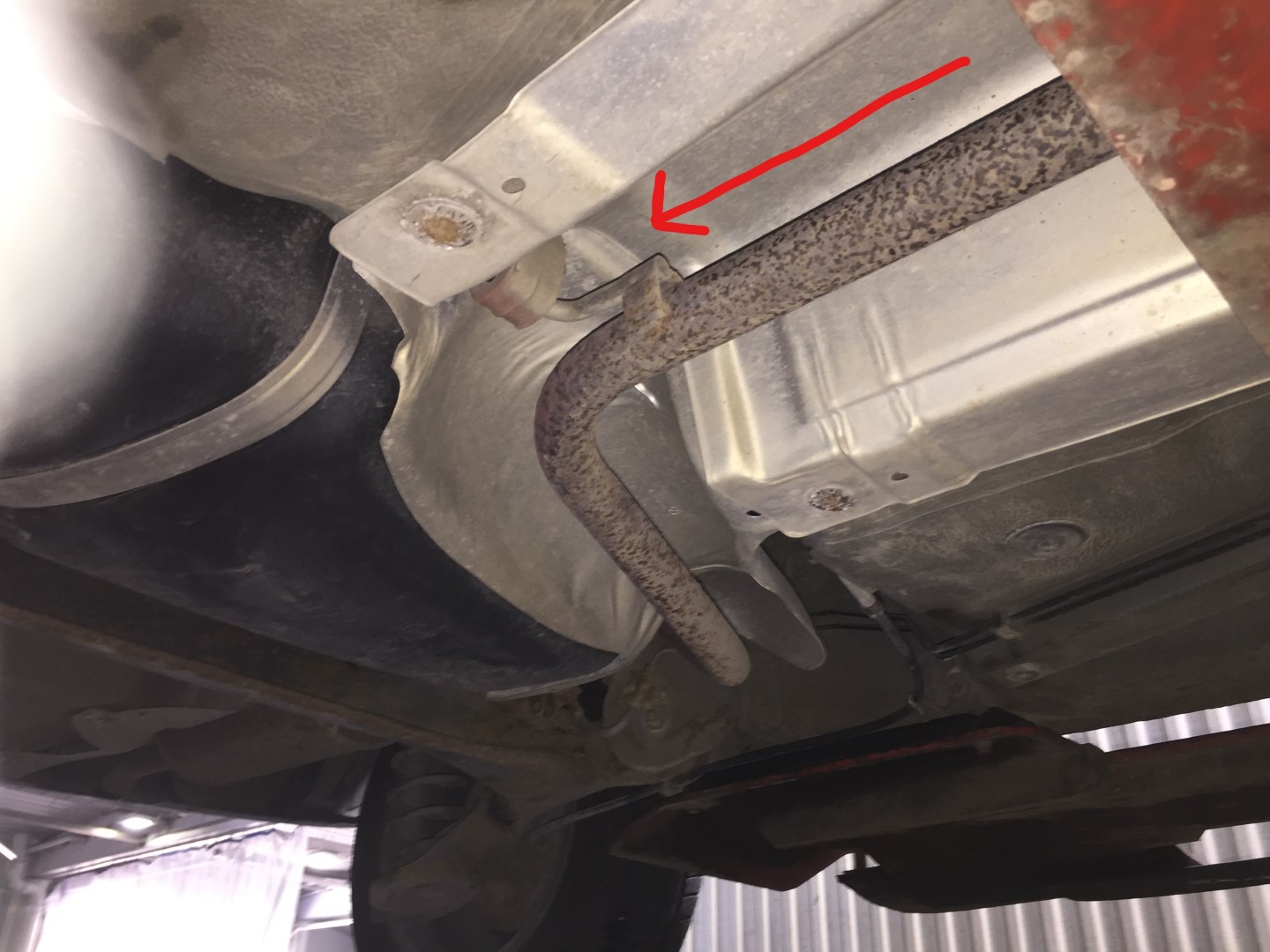

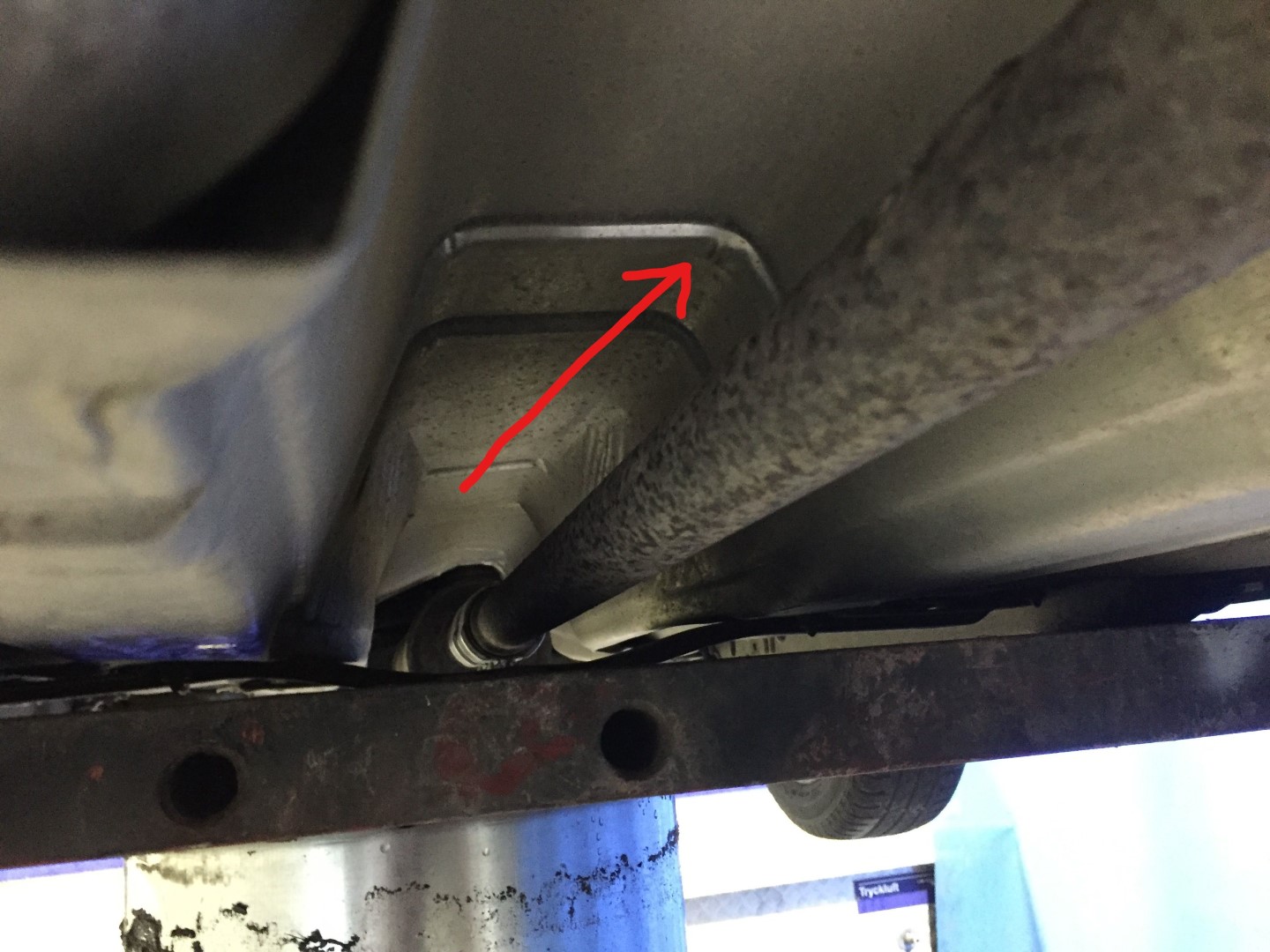

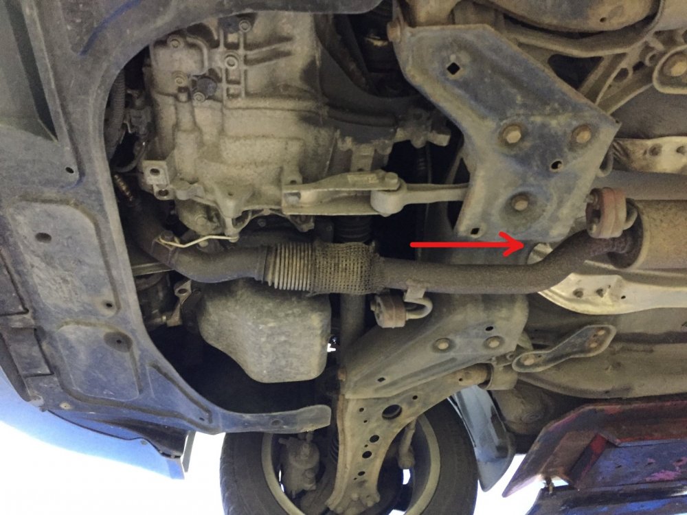

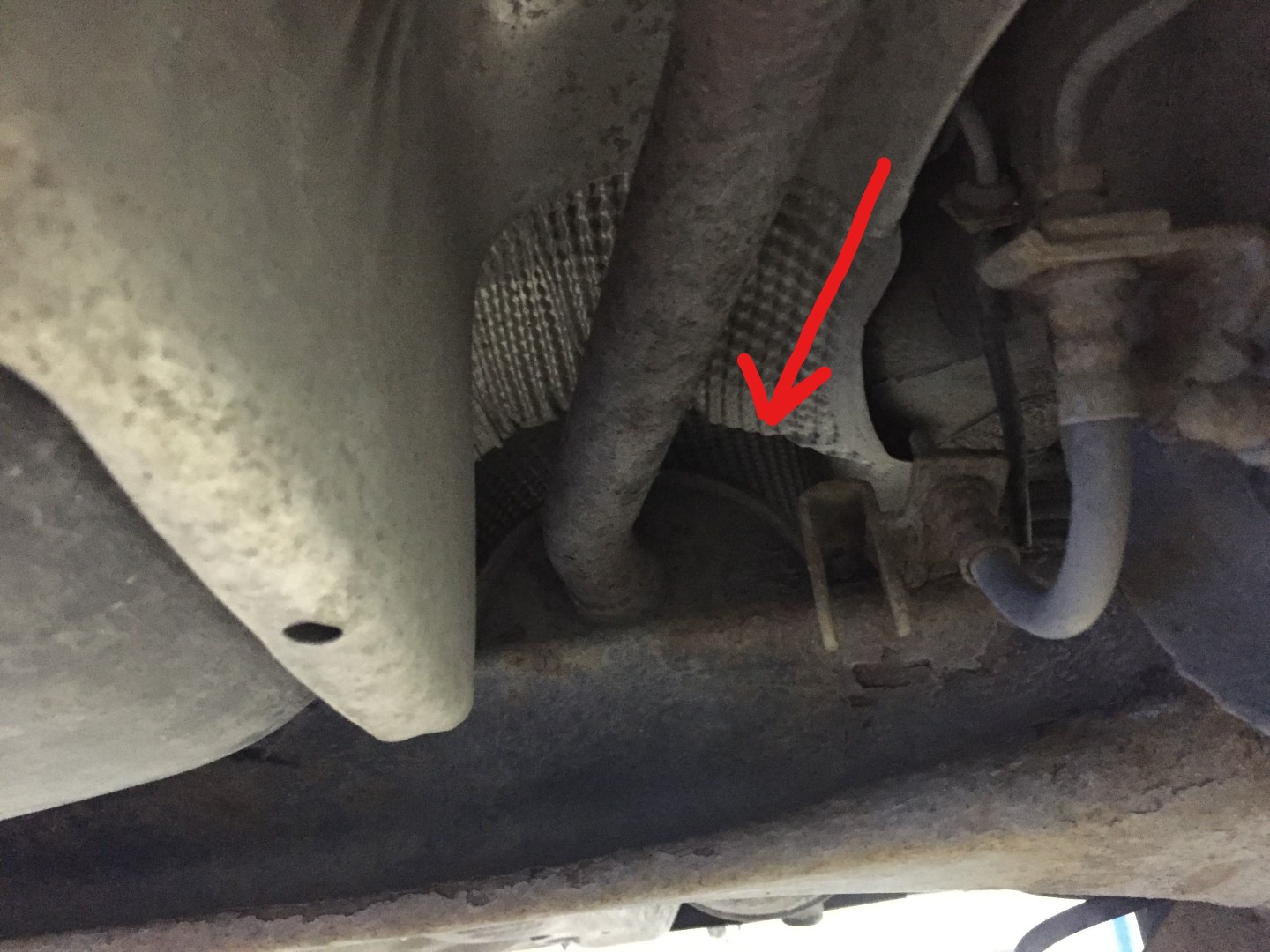

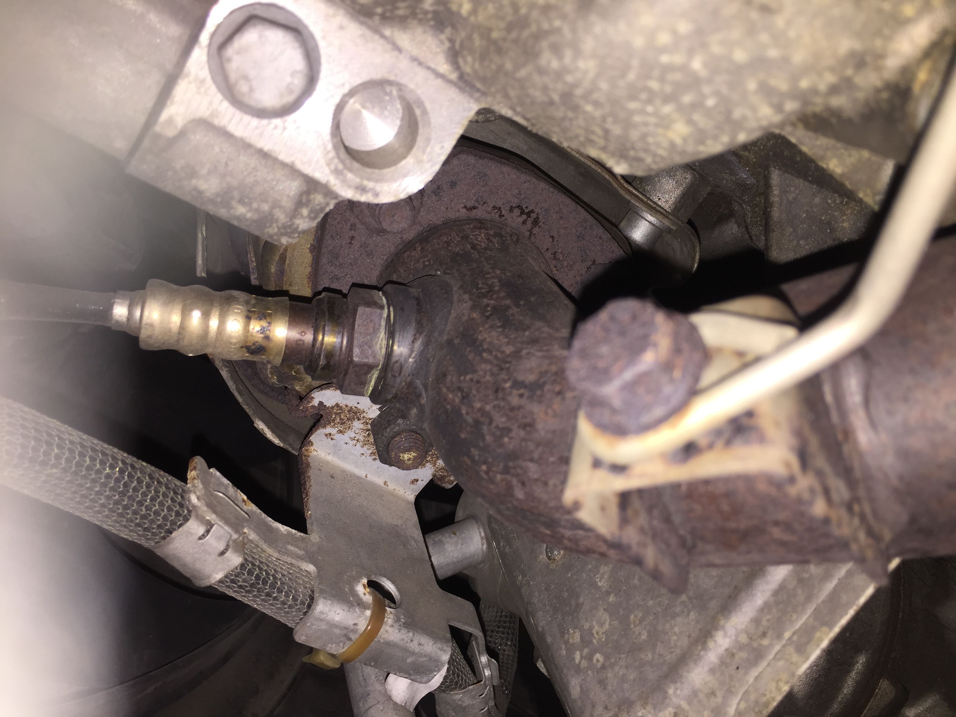

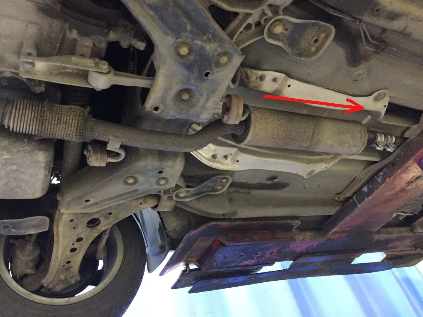

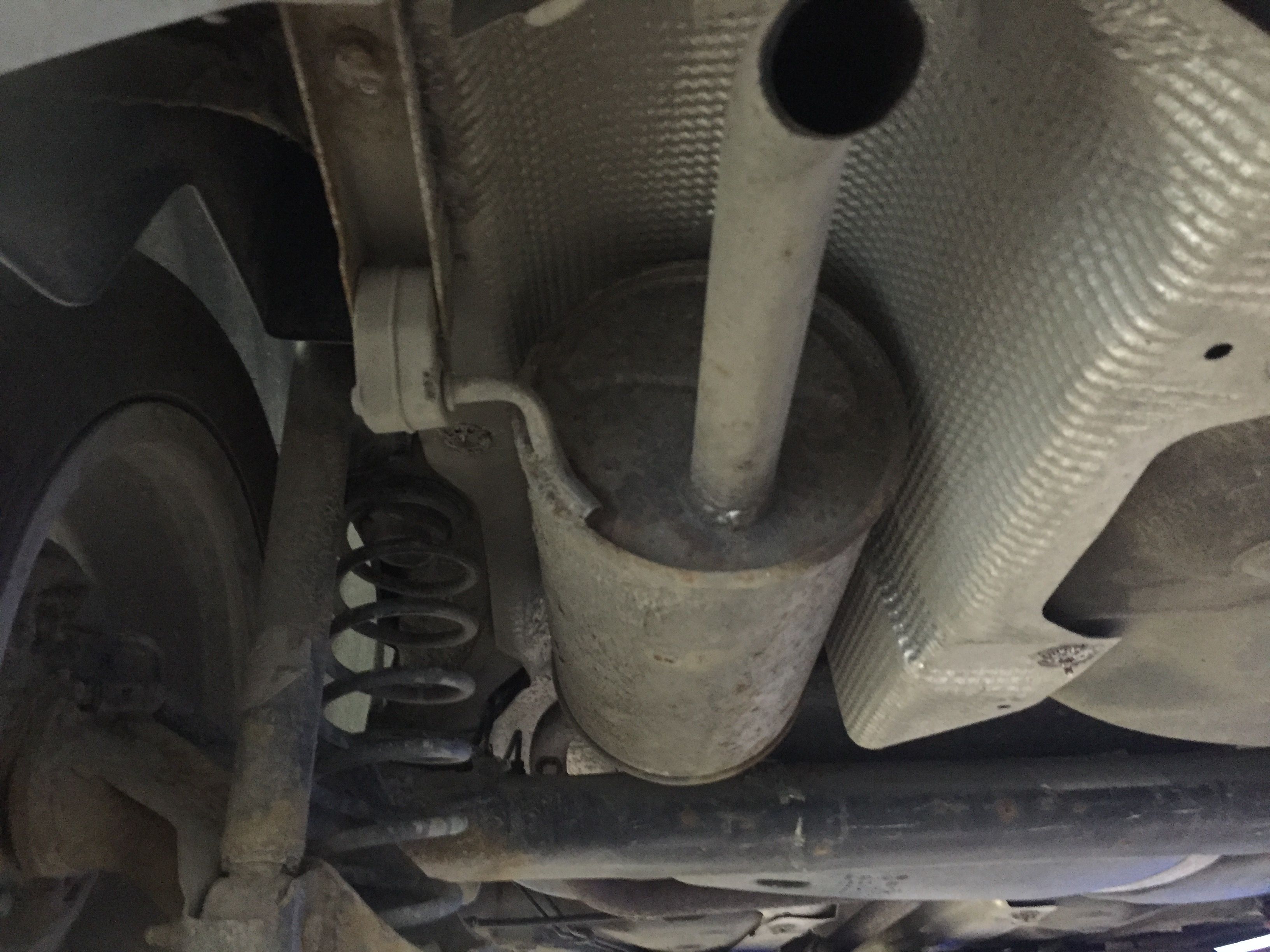

I have a Fabia where I need to change the exhaust. But before I buy I have a hard time figuring out what articles to buy. I have taken som pictures under the car.
I was thinking of replacing the whole system while I am at it. But what is really broken is the flex tube. And I want to buy new parts instead of welding just the flex tube.
As you can see in the pictures I have one muffler on the front pipe. Then there is a pipe that is attached to the rear muffler. So basically there is only two pieces.

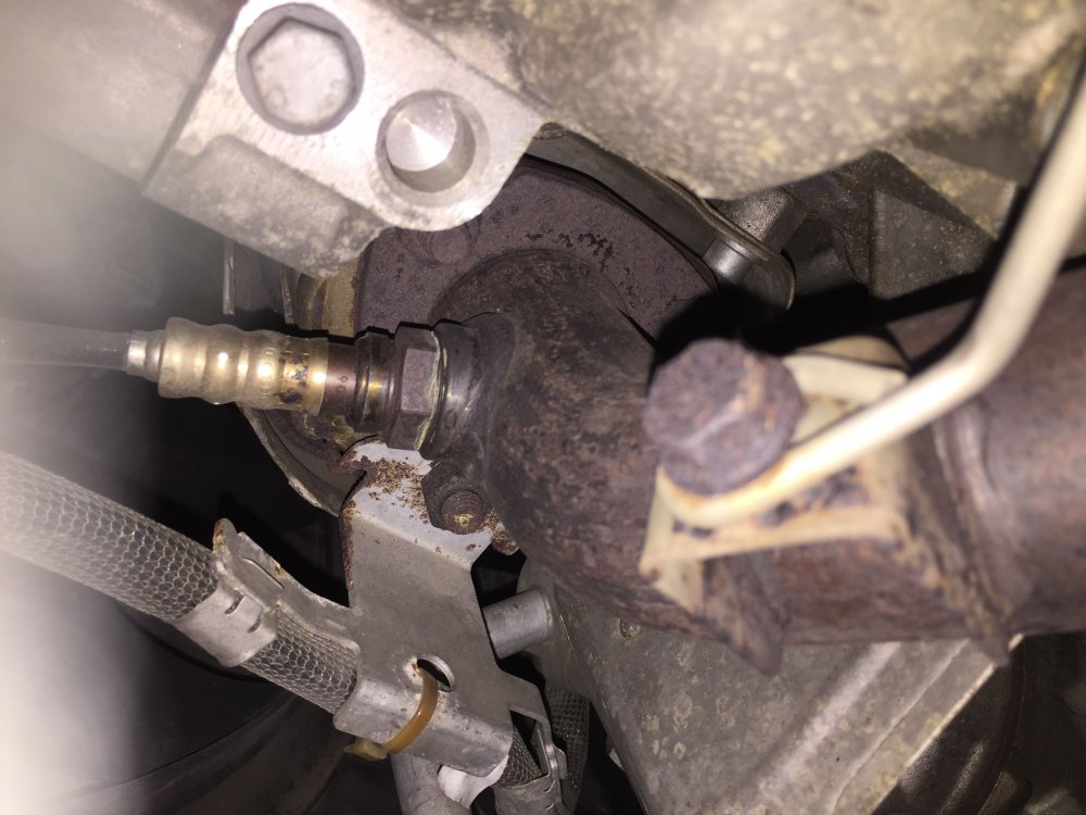

When looking around different sites I do not know what to get. There are front pipes with no muffler, or with small muffler. There is a third muffler in the middle that I do not have.
https://skoda.7zap.com/en/cz/fabia/fab/2007-453/2/253-253050/#3
Here it looks almost like the third option but that has no holes for lambda sensor and is square and not triangle in the beginning.

I think I need to get a front pipe with muffler and holes for lambda sensor and then a middle pipe and the rear muffler.
But I am unsure of the part numbers to buy.

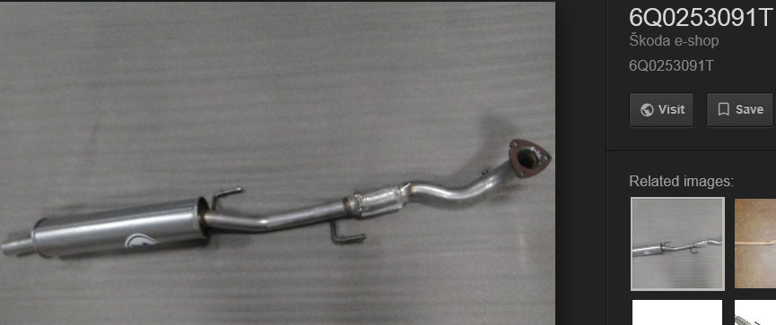

6Q0253091T is the part number you want for the front pipe, as far as I can see.  None of the ETKA pictures quite show it correctly, but the info relating to chassis numbers and engine code fits with your car.
An image from ebay.de reassures me that it's the right one: https://www.ebay.de/itm/BOSAL-Vorschalldampfer-Vorne-281-769/202061666664?hash=item2f0bd05968:g:P8kAAOSwtTJZxAE
An actual photo here, even though you can't see the lambda boss from this angle.
