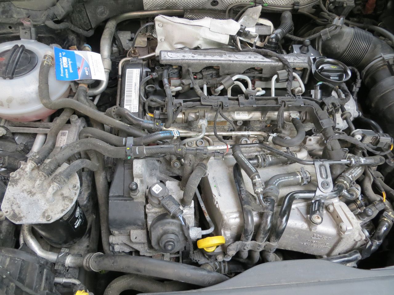

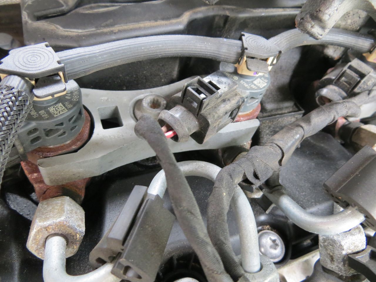

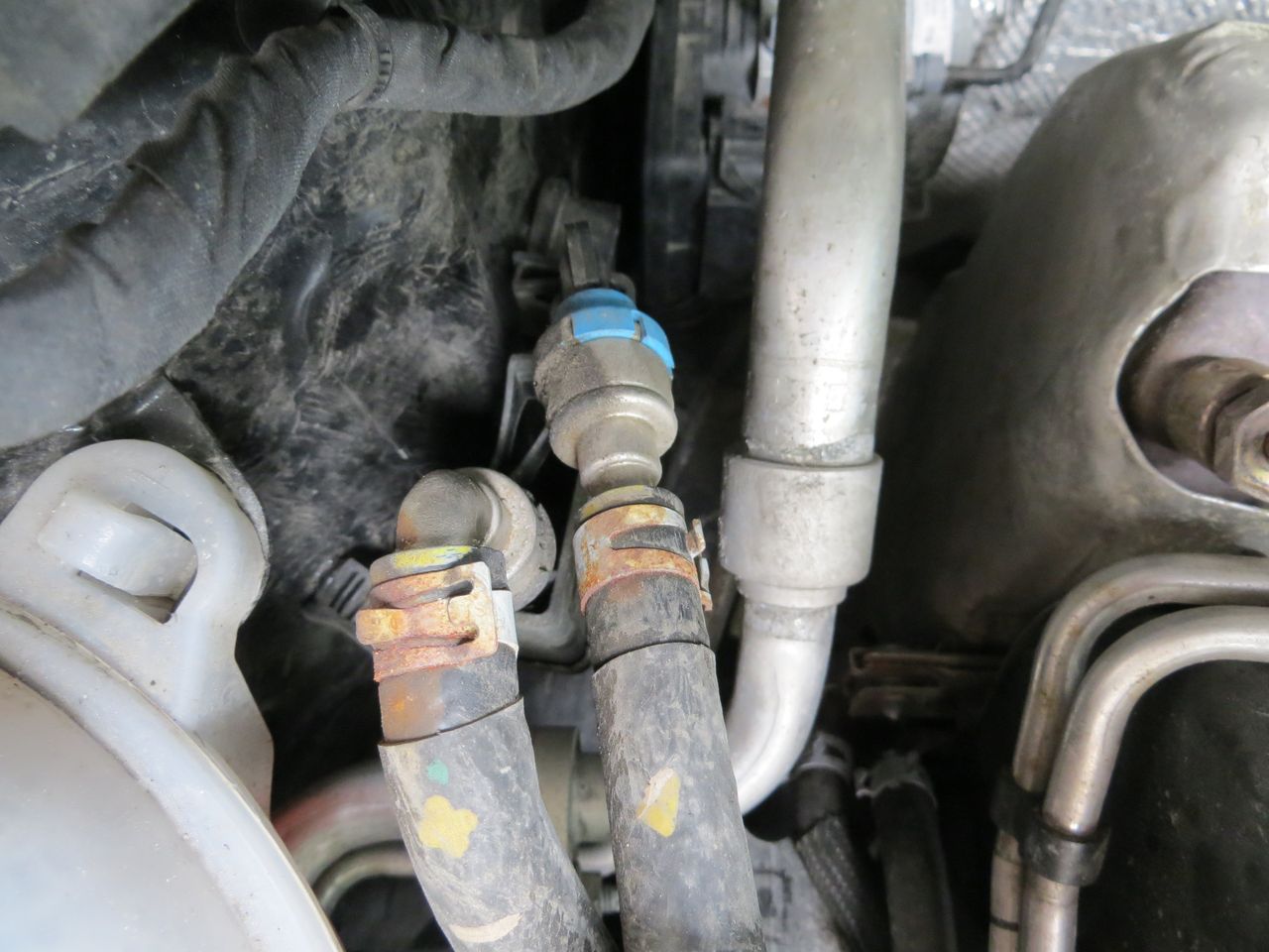

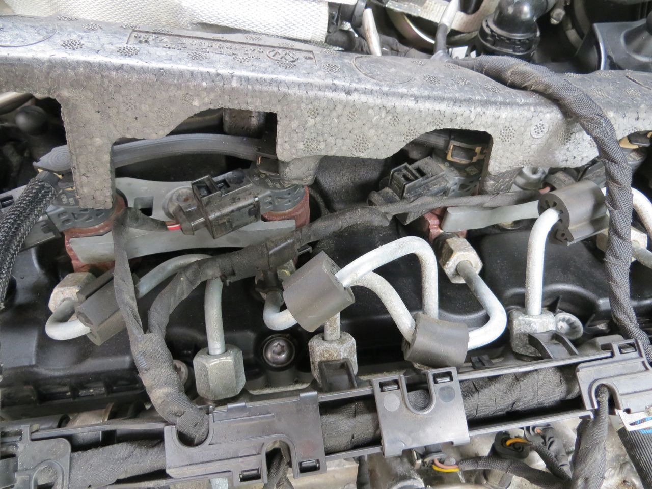

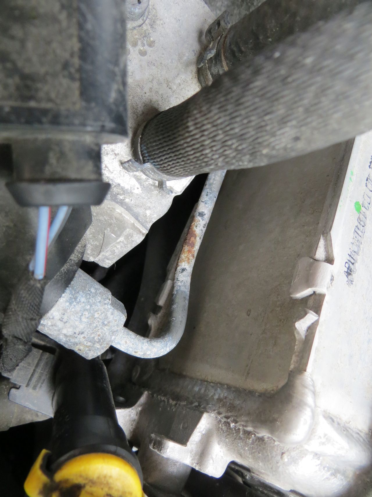

Last weekend I tried to clean the engine with compressed air, because it was full of white spots, like corrosion, I believe from the chemicals used on the roads in winter, but I had the surprise to discover some places with rust, and most worries me that I found at the injectors.
It is normal? If isn't, what can I do?
Here are some pictures.

Most injector housings I've seen look like that after a few winters.
I recommend you degrease it and clean it best you can then spray it over with ACF-50 to protect it.  You can spray it over everything, electric, hoses etc etc.  It's used for boats/planes that are used at sea, I use it on my motorbike and it inhibits corrosion and stops the salt ruining your bike.

Is this not just regular surface rust..?
The white spots on alloy material is normal. It's actually a normal property of alloy material to lay down a fluffy deposit to protect itself. As for other rust, at least it means you don't have any oil leaks. :D
