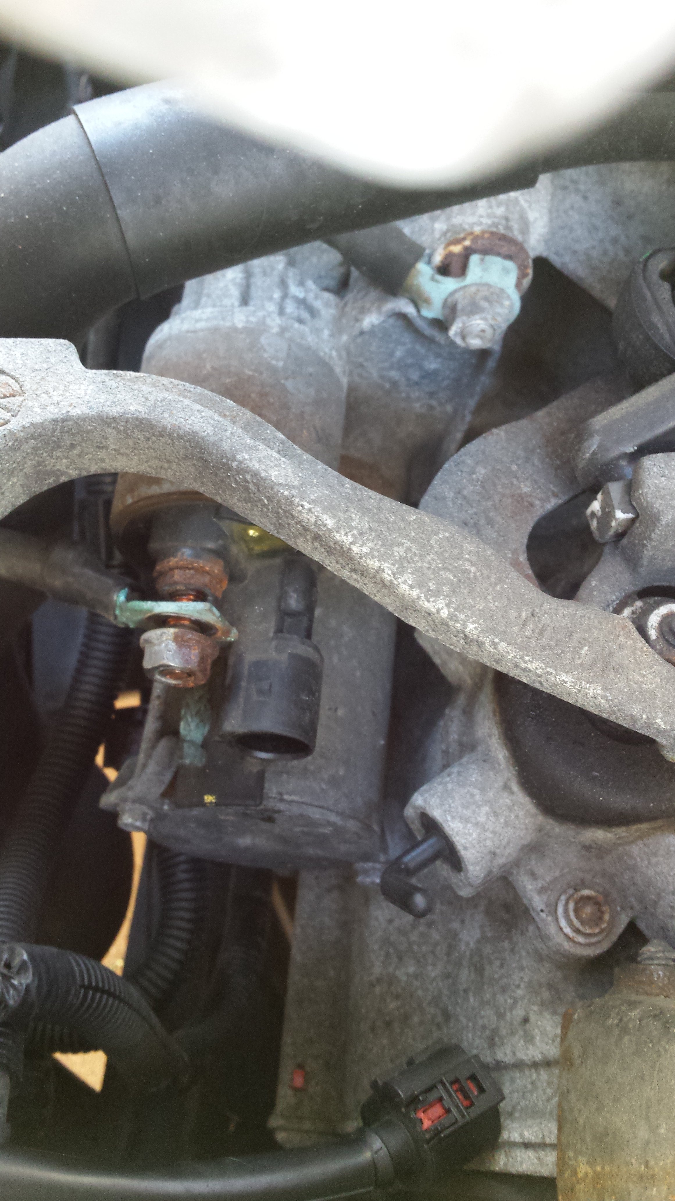

This is the one which seems to be grounded somewhere (this is before I fitted a new motor and cleaned up the corrosion BTW! )

You may just be measuring continuity through the battery.
Can't be shorting, your car would have caught fire or your battery would be dead flat.
Nope. The battery is removed. I have even disconnected the other end from the plastic battery cover so I have both ends not connected to anything. Still gives continuity between the cable and engine block.
