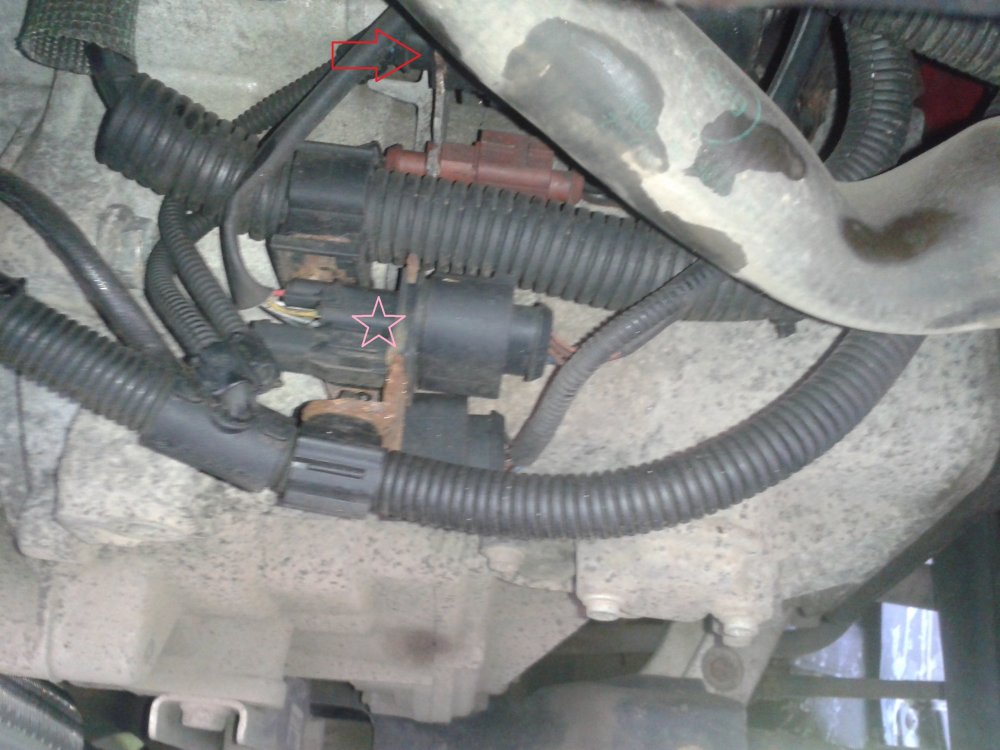

Well more issues found. I thought I would remove the lower engine splash cover to locate the actual load signal wire and found coolant to be leaking from underneath. The dreading radiator leak :( Had exact same issue in my old Polo GTI 9n3 years ago. Radiator was leaking and they had to change the radiator but that was done within warranty. I hope the replacement wont be expensive :(
Anyways looked a bit further to find the load signal wire and this was the sensor that was butchered which looks like goes
into the gearbox. I also looked around and couldn't see any broken wires etc? Could it be that this sensor is a gonner?

That's your reverse light sensor, another common spot for wire breakage, looks to have been repaired robustly.
In the third photo you can just see the brown connector pair for the aircon N280 valve. Load signal connector pair is on the same bracket (top connector on the 1.2, if it's like ours).
Looks like a slight leak on the differential drive flange seal, ignore for now if it passes MOT. Bit of a faff to swap seal, but that is the easier side if you need to.
For the coolant leak, check that isn't coming from the radiator thermoswitch, rather than the radiator structure. Much cheaper (free) fix by just tightening the thermoswitch a tad. I suspect a lot of radiators are unnecessarily scrapped because of failure to spot this.

Here is another picture i took yesterday. So as per your last reply the connector is the one circled in yellow with an arrow? I didn't notice any breaks on that connector. Should i trace the wire and see any breakages?
Also one thing to note am not getting any ABS light coming on as the usual symptom which comes up after 10 mins of drive?
Yeah, I think so. Blue and brown wires coming from the alternator two-way connector to one half of the connector pair, blue and green/purple coming out of the mating half.
TBH, I wouldn't worry too much about the (18265) load signal error that the ABS is referencing (the 01314)  across to the engine ECU, I presume you have no warning lights on? Not convinced the DFM/load signal is used for much on the petrol Fabias.  Does the battery light come on with ignition? If so, the blue wire is intact, and that one is more important.
