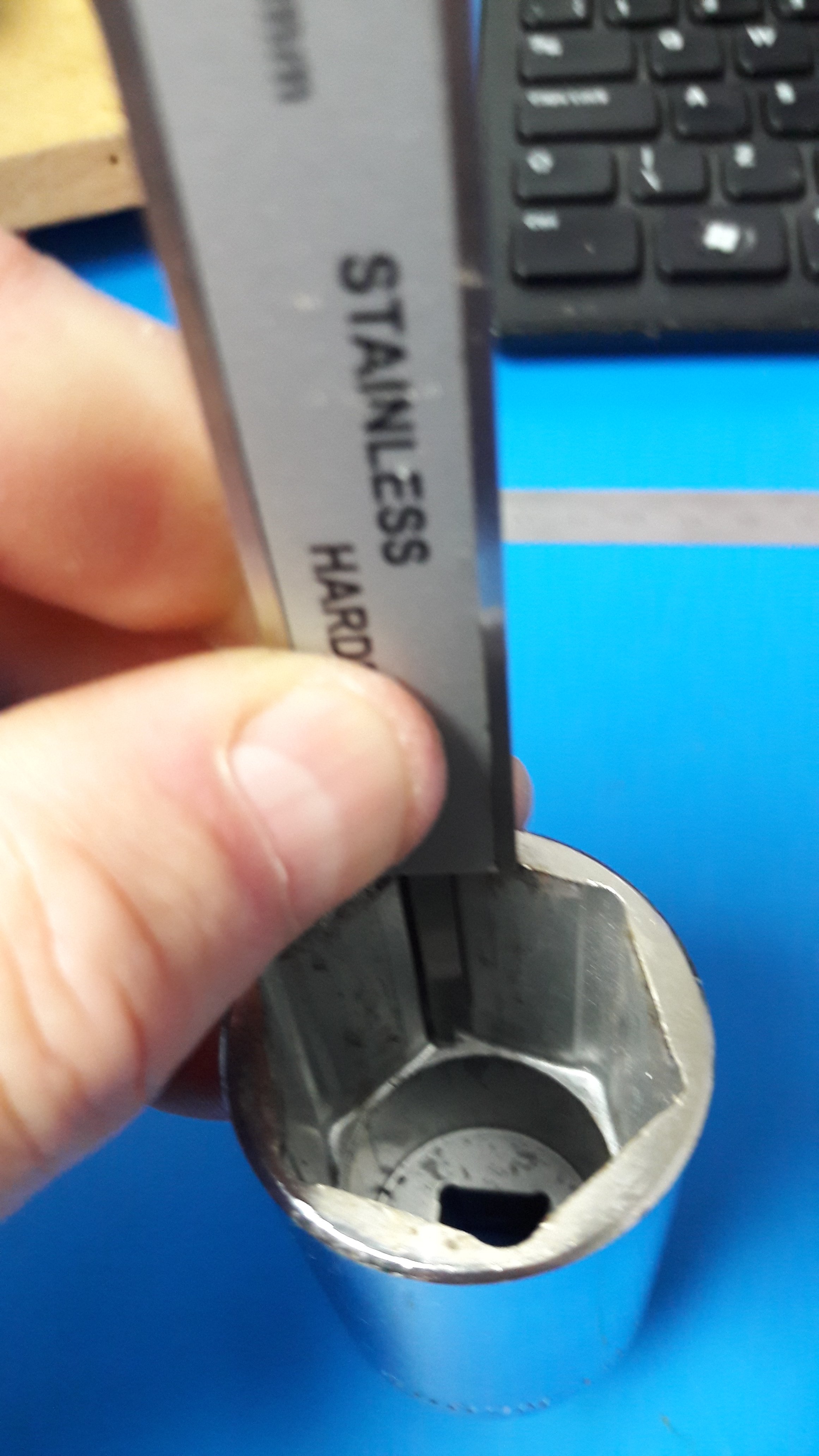

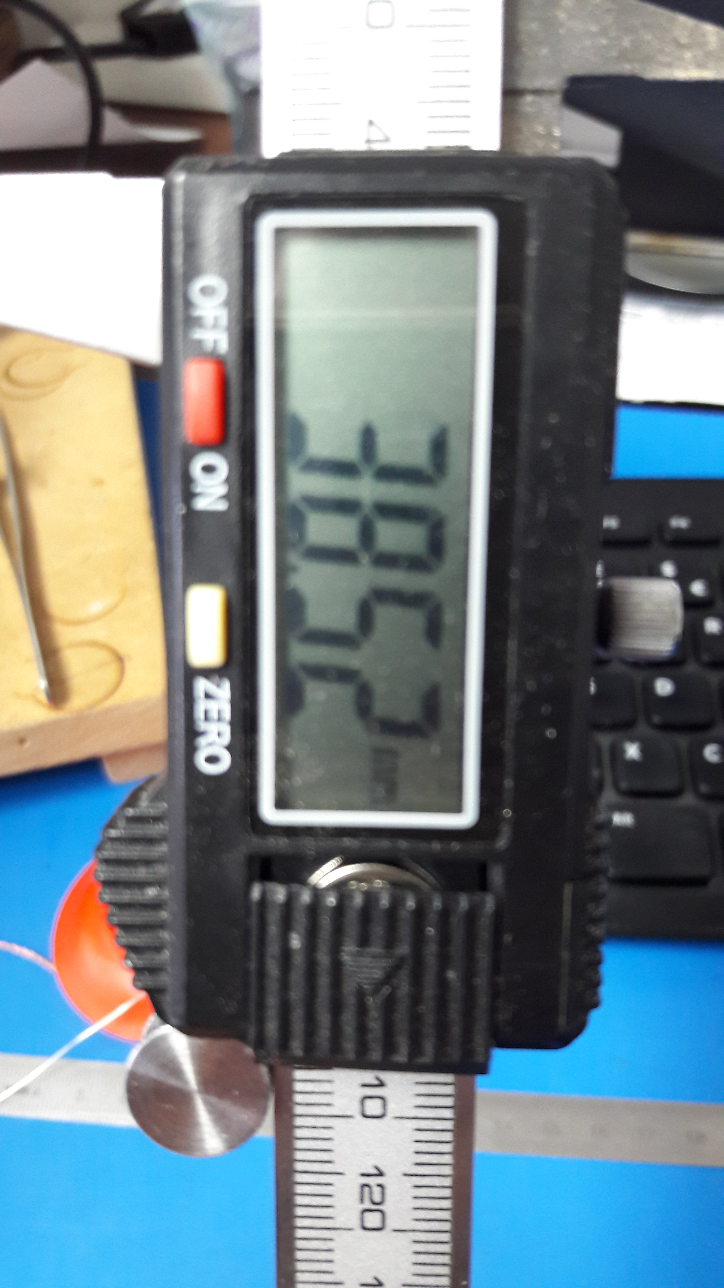

That 29mm socket is more likely to be 1 1/8" because it's for a plumbing type fitting so you might find it easier to get one of those or even use a box spanner if there's room, that size is very common at plumbers merchants.
