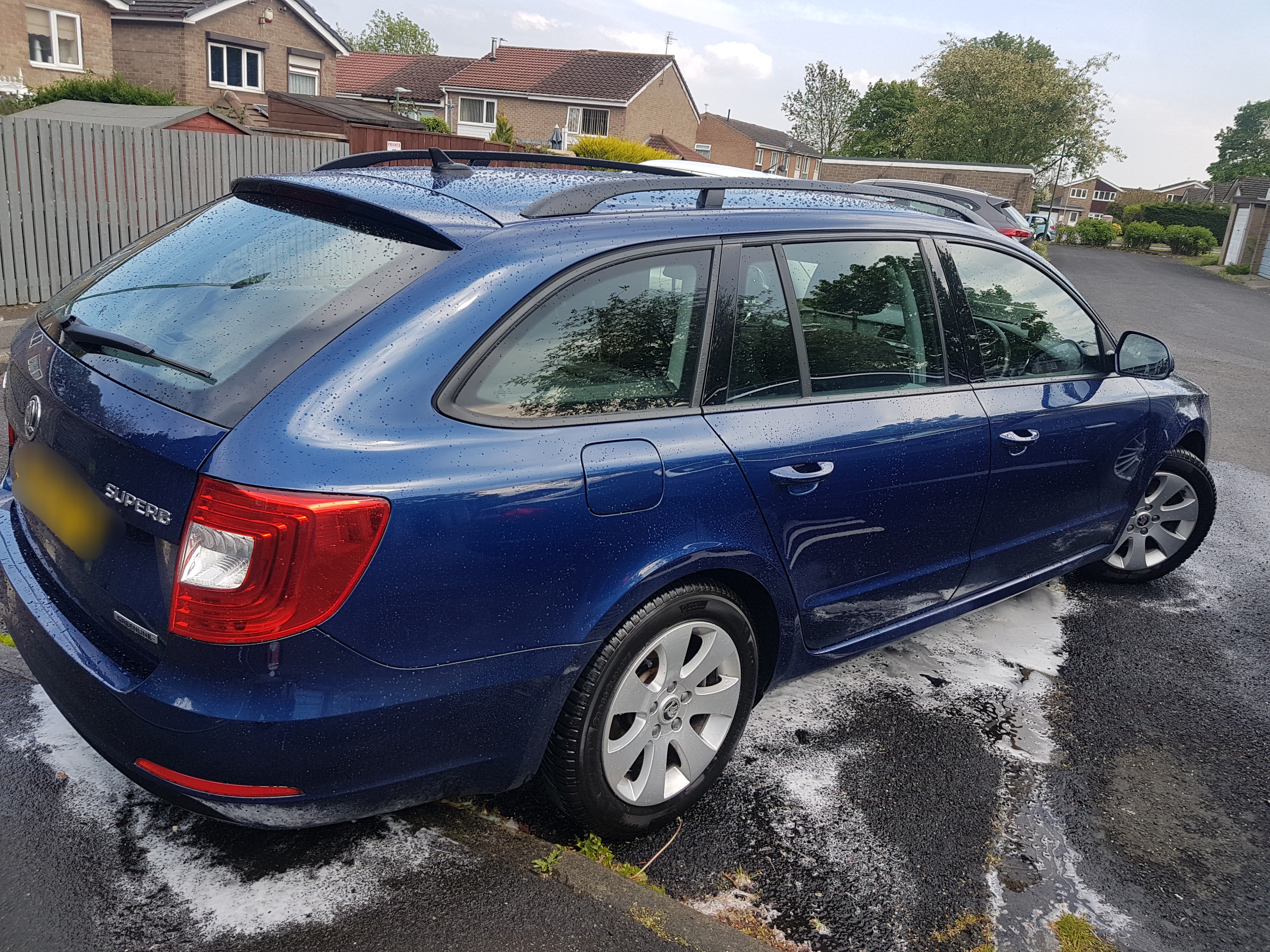

16's don't look as daft as they probably should on the mk2. I'm happy with the look.
That's cheating!! The Greenline sits lower and is therefore better places to pull off the 16's. ;)
Looks good on those rims B) they look to have more 'poke' than 'standard' what's the ET?
Thank you sir. I suppose it is cheating a bit! I've no idea on the ET to be honest... 47 rings a bell.
