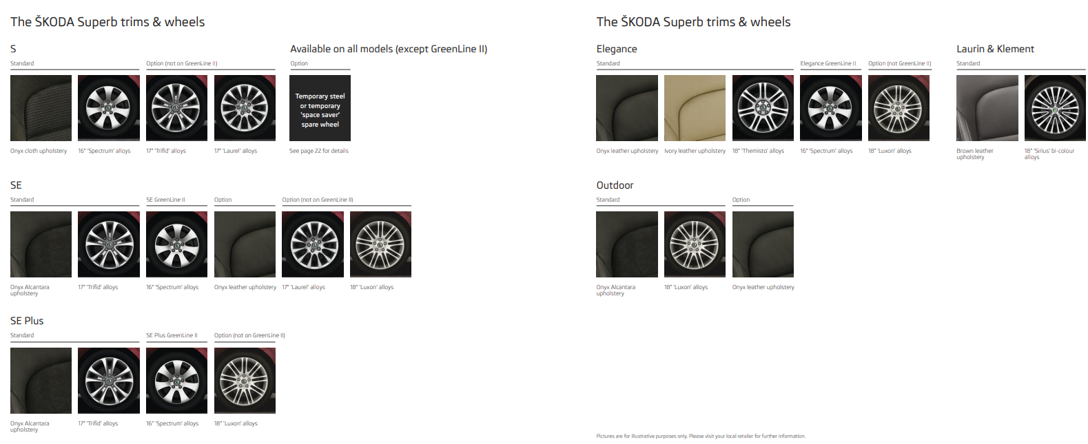

Here is what was available new in 2010. May be different for different markets.

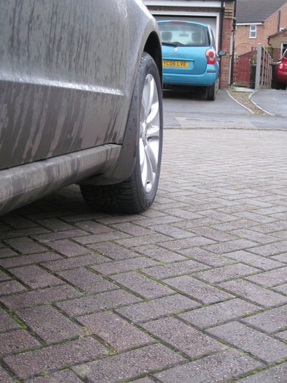

I have plain 16" steel rims bought from skoda Bickerton if memory serves, they fitted the tyres and sent the lot out.
I have had various trims , nothing looks as good as the alloys but that's the price uyou pay.
there again how good does an alloy look after dropping in a pot hole full of rubble.

I have them on mine and you are not wrong, but it is a price I'm quite happy to pay for not having to dodge around every road imperfection.
They are not the nicest 16s and I have thought of looking for some better ones or possibly trying some 17s but I didn't buy this car to spend money on unnecessarily.

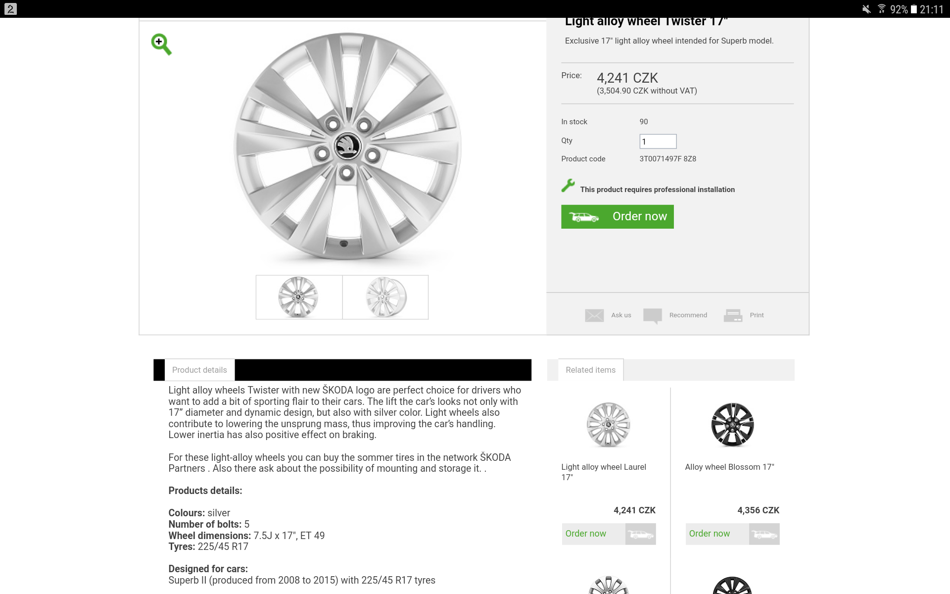

That's interesting - didn't realise there was a 225/45.. Doesn't it make the tyre/wheel combo too tall though ? ( I know it's only a few mm but still)....
Its not the most popular tyre size but yes, it does exist alright.Might have to order as opposed to having them off the shelf.  Clearance was fine and it actually made it look better IMO, definitely not too tall.  I went through three sets of 225/45s and apart from a very minor difference on the speedo reading, I never had any issues with them.  It's just about as much as you can push it though.

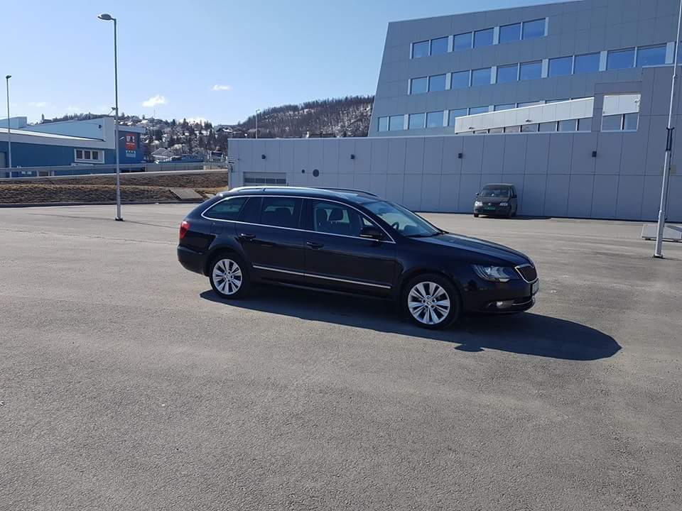

Her is mine with 17".
Miss the look i had with bigger alloys. But the ride is much better now.

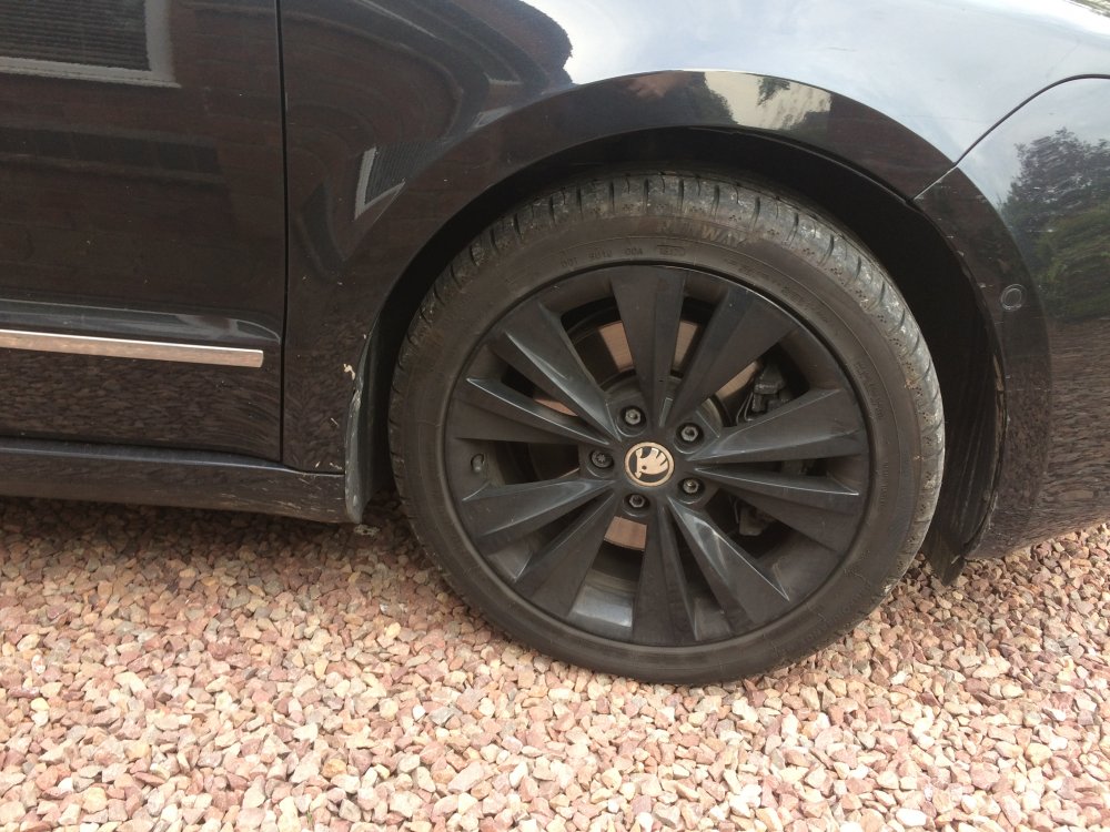

I run 18"s and suffered with a significant pothole incident earlier this year, resulting in welding as below. :crying:
These ones will become my winters and I'll fit some refurbished Themistos for summers B)

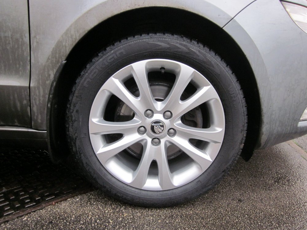

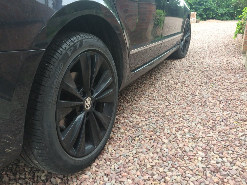

I went for the best of both worlds.
17" for aesthetics and 225/50 for pothole resistance.
Still plenty of wheel on show but with higher profile tyres to fill the arches and better able to cope with our poor roads.
Sure, they're not an approved size (at least on the Superb, they are on the Passat and A4) but the scaremongering about insurance is just that.
The car rides lovely, tyres prices are reasonable, they look quite smart and I no longer drive down unlit roads with my buttocks clenched.

Those wheels look good, what are they called?
Thanks
