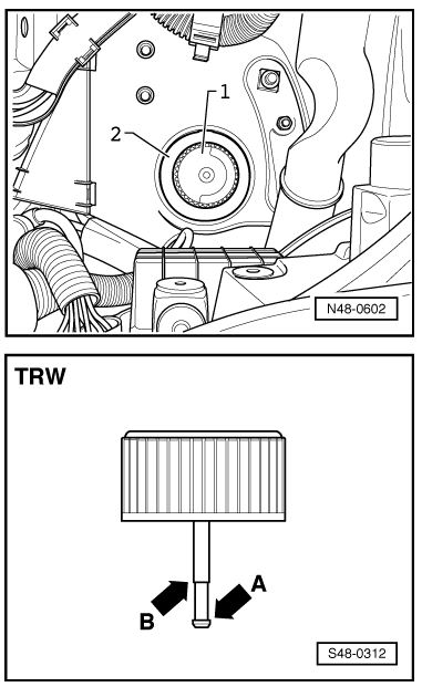

https://workshop-manuals.com/skoda/fabia-mk2/chassis/steering/filling_and_bleeding_the_power_steering_system_trw_and_checking_tightness/filling_and_bleeding_the_power_steering_system/
Filling and bleeding the power steering system
Special tools and workshop equipment required
t  Vehicle diagnosis, measurement and information system -VAS-
t  Catch pan (commercially available)
t  Extraction bottle (commercially available)
t  Jumper cable (commercially available)
t  Hydraulic oil → Chapter
hinweis.gif  Note
t  Hydraulic oil amount in the system: approx. 0.80 ltr.
t  The screwed lid for filling the power steering system with hydraulic oil is located in a recess on the frame side rail in the left section of the engine compartment.
t  Because of the different dimensions of the battery the screw cap of the hydraulic oil reservoir on certain vehicle versions is concealed by the battery tray and battery. If this is the case remove the air filter, the battery and the battery tray.
t  Only fill up an empty hydraulic system when engine is cold.
t  Use new hydraulic oil only.
t  Topping up hydraulic oil → Chapter
t  Check the hydraulic oil level with the dipstick of the screwed lid of the engine pump aggregate reservoir.
t  Do not refer to the „MAX“ and „MIN“ markings on the reservoir to check the hydraulic oil level.
Method:
hinweis.gif  Note
t  If necessary remove air filter → Engine; Rep. gr.24 (petrol engines) or → Engine; Rep. gr.23(diesel engines).
t  Then if necessary, remove battery and battery tray → Electrical System; Rep. gr.27.
–  Fill the engine pump aggregate reservoir -2- with hydraulic oil and check the hydraulic oil level with the screwed lid dipstick -1-.
For checking the hydraulic oil level, screw the screwed lid hand-tight to the reservoir.
The correct oil level can only be determined for a fully screwed in screwed lid.

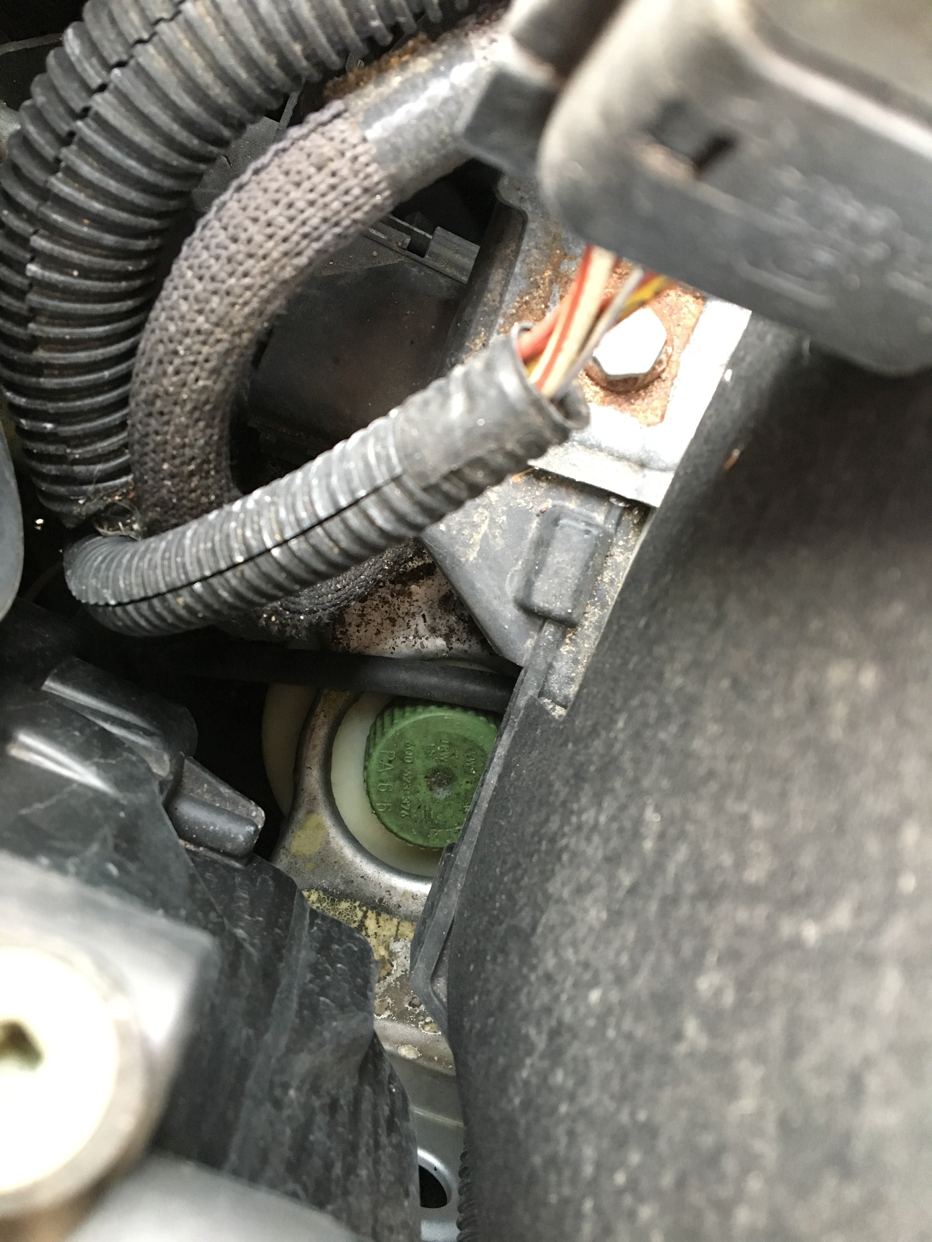

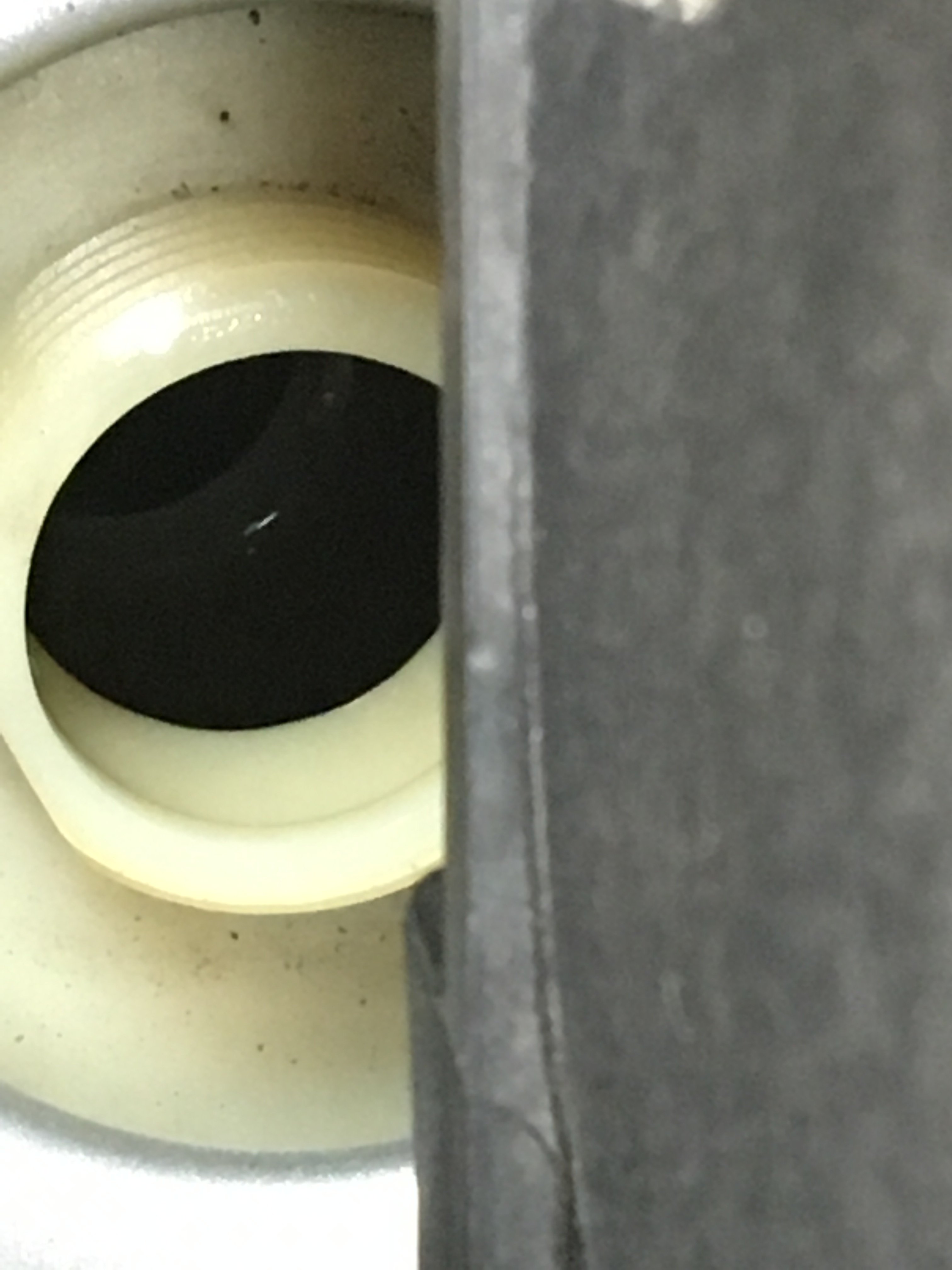

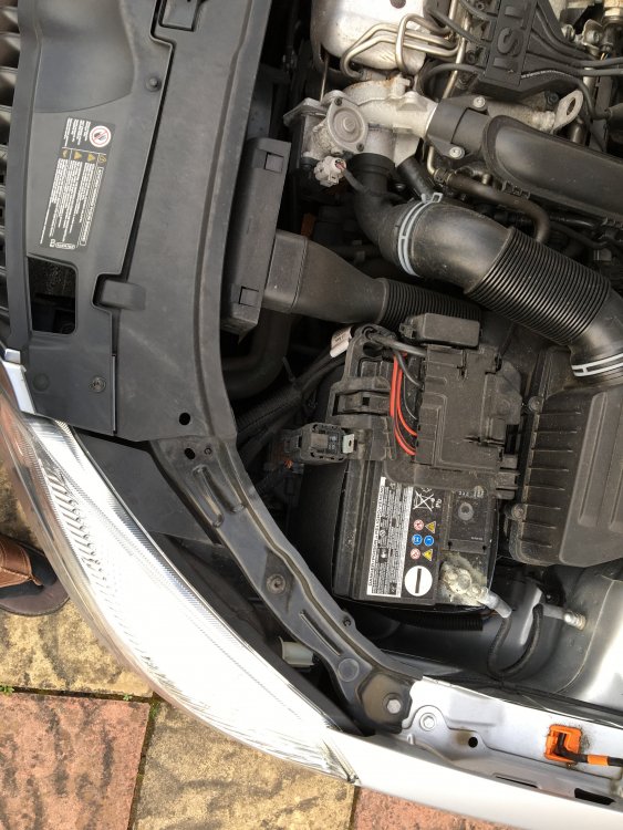

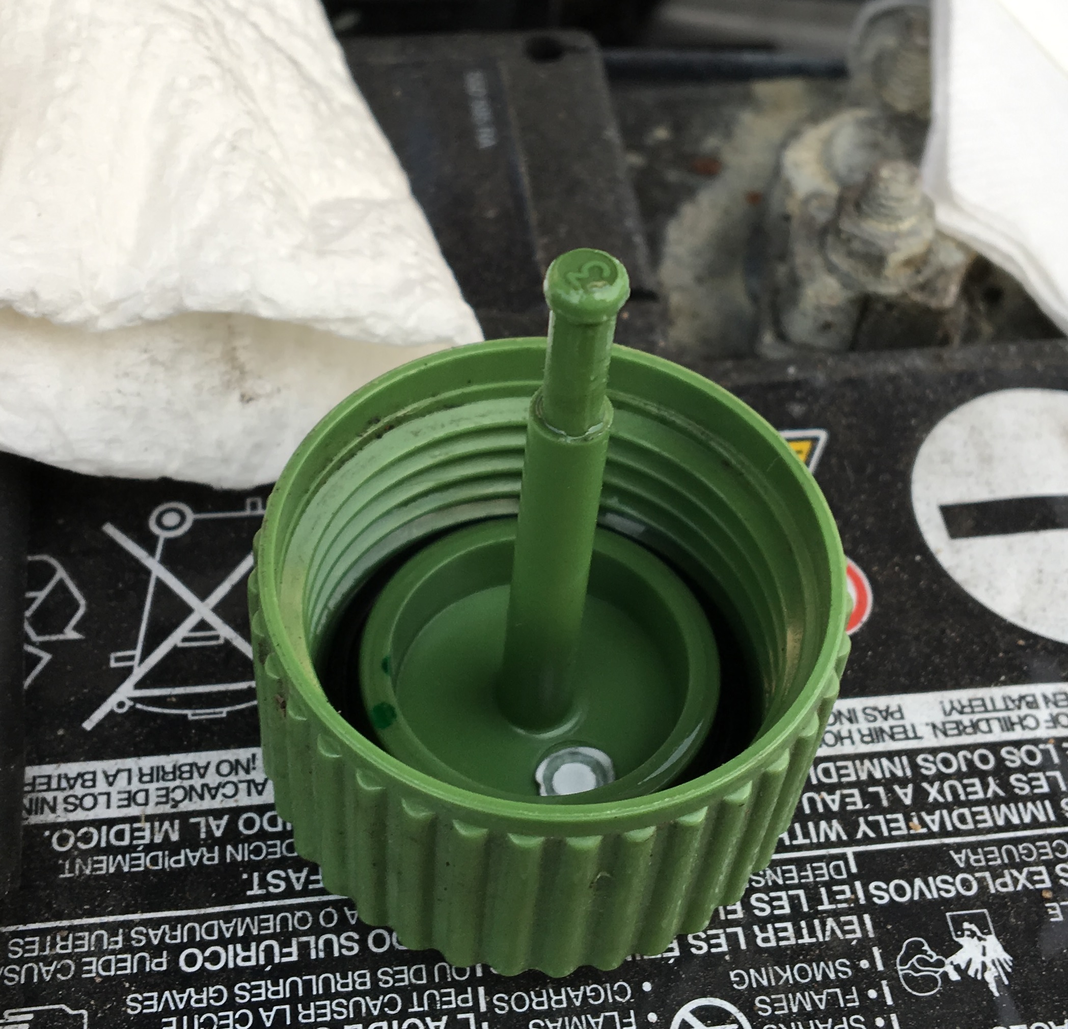

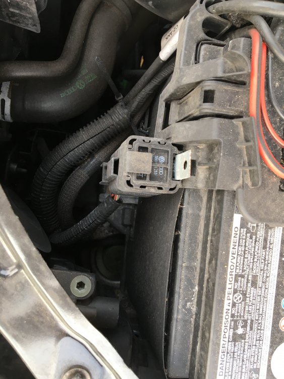

Well, as you stated KenONeill there is PAS reservoir and it was a pig to get to!  It is possible leaving the battery in place and you can get both hands down to reach the screw top.
I gave the lid and the surrounding area a bit of a clean to ensure no dirt drops in to the tank.
I got that off and indeed the level was below the minimum, but there was actually plenty of fluid in there. You can see it when you rock the car.
I would be surprised if just being under the minimum makes a difference.
I guess the only way to tell is to top it up to see.
Few pictures for others reference.
