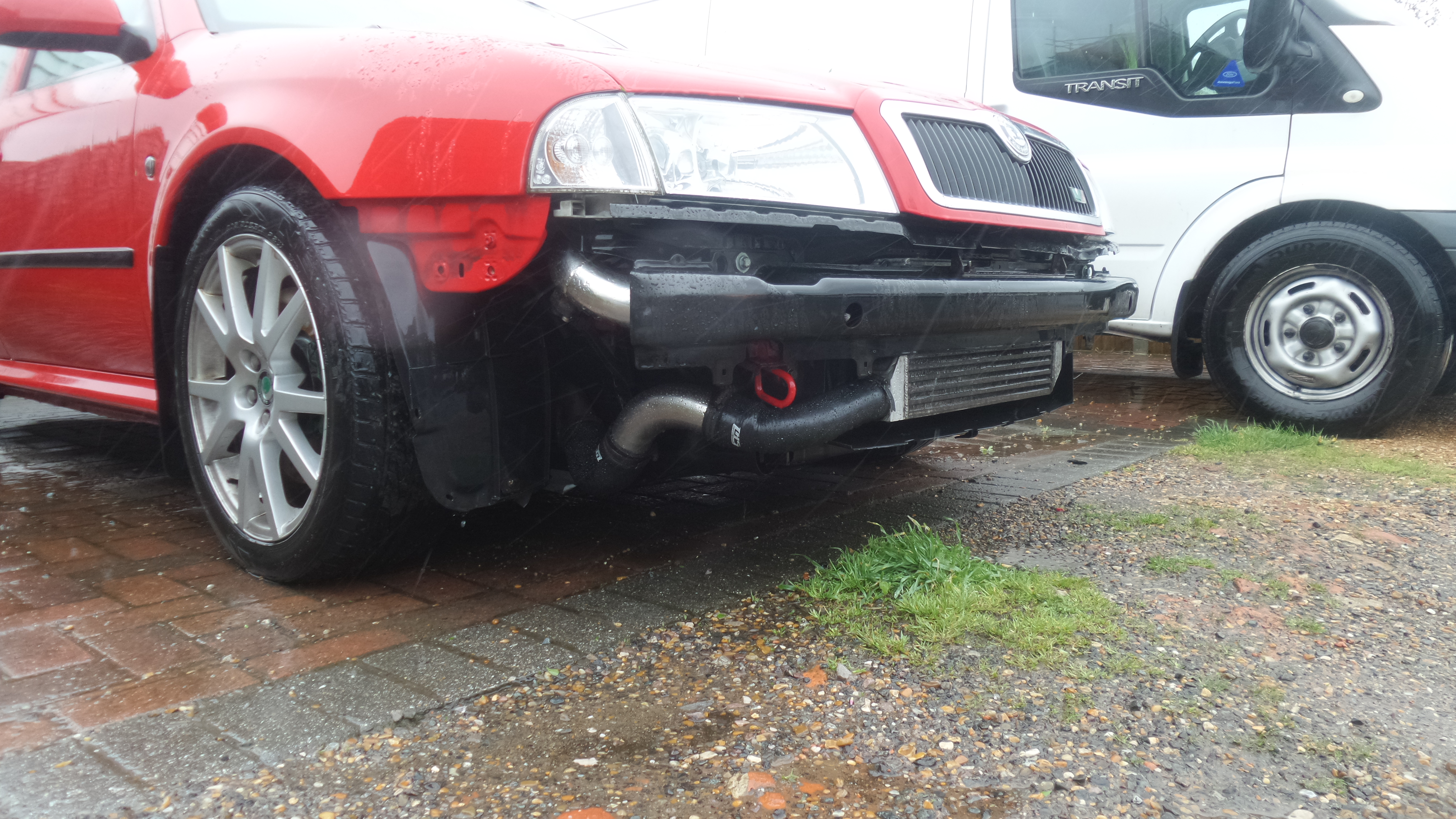

I've got a THS fmic on mine, both pipes on the same side.
Pipework isnt visable at all and all standard grilles are in place
Now that’s something I’d look into... did you have to do any mods for that mate ? And if you don’t mind me asking where from and how much ? Thanks
None at all but I was lucky because it came with all the pipe work and a crash bar which was already modified for the cooler.
In short part of the rear of the crash bar has to be ground out so the upper hose sits inside the bar effectively

Mine is almost impossible to see and its silver, you can just see the top of it through the grille I think but a black one would be invisible pretty much.

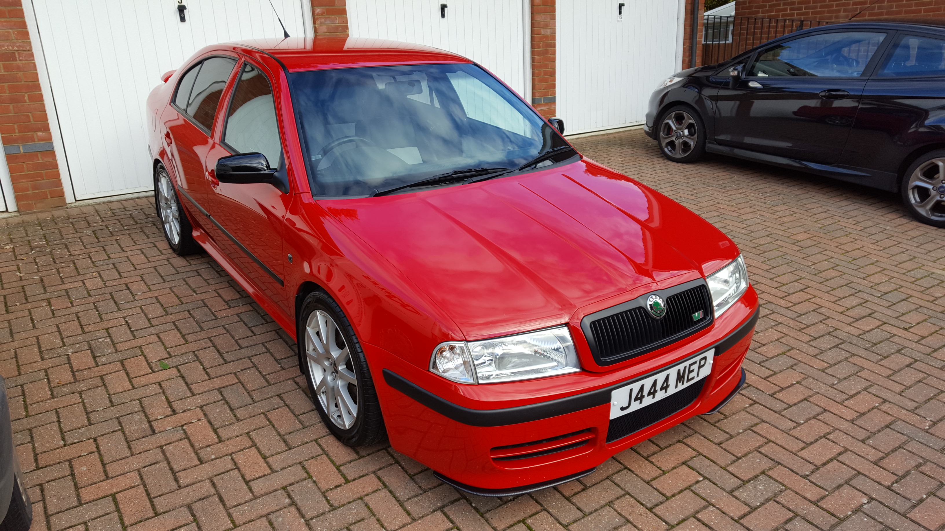

Looks good that does mate That’s what I’m after the stock look ... and out of curiosity what splitter have you got on it?

Our cars are very similar. My plate is 666 also red with a black wrapped grille
They're Miltotec corner splitters.
