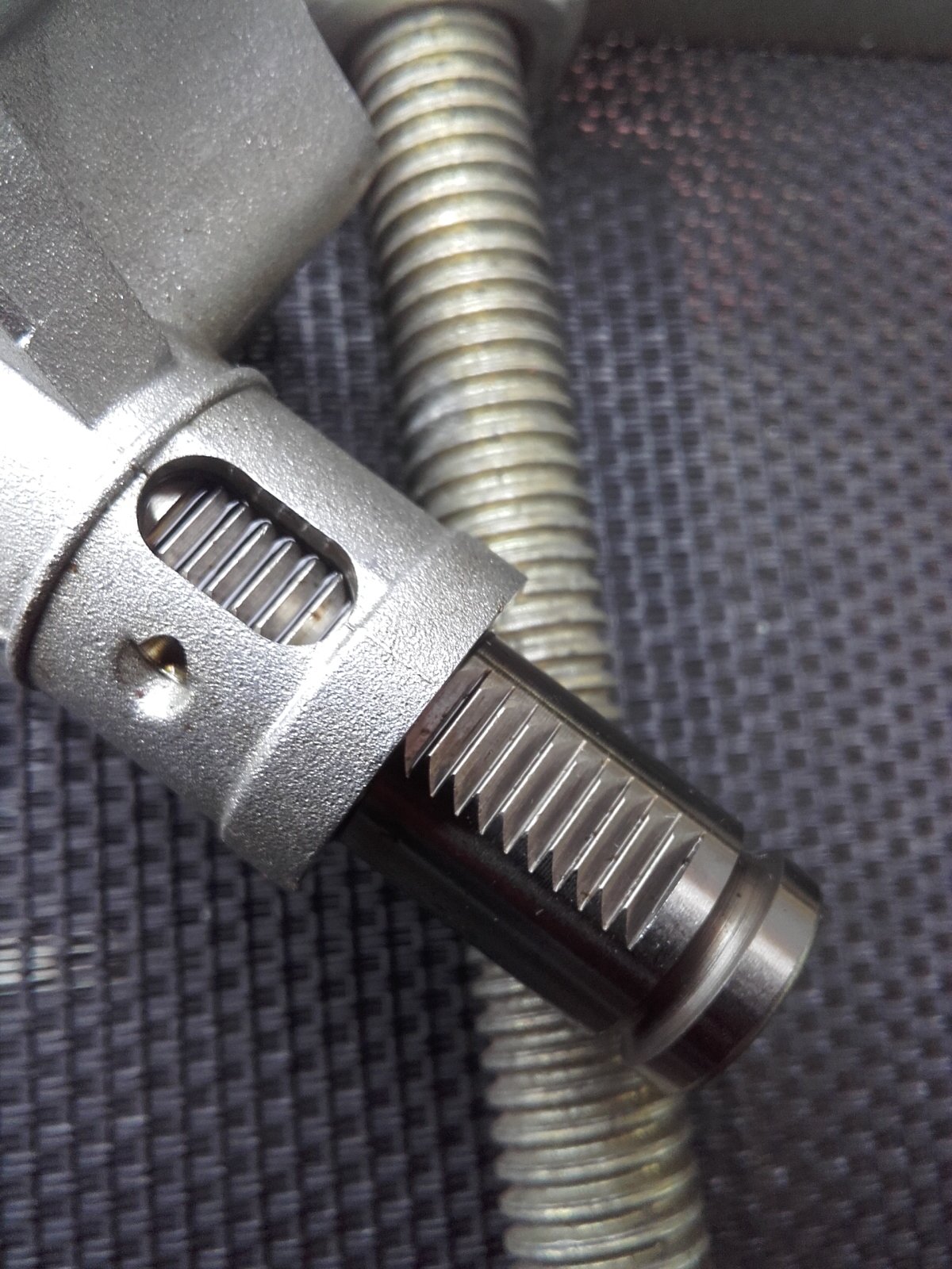

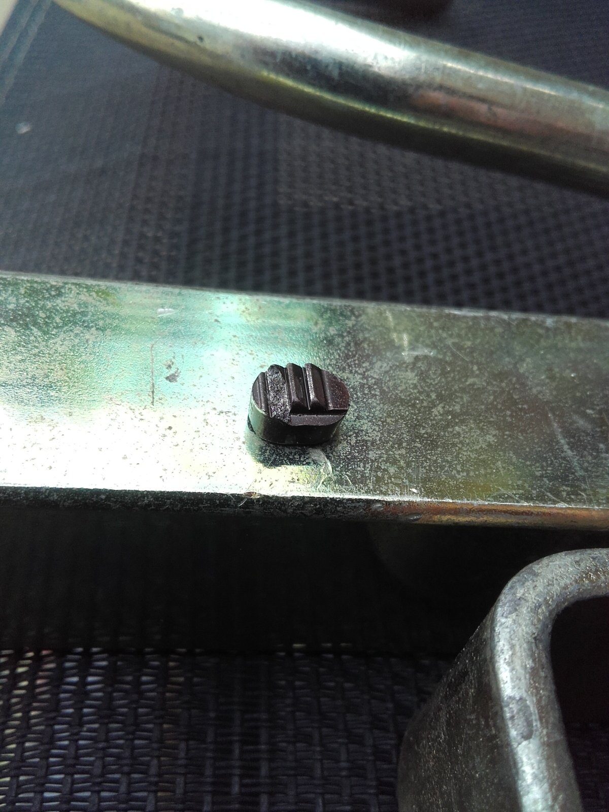

I bit the bullet and had the tensioner replaced for peace of mind, I'm glad I did as I asked them to keep the old tensioner for me to look at. As you can see from the pictures when I took it apart, the teeth on one park of the ratchet are fine, but there are teeth missing and wear on the other part....phew. At least I can sleep a little easier now
