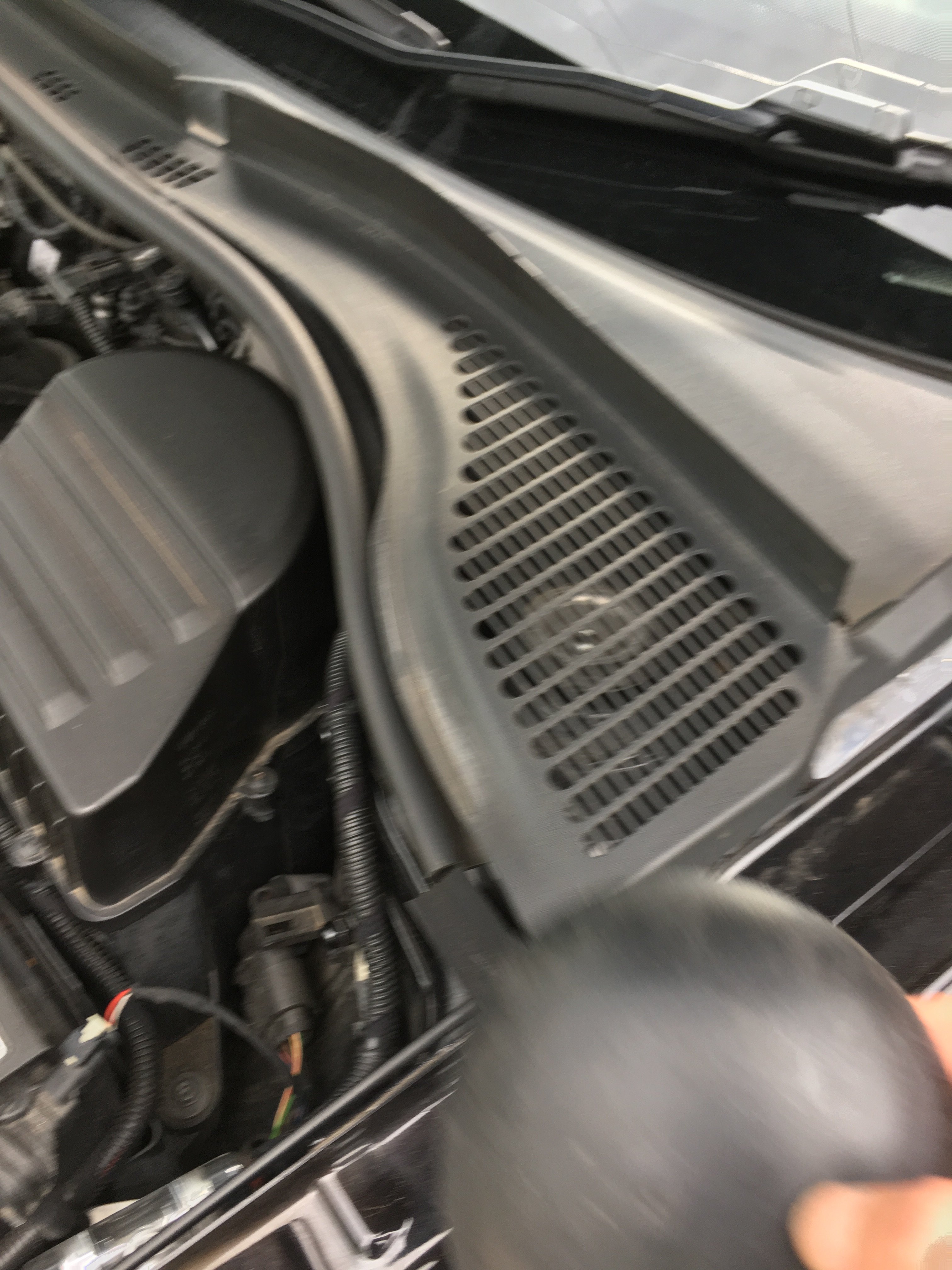

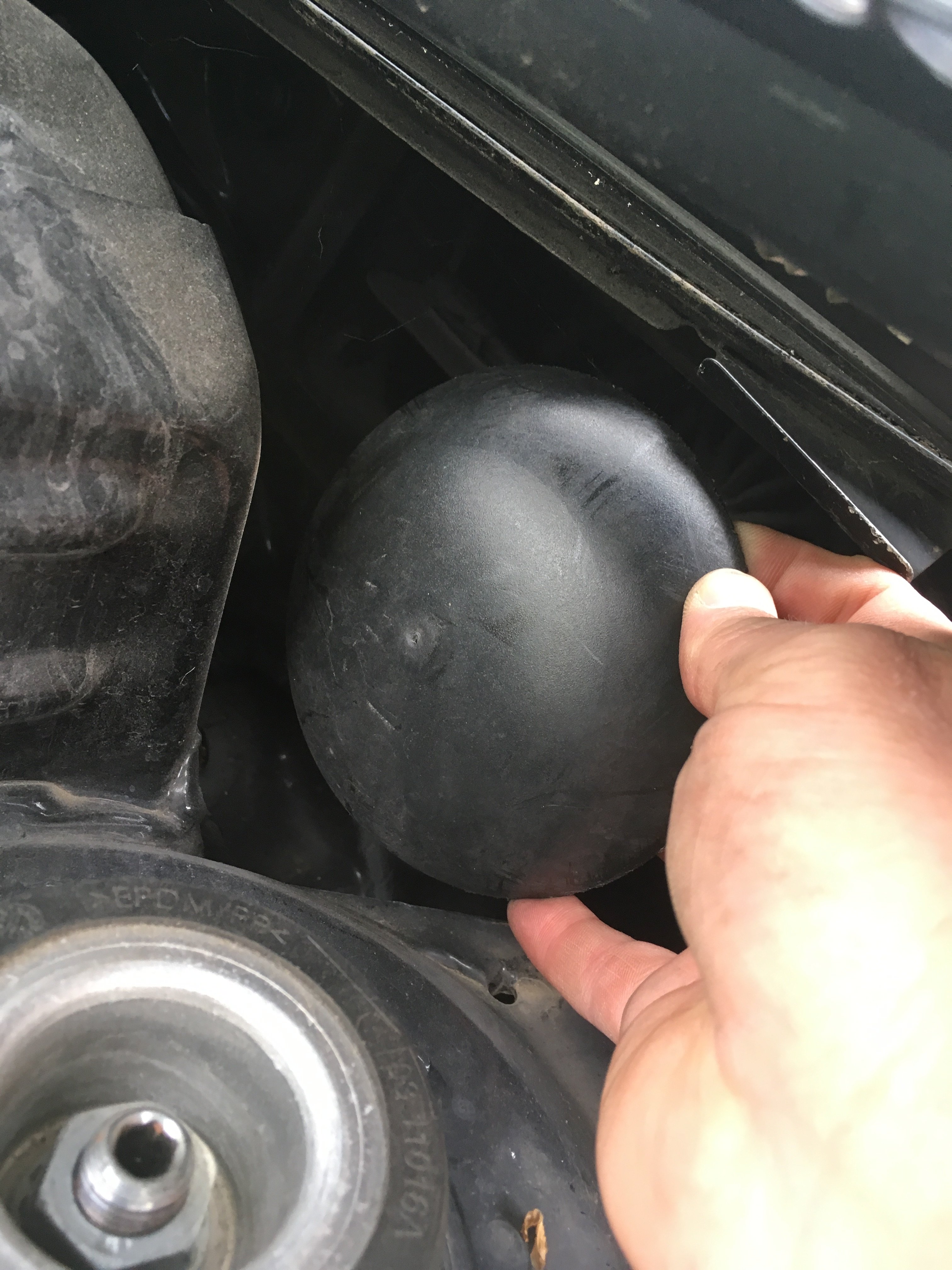

Thanks for all the advice... I couldn’t get my hand in all that far but it did dump a load of pollen. However, I found the problem... the cap off the suspension top had come off and was agains the fan!
Thanks again... I can stop panicking about the hundreds of pounds it might have cost me... ... I just need to buy a pollen filter as half a tree and a bee house full of pollen has fallen out  ;)
