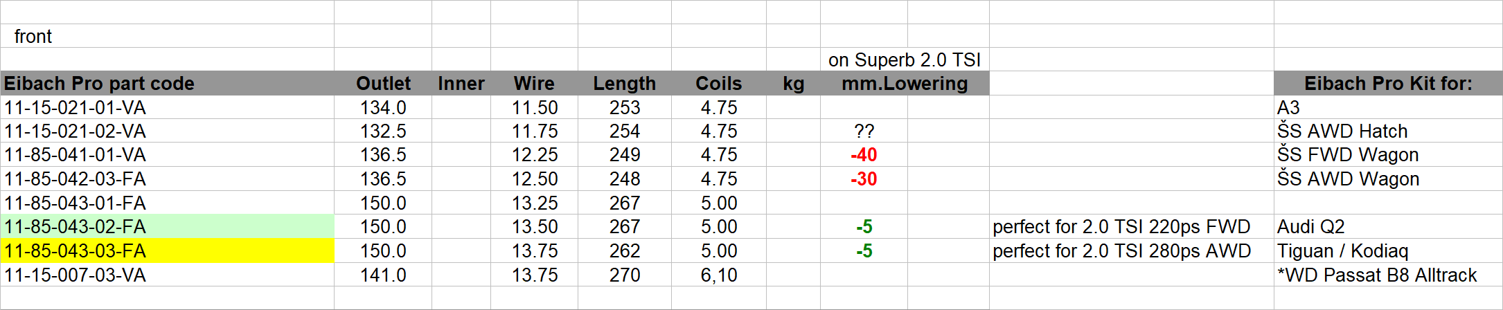

Sounds good to me... What is drop on the eibach kit? I still want it to remain practical
red numbers in my table

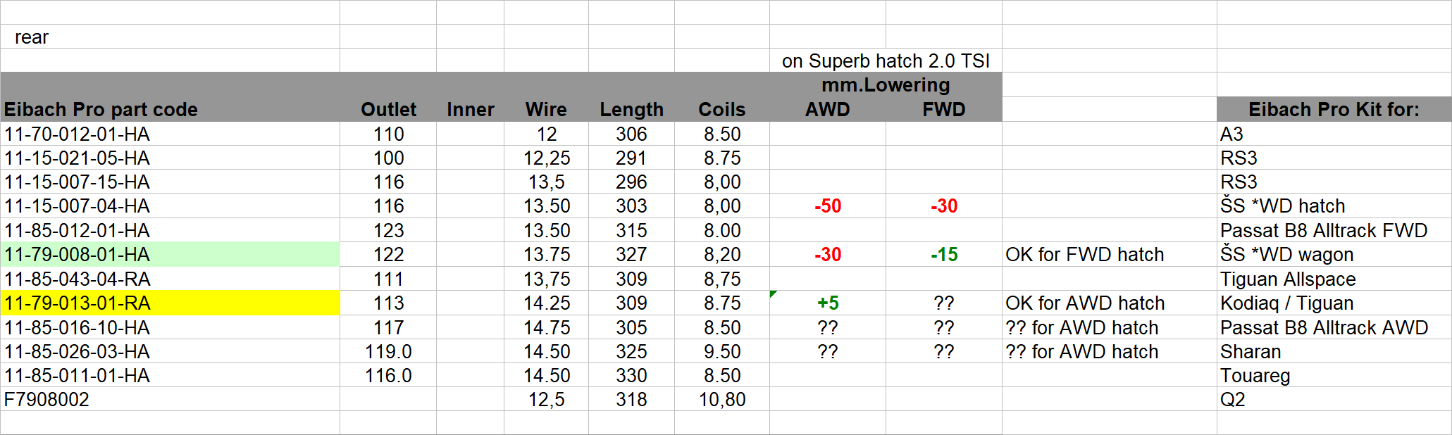

If u get the Pro-kit version, and u have DCC shocks - it will drop approx 20 to 25 mm.
Standard shocks will see it drop approx 35 to 40 mm.
Is there anything that lowers it little less? Only looking for 15-20mm max
