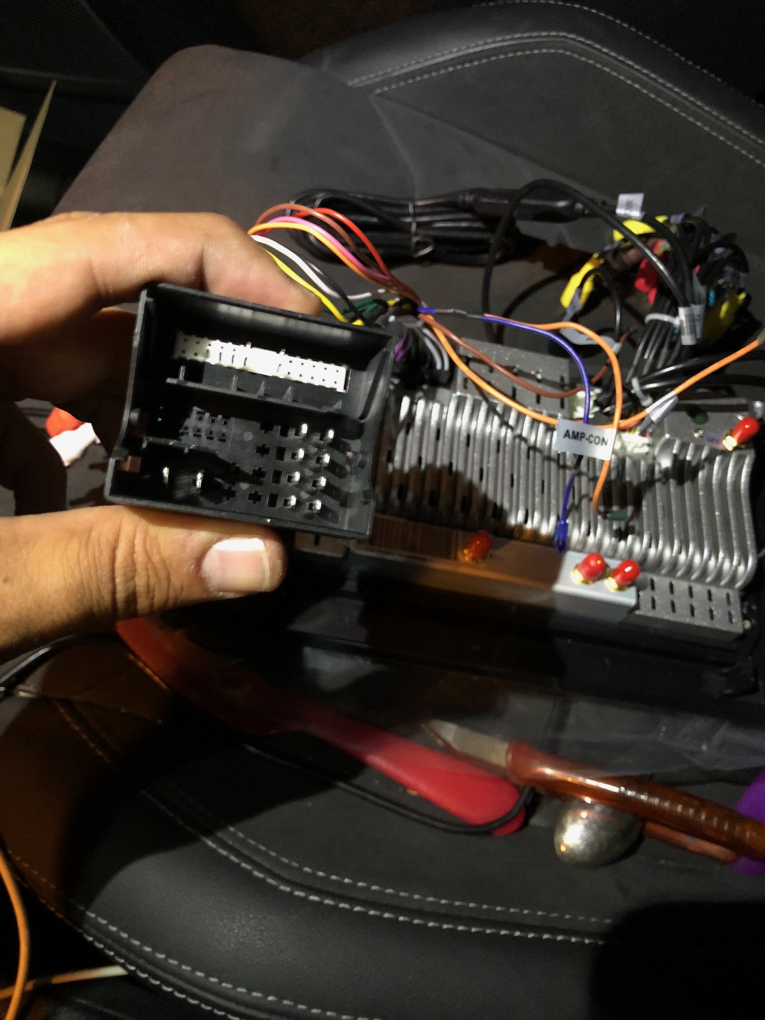

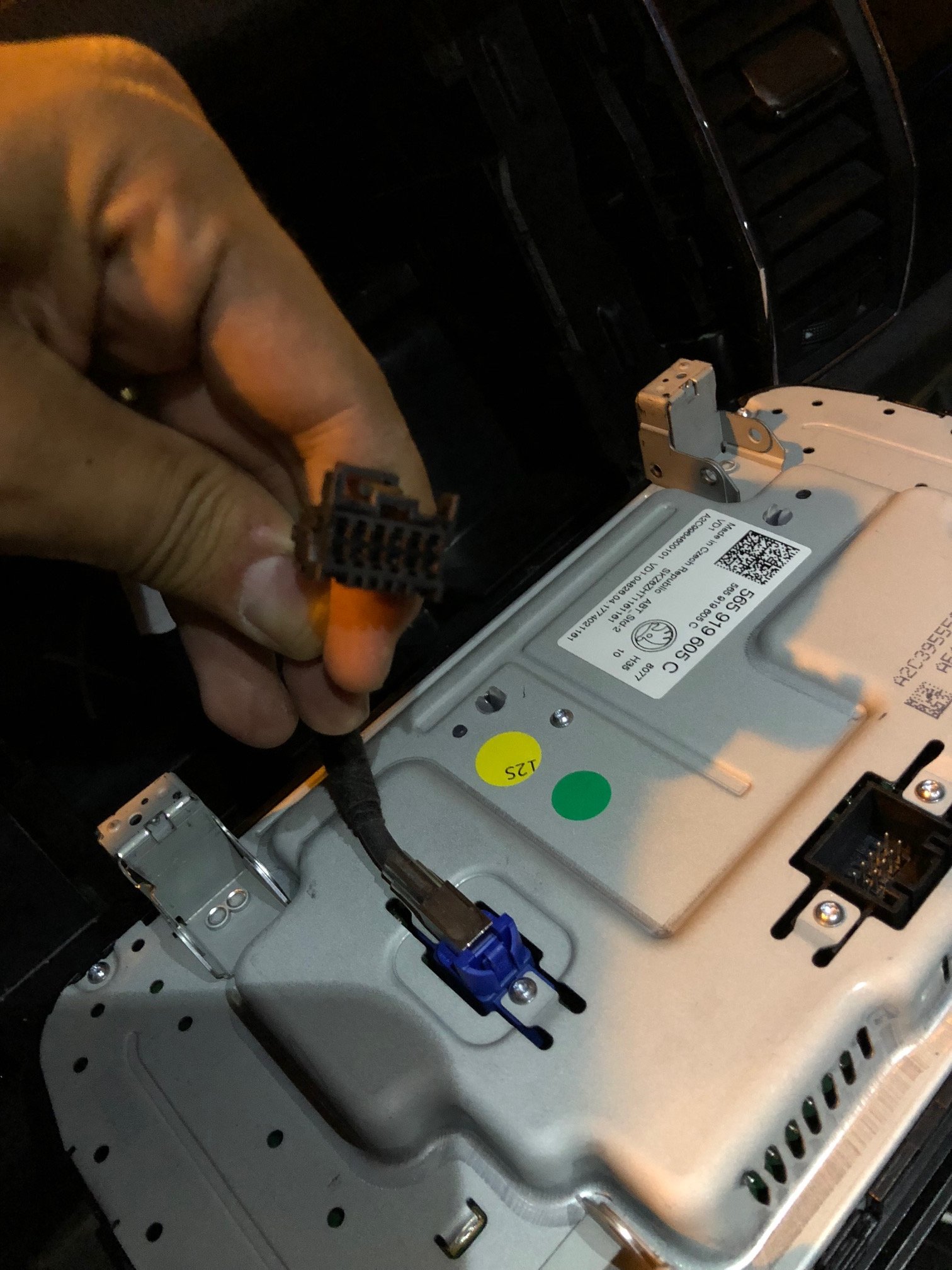

i'm looking to replace my Columbus infotainment with an Ownice C500 Plus ,
i managed to remove the head unit with the four keys and i can't find the power harness to connect to the new unit.
i tried to find guides / technician manual but i can't seems to find them (if anyone has a PDF / instruction video it will be great)
attached pics of the Columbus unit connectors + the new Ownice connector.
any advise?

The screen unit you've removed is simply the display for the Columbus. The brain of the system will be inside the glove box with either / or sd card slots, dvd drive, sim card slot. This is where the power connector will be for the new unit you're attempting to fit. Although (as pointed out) I'm not sure what your new unit will bring you against the functions you'll lose from removing the Columbus. You'll have to keep us informed.

The unit in the glove box should just remove using the same keys as the screen, and there'll be connectors on the rear of that. I guess you'll need an extension / adapter loom to run the required cables to the screen new unit from the glove box.

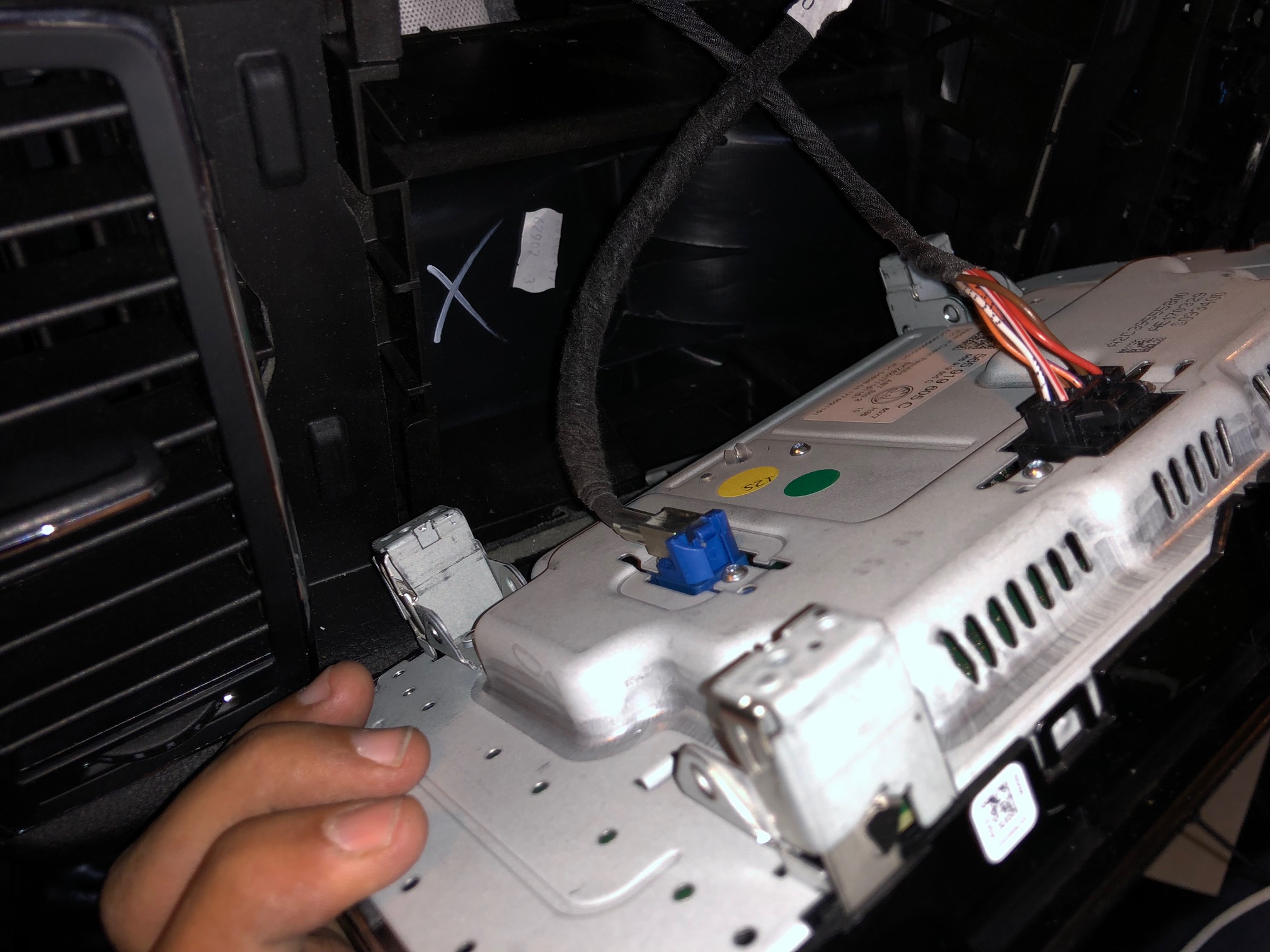

Hi Ziondavidov,
Did you manage to get the unit out of the glovebox ? I'm trying myself but can't get to the wires behind to unplug, almost like the wiring loom is too short, did you have same problem?
I’m guessing the cables may just be a little trapped it’s very unusual to have a loom that short that you can’t pull the headunit out I’m guessing also you maybe able to remove the lower glove box and stick your hand up . Have a search for diy camera installs
