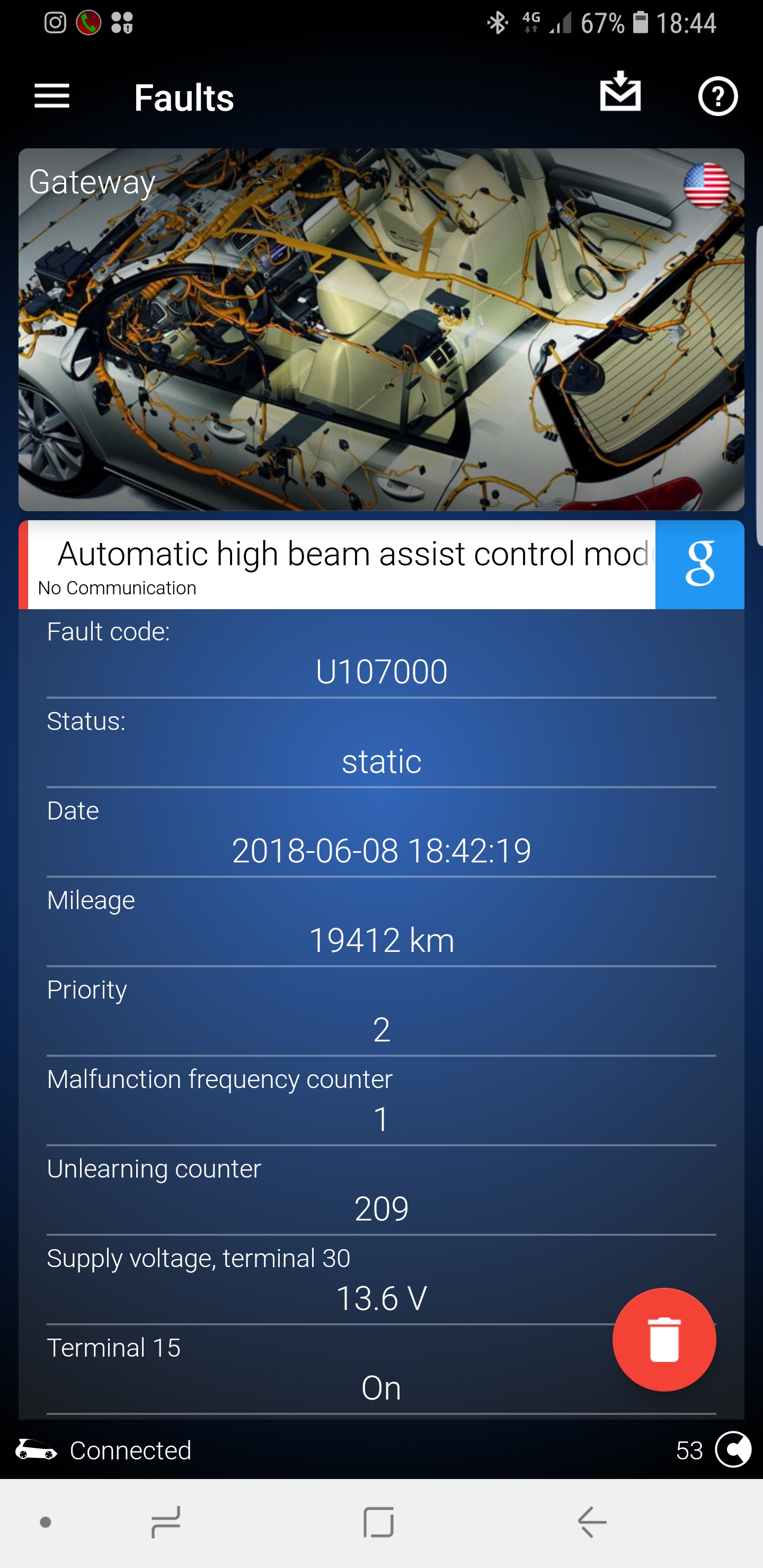

Hello. I activeted the adaptive high beam on the obdeleven and everything seems alright but the problem is that when it's dark it doesnt work.
I connected the obdeleven once again and it shows me a foult that i cant erase.

The fault code says it cannot communicate with the auto high beam assist control module. At a guess, your car does not have this module fitted, so although you enabled it in another module,  the canbus can't find it.
I think HBA requires the windscreen camera to be fitted as well.
Another explanation is that sometimes enabling functions require two or more things to be changed or enabled.
Use the rollback feature of OBD11 to get rid of the error (which I presume it has).
That would be my guess too. I enabled HBA using the OBDeleven app and have had no error messages.
