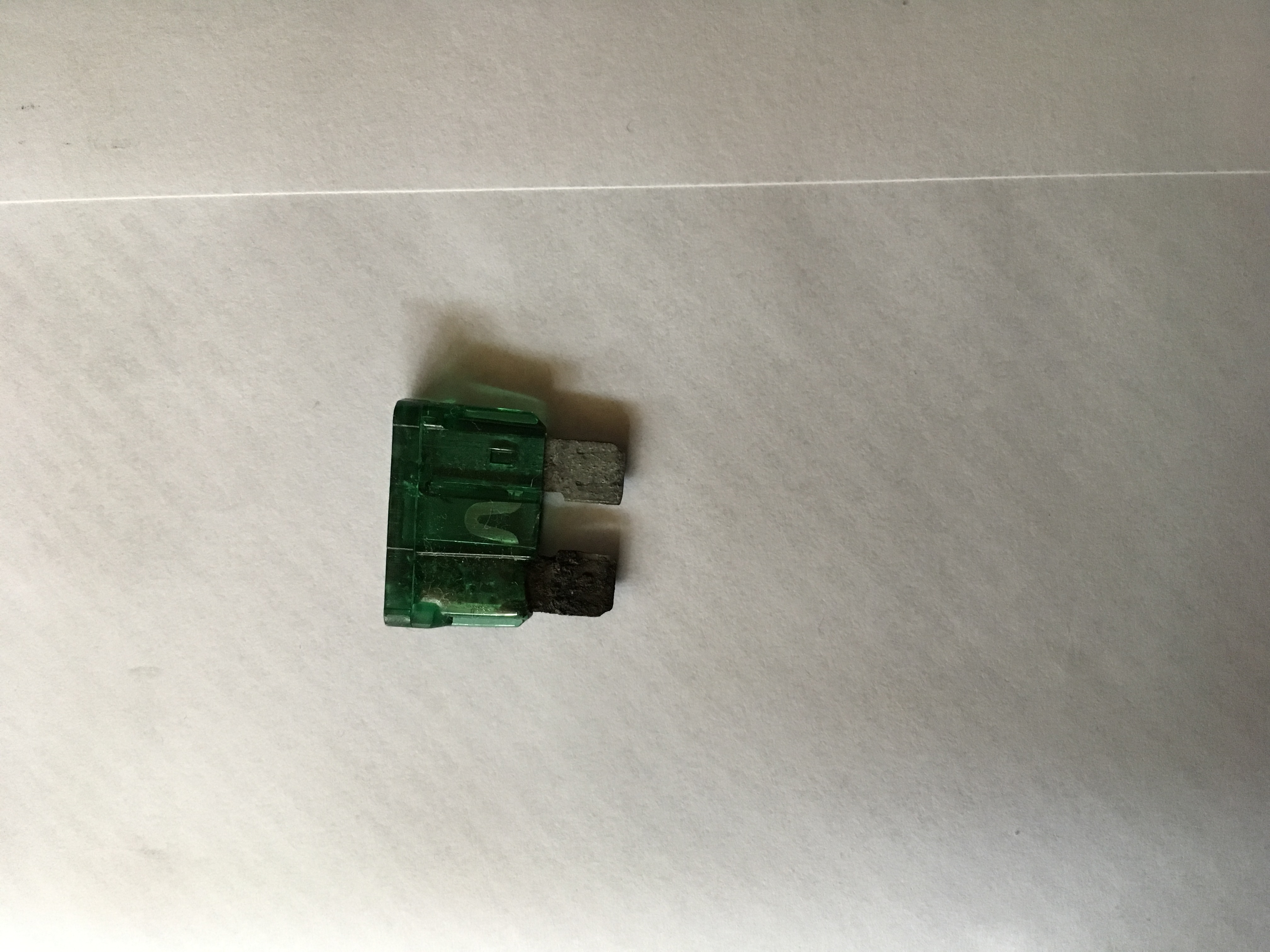

Checked the main fuse box next to the battery and pulled out fuse F16.  One of the pins was black, and the fuse box body had melted slightly in the area of the black pin.  High resistance connection was the culprit.  As the plastic by the pin had melted away, it was easy to get access to the contacts to clean them and carefully adjust their position.  New fuse fitted and all the lights are working.  Thanks for the replies guys.  Cheers.

Just thought I'd like to thank you for adding the fault to this issue as it just happened to my 08 Octavia . It had me bamboozled till I did some digging on here . Nearly the same issues with the lights except the front near side were all working.  So I pulled out fuse F16 which is a 30 amp . In the box in the engine bay and bingo burnt blade but the fuse it self was in tack and had power at both sides .  But in the process of hunting for the fault I disconnected the battery and now have the amber air bag light illuminated . .
Apologies for the late reply,  just getting over a bad dose of Ryanair travel fiascos.  Glad the post was of some help, its always worth taking a look a fuses periodically, particularly the contact blades and cleaning them both sides with a fine grade of wet and dry. The fuse element and contact blades are pressed aluminium.  Natural aluminium readily oxides and the oxide is of high resistance and invisible.  Last thing you want is a high resistance connection, as this readily heats up.  As the fuse heats up its ability to carry current reduces, of which compounds matters further by getting even hotter.
