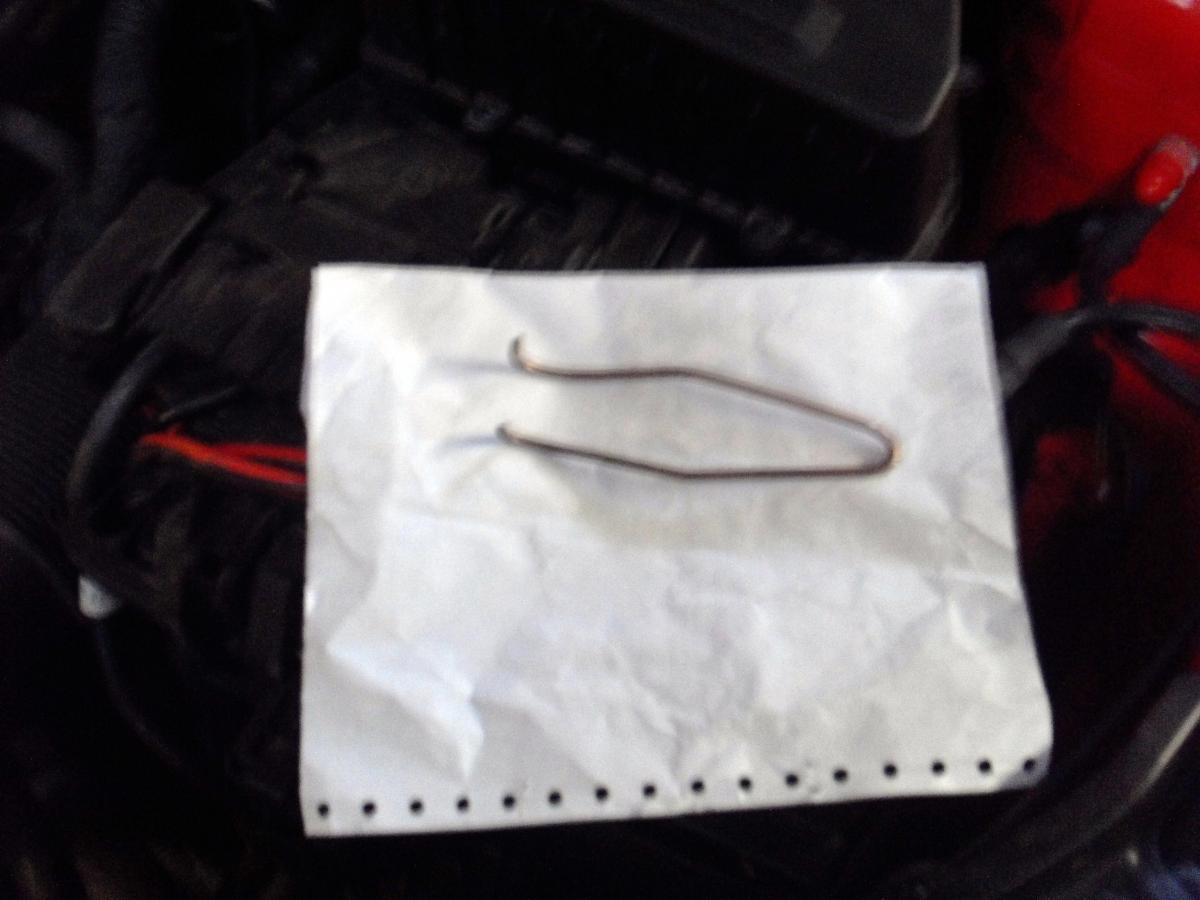

If i have no tool to hand i make a Coil Removing tool.
Something like this. Sorry about poor pic.

Ah greatly appreciated, i like what you have done for a tool also. Seen as though its £12 and i do plan on keeping the car for a year or two it will be well worth the spend in my opinion.
Thanks again.

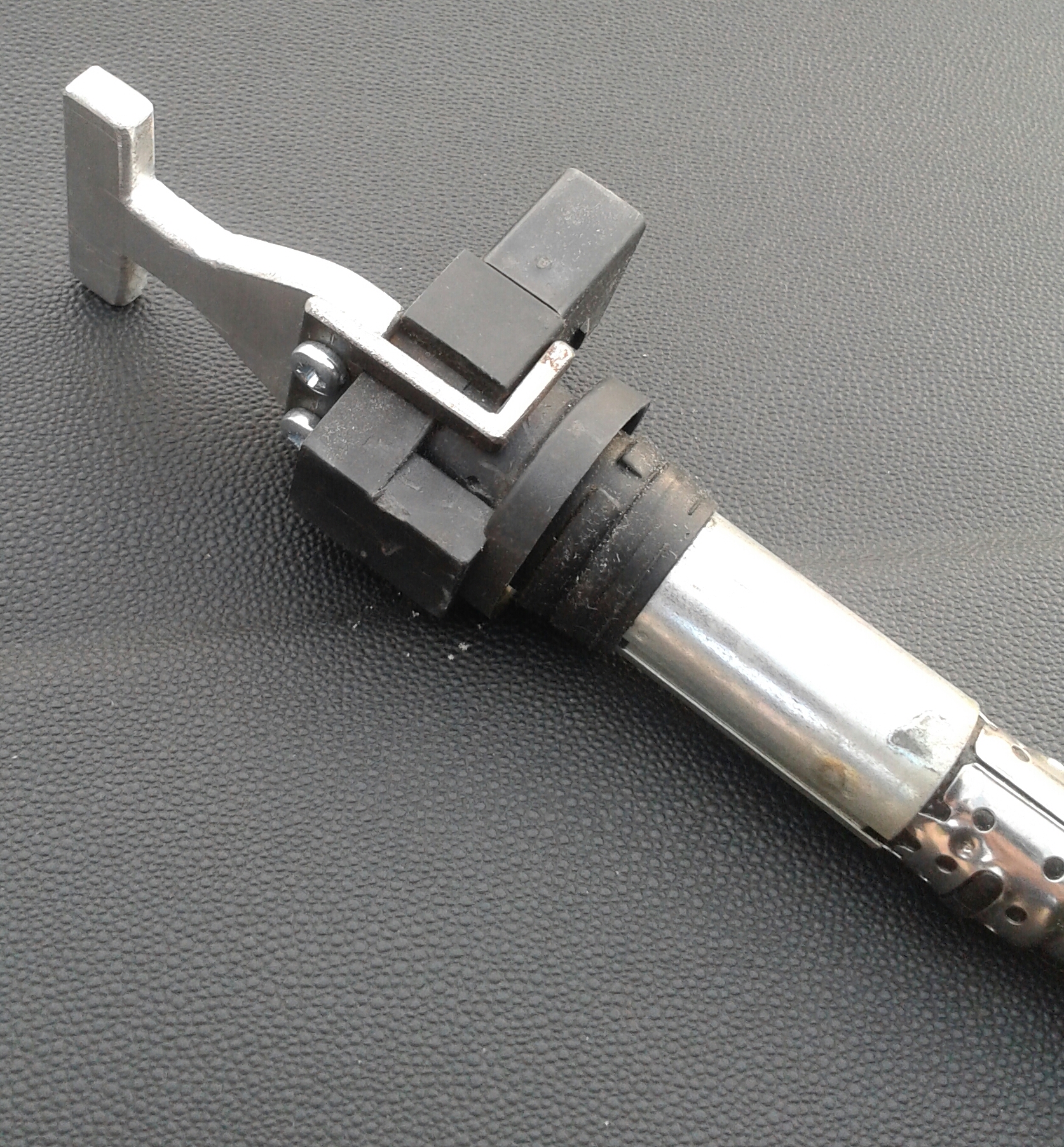

  • Sponsor
Make your own out of a piece of angle, and some flat plate:
Oh wow, as neat as buying one from the shops, cheers :thumbup:
