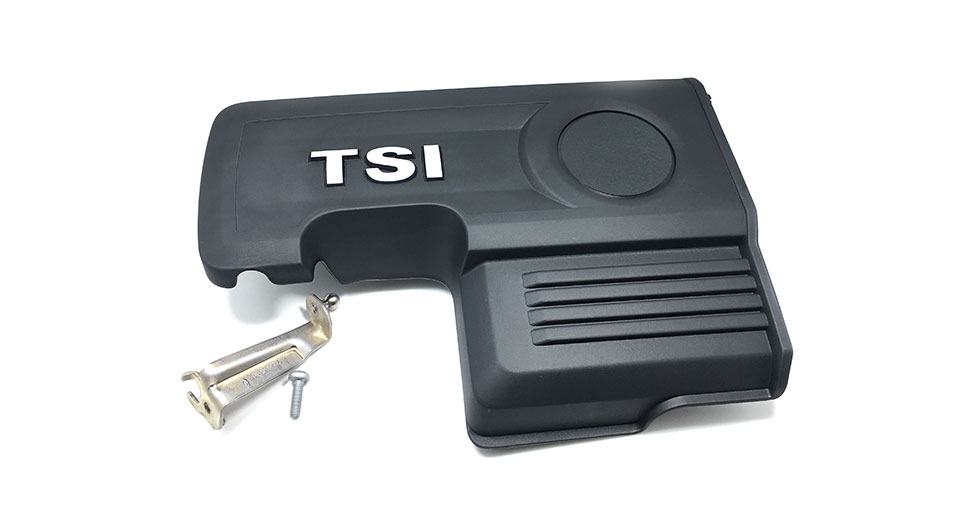

1.4 TSI Engine Cover
Simply aesthetic I'd suggest. Nothing more. Nothing wrong with that either. I'd not expect it to make any discernible difference with noise.

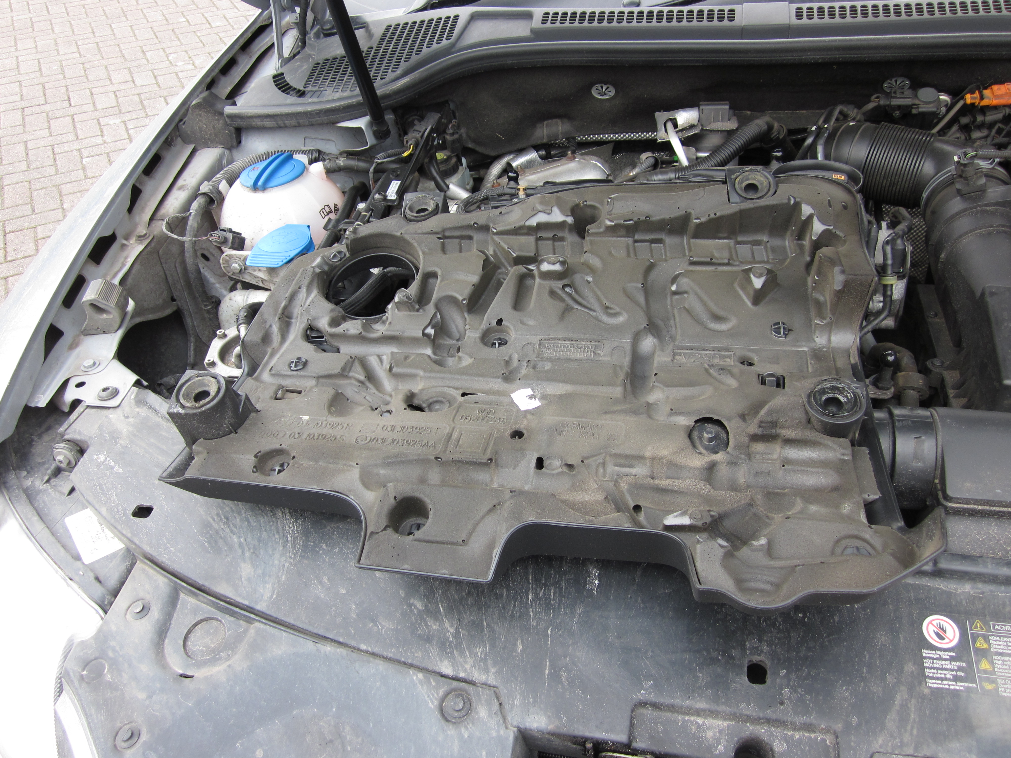

There's quite a bit under the engine cover on my Superb, but it does cover more of the engine...
The Diesel engine of your Superb needs more sound proofing than the 1.4 petrol engine.

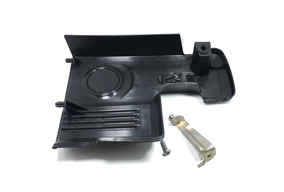

Although it's an aftermarket cover I'm pretty sure it's based on VAG's existing design, it's just not fitted to the Kodiaq, or Karoq.
Now the Kodiaq is established I've noticed the cost reduction exercises are starting to kick-in. Some model year (MY) 19 engines now no longer get the sound proofing pad under the bonnet.

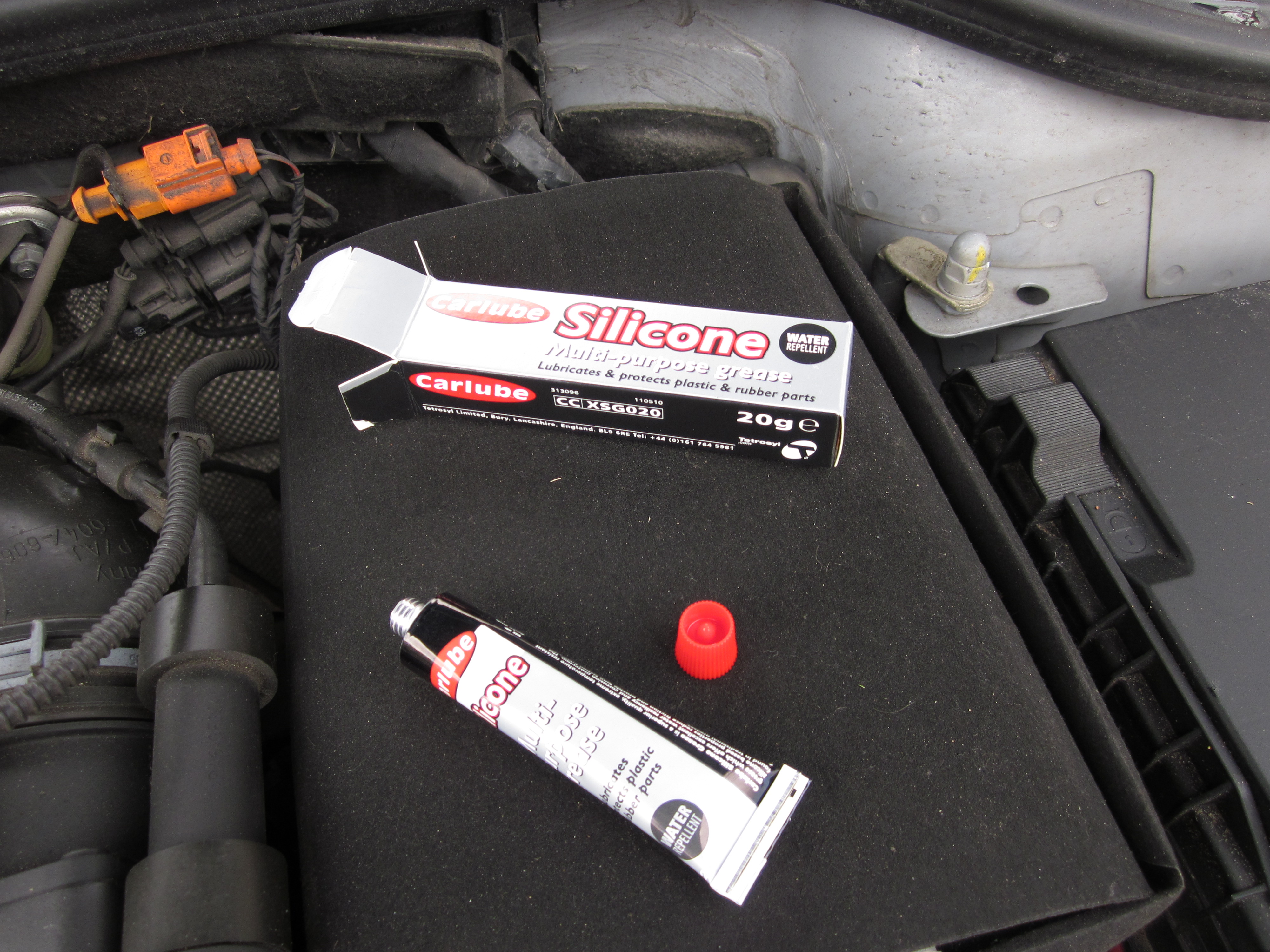

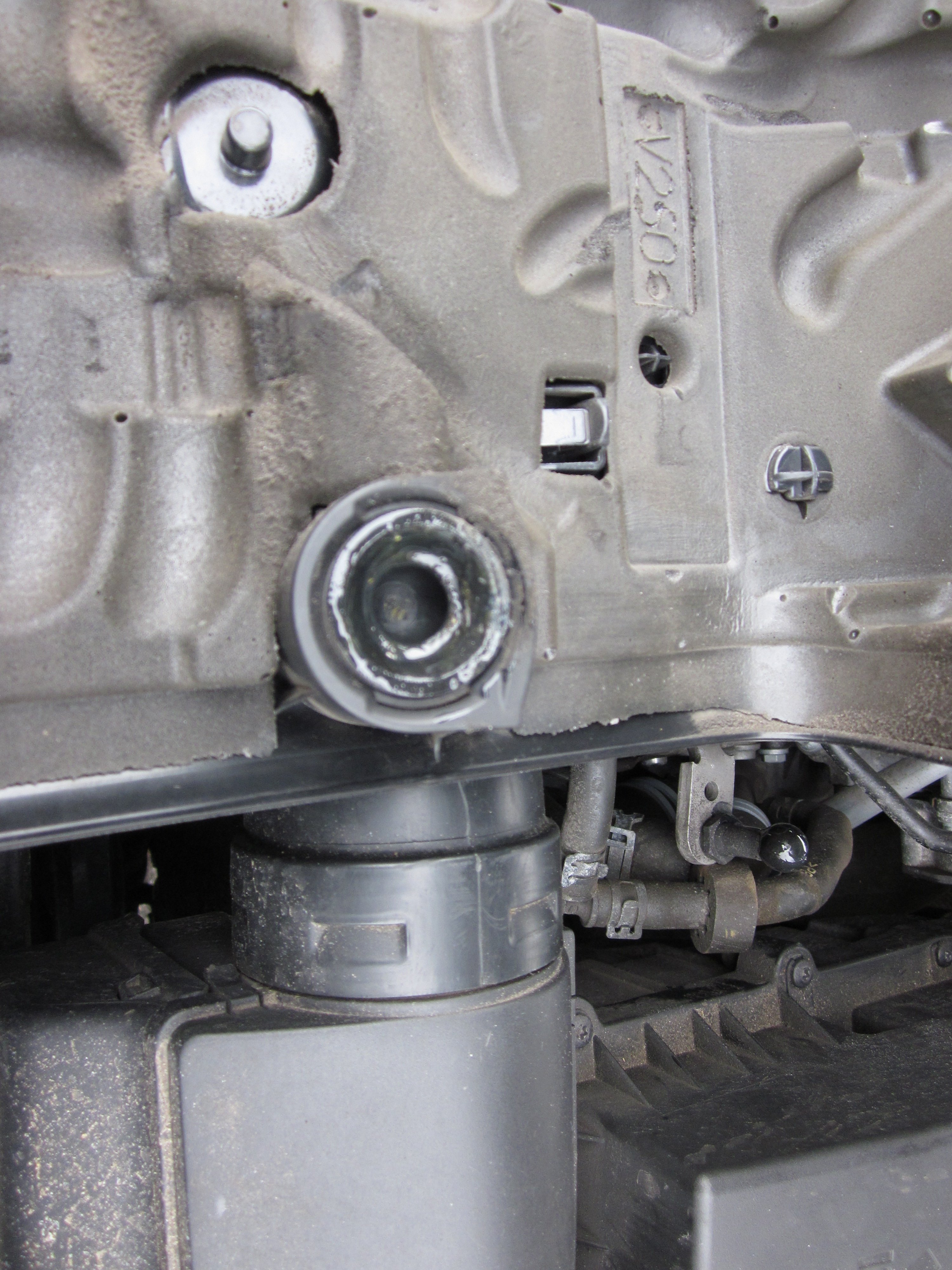

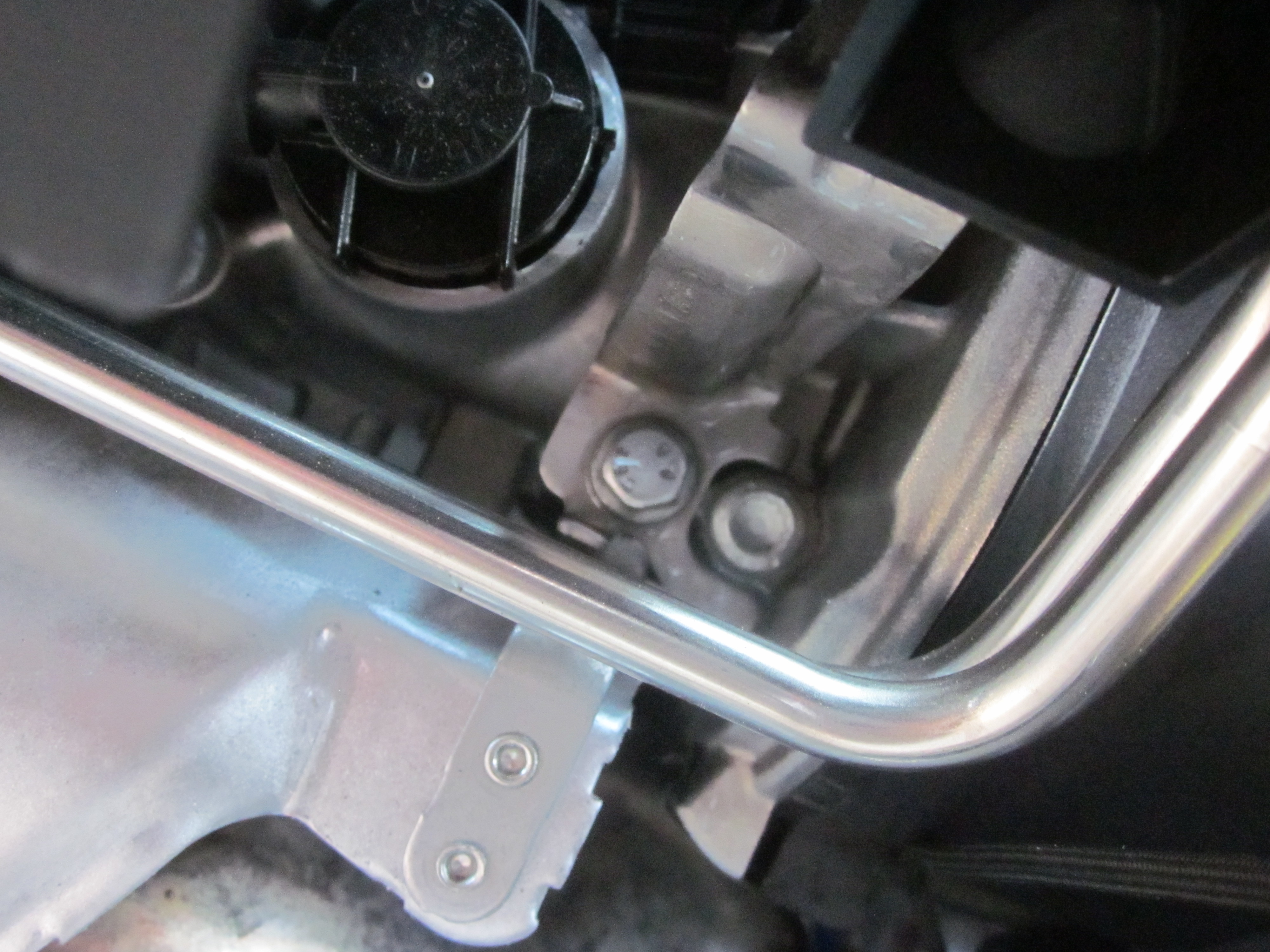

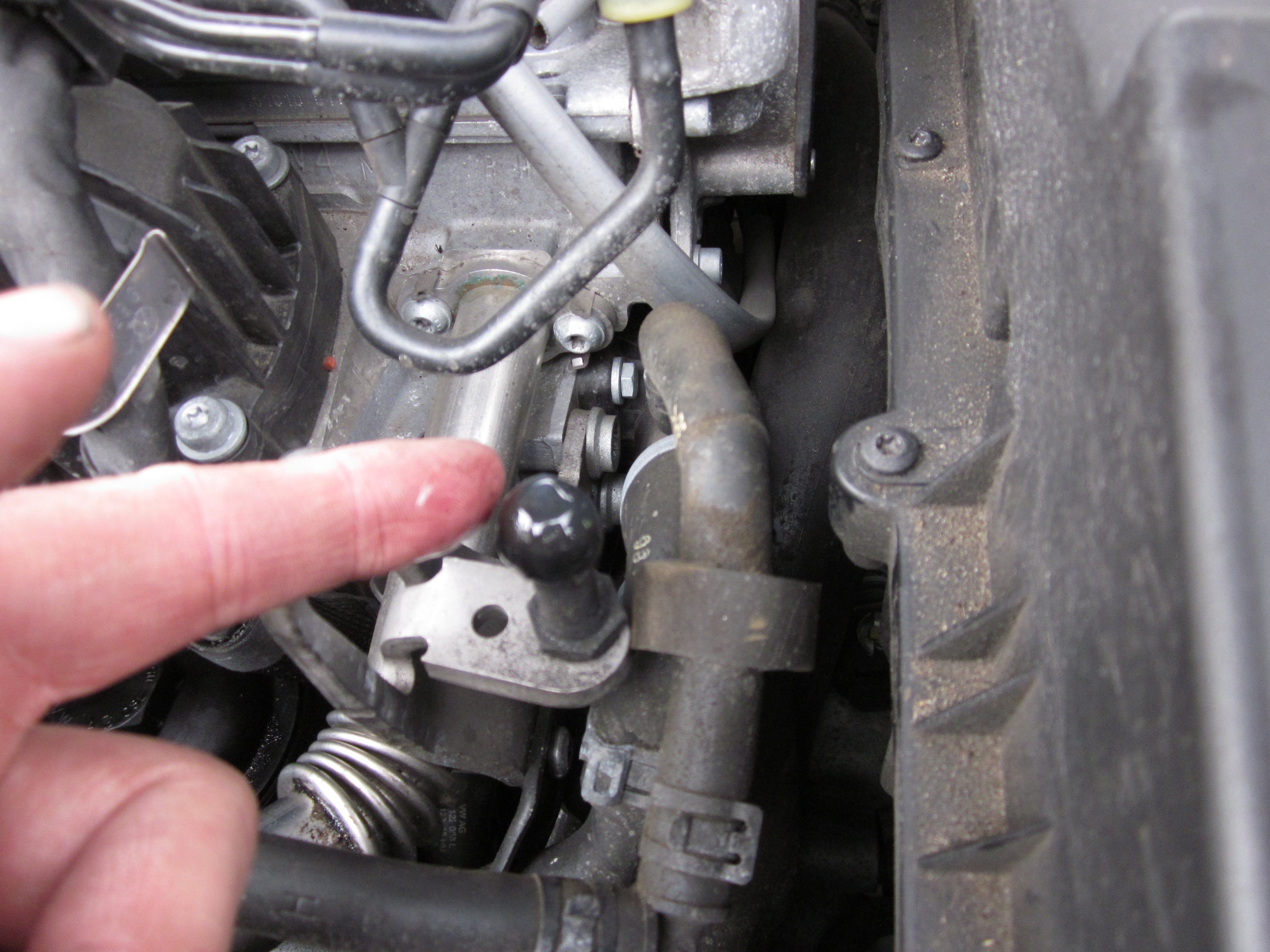

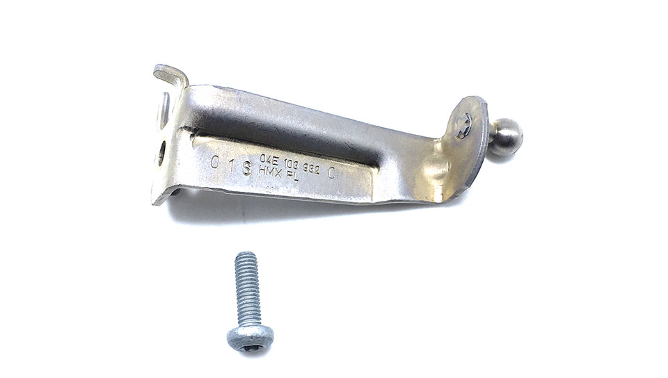

The cover comes supplied with 4x metal mounting brackets that are the same as those on my Superb and bolt onto pre-threaded holes on the engine. They have balls on the end which allow for the push fitting of the cover over onto the balls using (replaceable) rubber grommets.
I add a dab of silicone grease to the ones on the Superb to keep them supple...
They do a reasonable job of absorbing the vibration from the engine. It's only when the grommets wear and perish do the issues become apparant.
I guess the fact that the threaded holes for the mounting brackets are present would suggest Skoda saw some benefit to it. Perhaps it is purely aesthetic.

Assuming the female apertures are on the airbox to accept the two lugs are there, and there is an unused thread to take the support bracket then it's likely Skoda have simply chosen to save themselves the £3.24 cost of the part.

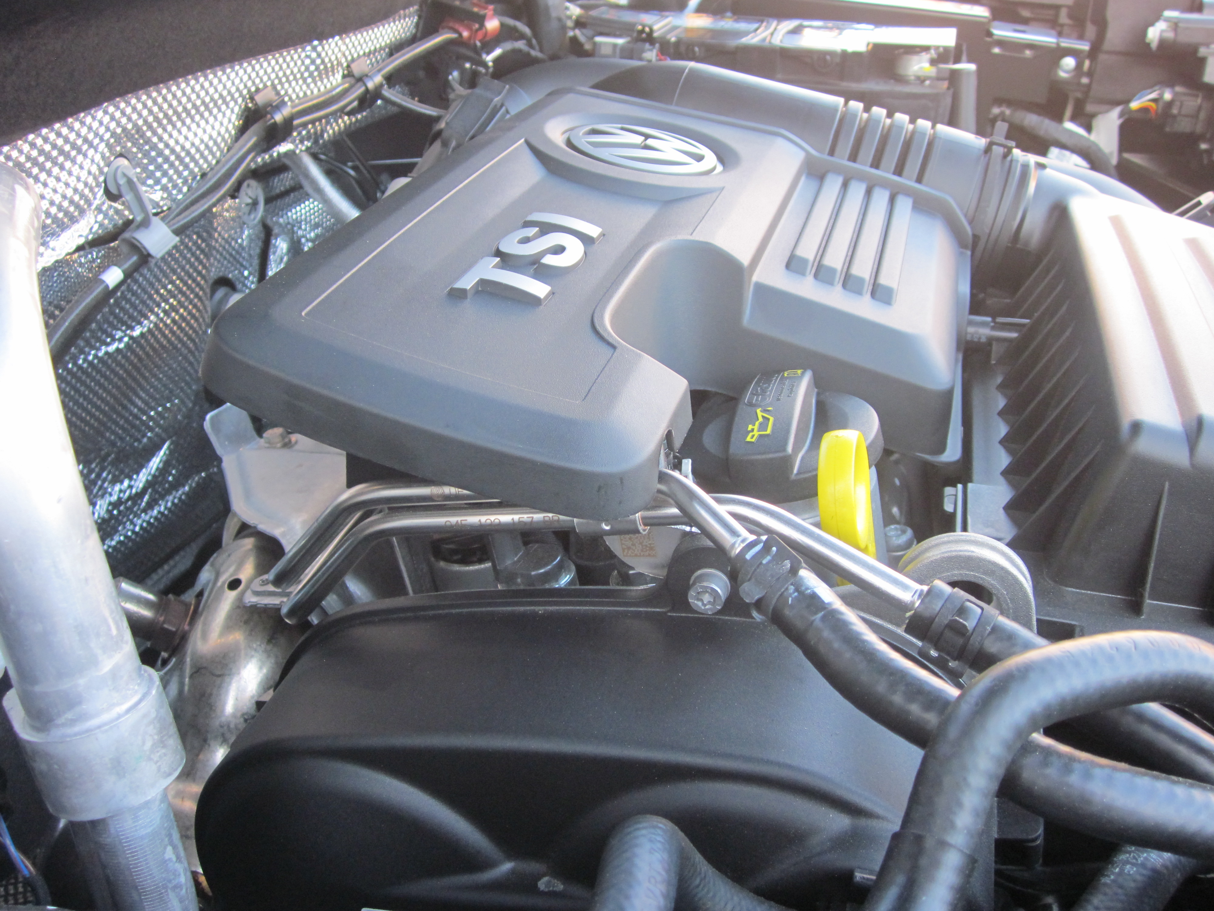

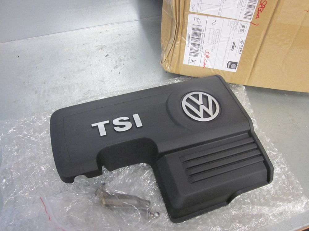

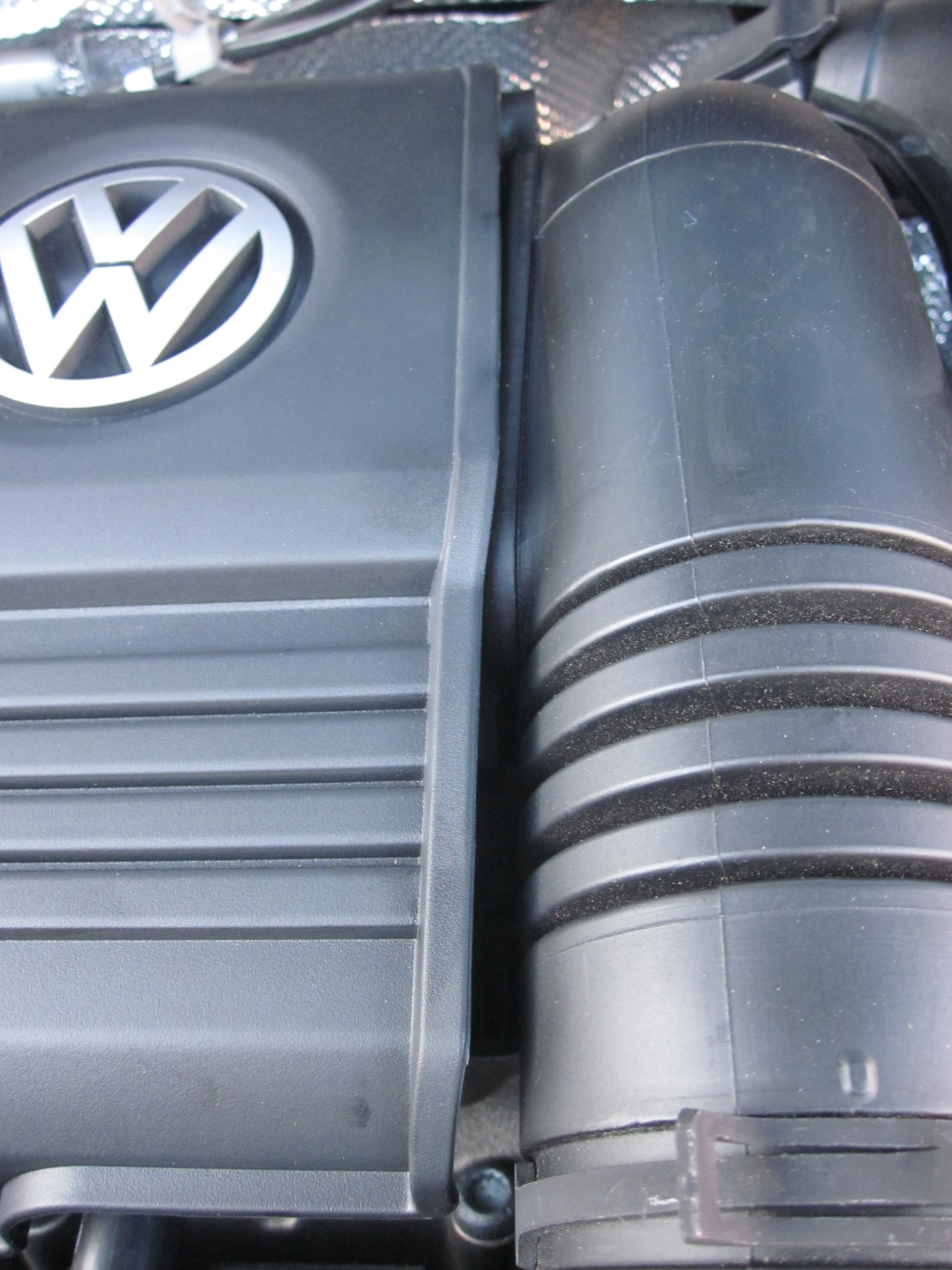

Not quite as advertised.
At least its hidden under the bonnet so no one can tell I've cheapened the car by fitting a VW badge :D

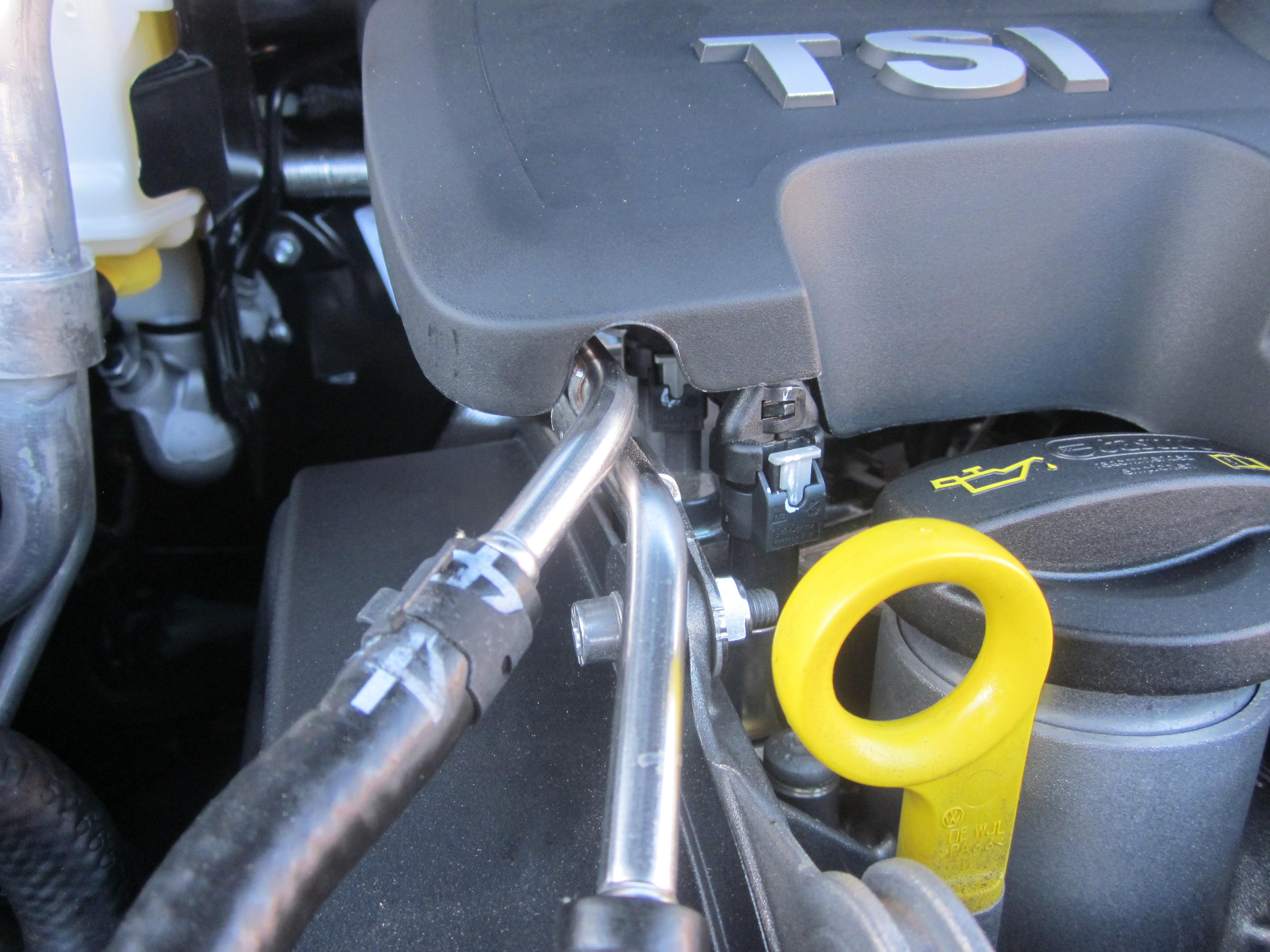

Dead easy to fit, took less than 5 minutes. All the holes and lugs are already there so it was designed to fit. The supplied bracket sits under an existing bolt used to secure a heat shield so I didn't even need the supplied screw...
Cheapy badge off eBay to cover the VW badge!

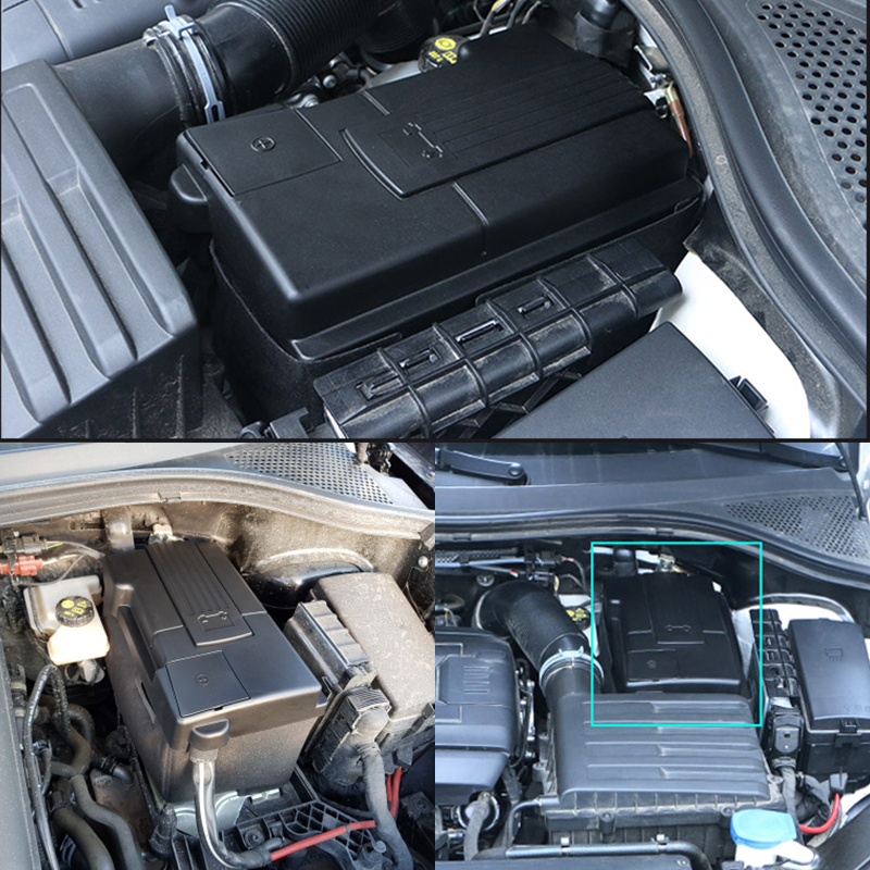

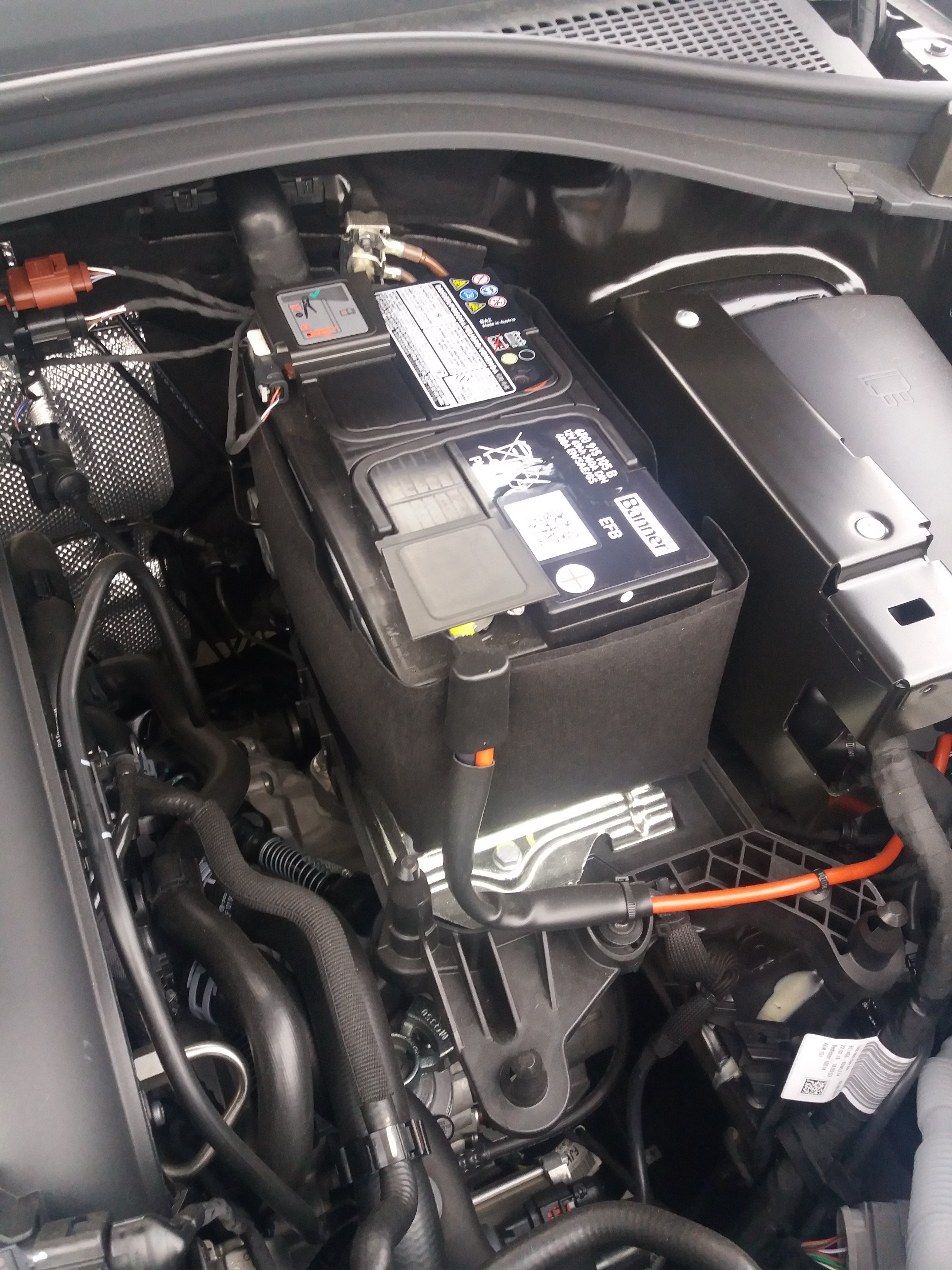

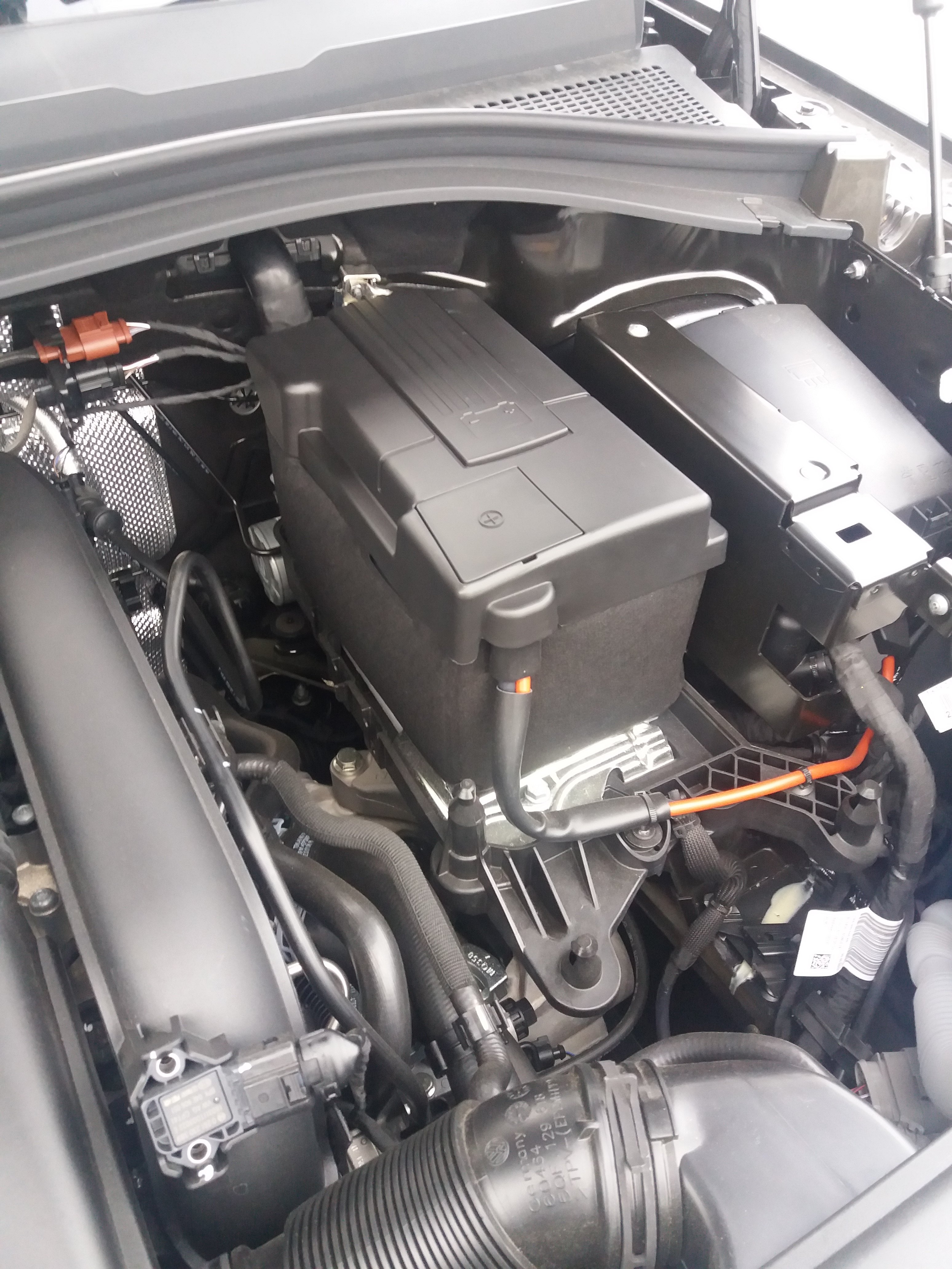

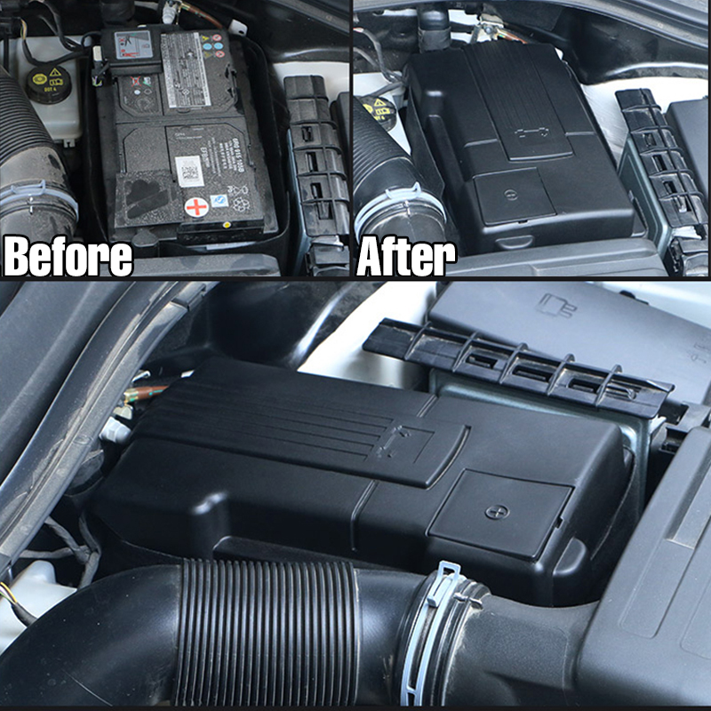

The latest chunk of Chinese tat arrived today, and was promptly fitted :D
Before...
After...
Certainly looks the part. Where are you finding all this stuff?
Aliexpress, a haven for all things cheap and Chinese.
Proceed with caution :D
How is the battery cover fitted?
Have you ordered any other tat since?
It just sits on top, it's a pretty tight fit though.
