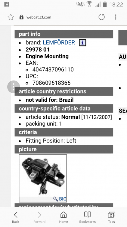

Yet another posting on this subject, I have been checking part numbers of gearbox mountings as the one used with the 1.2TSI engines is very compliant and what I've found out is, the version of gearbox mounting used is the "AS" one and this version used to be fitted to 2002> Polo/Fabia fitted with the 1.4 3 cylinder TDI engines AMF and BAY, it was also fitted to Polo/Fabia fitted with the 1.9 4 cylinder SDI engine ASY.
The other version "AR" was used with all other engines, now my wife's old 2002 Petrol engined Polo had quite a stiff gearbox mounting, which is the "AR" version, so I wonder if retro fitting that would solve these clunking issues without adding in any unacceptable roughness getting through into the passenger cell?
It does look like VW Group needs to stop messing around and being cheap skates and maybe adding in another version of these mountings, ie less compliant than the "AS" version and slightly more compliant that the "AR" version, maybe buying/fitting an aftermarket, ie "poly" version is the answer?

ettlz, I have just been out to check the part number of the gearbox mounting on my wife's Polo, ie the mounting that was fitted at the factory in South Africa as it is a RHD 5 door Polo, and that part number is 6Q0 199 555 AR - now as I've written earlier, the current EKTA parts listings shows that that car should be fitted with a 6Q0 199 555 AS if/when that mounting is replaced, so I was wrong in my assumption that that car presently has a 6Q0 199 555 AS and it might be better to fit a 6Q0 199 555 AR!!  So as both these variants of gearbox mountings have existed since 2002 it is true that they are used with different engines in the earlier Polos etc, the 6Q0 199 555 AR being fitted to normally aspirated petrol engines and 6Q0 199 555 AS being fitted to 1.4TDI and 1.9SDI derv engines - and not just an update of an earlier part, ie AR being updated to AS.
So, which variant of gearbox mounting is now fitted to your Fabia, I would think that it had a 6Q0 199 555 AR fitted at factory, that was removed and greased and refitted at your first garage visit and then they replaced it with a 6Q0 199 555 AS variant - can you check up if that is the case, it is easy to read off the gearbox mounting part number from the engine compartment, thanks. (how you can successfully grease a one piece rubber mounting with a steel bar bonded into it beggars belief, but as you found and I did, that is the first step to stop that clunking, I'm still not sure if as in my case, copper grease was the smartest thing to use to stop any rubber<>rubber of the same single piece, making noises when contacting each other), I'm guessing that the clunking comes from the rubber element hitting off the front/rear of that mountings steel frame on maximum movement from the nominal position.
Mine currently has the AR variant.
I don't know how Skoda are dealing with this, and I can't check as the VW Group on line parts listing I use has not been updated to include the MK3 Fabia or the similar Ibiza, but, from looking up the VW Polo section, the correct gearbox rear left - ie the large top mounting, it is the AS variant that is now listed to fit if/when replacing it. Checking the older 2003 Polos, the AR variant still is the part to replace that mounting on a petrol engine car, and the AS variant is the part to replace that mounting on a TDI and SDI engined car - so both versions still exist and there are situations where the AR is still the "correct" version to fit on replacement and situations where the AS variant is still the correct one to fit on replacement - and in the case of the 6C Polo with the 1.2TSI where the AR version was fitted at factory, the advice is to fit an AS version on replacement, I just hope that my dealership replaces that AR version and replaces it with a new AS version just to see if that helps at all.
