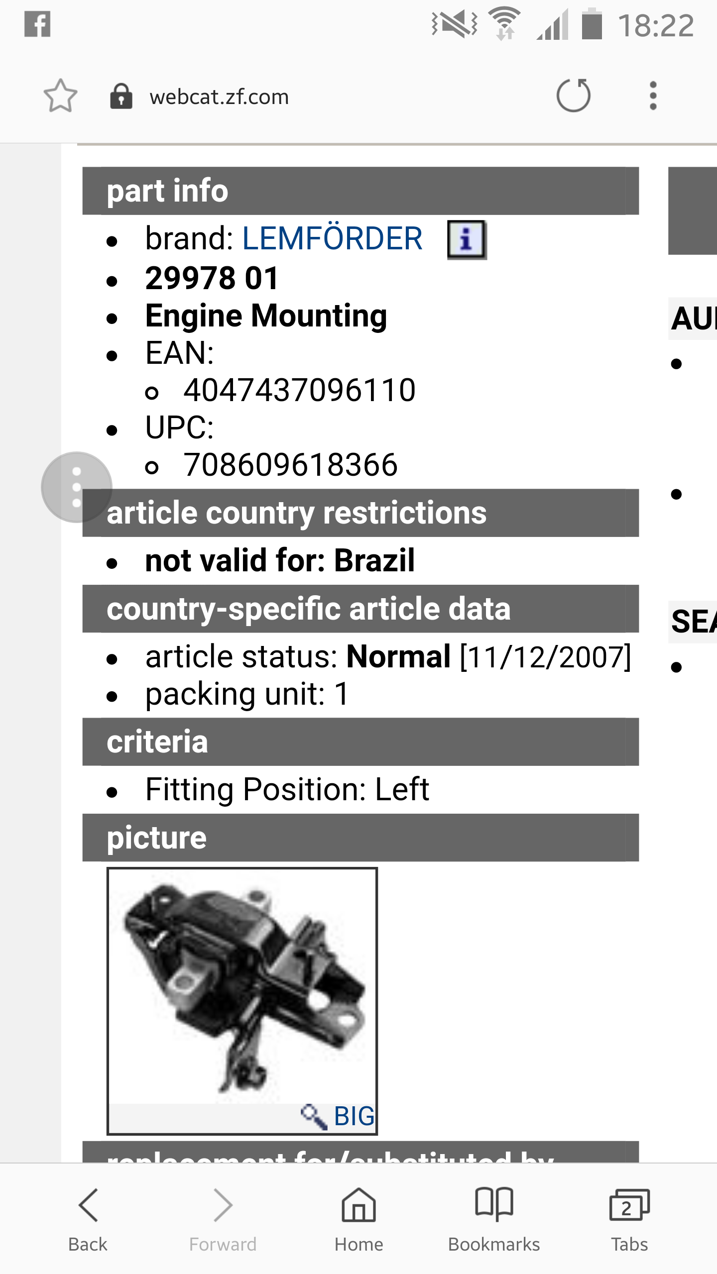

Hi,
can you attacthed a link for the correct engine mount for mk3 that you used ?
i started experince the clonk also at 44km, i moved recently to a city with very rough roads.
29978 01 is part number of Lemforder engine mount for Skoda Fabia III 1.2 TSI 110 PS.
I seem to remember thinking that Lemforder is a supplier to VW Group as the VW Group part numbers get grinded off these item, also there is a cross referencing to the VW Group p/n on that site I think.
That number covers both the 6Q0 199 555 AR versions and the 6Q0 199 555 AS versions of the VW Group part, the AR version was originally used on petrol engines and the AS version was originally used on TDI engines.
My wife's August 2015 VW Polo 1.2TSI 110PS originally had the AR version but after be reworked to get rid of the clunking, VW fitted the AS version which I'm guessing is a harder rubber compound.
Edit:- to me this is strange as I'm guessing that Lemforder is an original supplier to VW Group factories, but for that supply contact, it was supplying 2 different versions of this mounting which are identical physically so probably only different in the hardness of the rubber used, and now in the aftermarket they are supplying one part number which is okay for replacing either mounting!  There is a third mounting out there with a VW Group part number that is 6C0 199 555 B, but so far, Lemforder is not offering a suitable replacement for that, plus I don't know were this third version fits in in stiffness relative to the other two versions.
