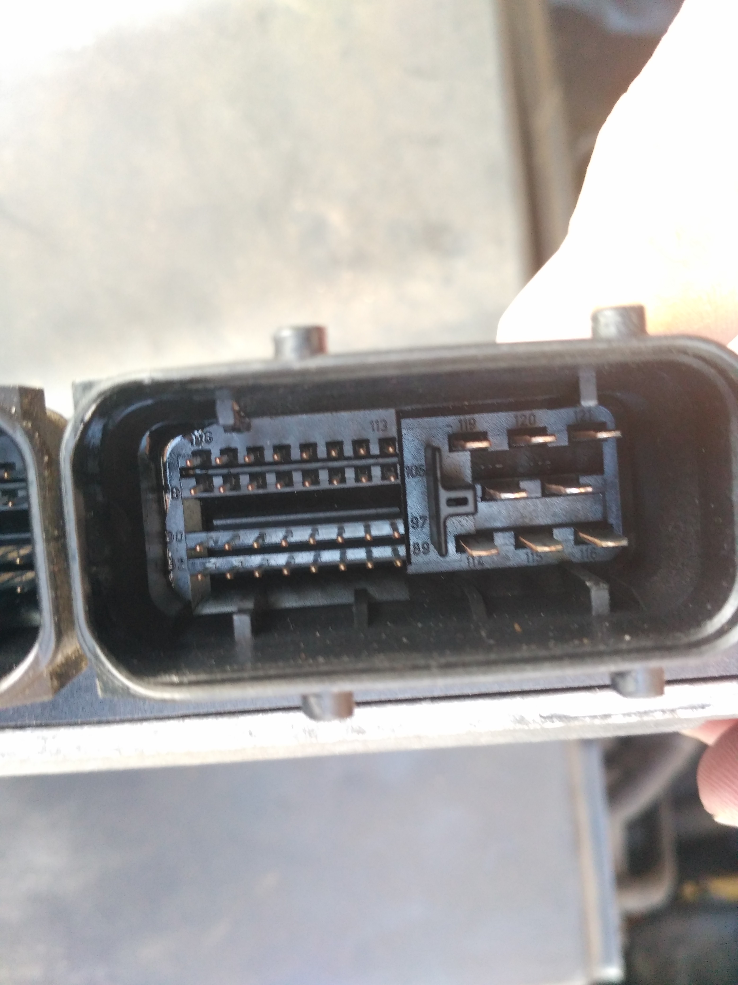

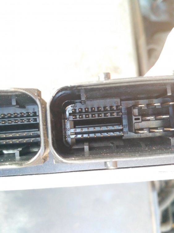

IMG_20180615_184821.thumb.jpg.d7703cae6f9109c1cdda50f83ab44d8f.jpgIMG_20180615_184812.thumb.jpg.d1a28f595459383bf86fa674550a1f49.jpgMy prime suspect is pin 106, followed by 98 and 99, and possibly 82 83 84. More fluid today than yesterday. Definitely in that lower end of the connector. Could be migrating within the connector I think from the source.
I think it's not petrol, oil or washer fluid, therefore coolant, power steering or brake fluid. Thanks very much for the pins.

Try to get a sample of the fluid onto a clean white rag/tissue.  Coolant should be the only pinkish one, I think, and my favourite candidate.  See if there's fluid inside the connector of the coolant temperature sensor.
