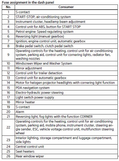

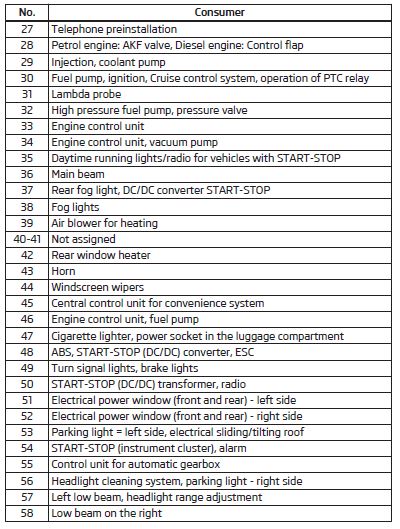

Check fuse numbers:
23 - 'side lights'
53 - 'Parking light = left side'
56 - 'Parking light = right side'
Capture.JPG.01edf139711079502a99e59d36ac8c86.JPG     Capture1.JPG.305dfb0c4c9739cc76f9b03a398fb6a6.JPG

Funnily enough, it was the #23 I'd suspected as broken that solved it all.
No idea how interior lightning and side lights should affect this...oh well.
