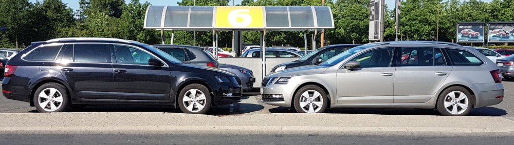

Received my brand new Octavia (the face lift version) in November 2017 - and noticed that my ride seems higher than that of the newer Octavias ever since...
Se picture for reference (mine is black, the "low" one is grey)... The grey represents the VAST majority of the cars in my country (Denmark)... Only a few look like mine.
Has there been an update in the suspension specs or has my car got a "wrong" set mounted?
I prefer the looks of the lower octavias compared to mine... Mine looks like Skoda had no clue reg. tolerance chains and just added plenty of gap to absorb potential wheel/bumper clash...
Does anyone know if there has been a technical spec update which resulted in lower cars since i got mine? Do I have a case for a warranty job here, or should i rest my case?
(Octavia height spec sheet says 1460mm and always did - but it's hard to measure that accurately)
//gkev
Rough road package car on the left, no rough road on the car to the right?

Might be - although i did not order that specifically... Is there any way to identify whether the package is mounted or not? An ID number or a special feature to look for?

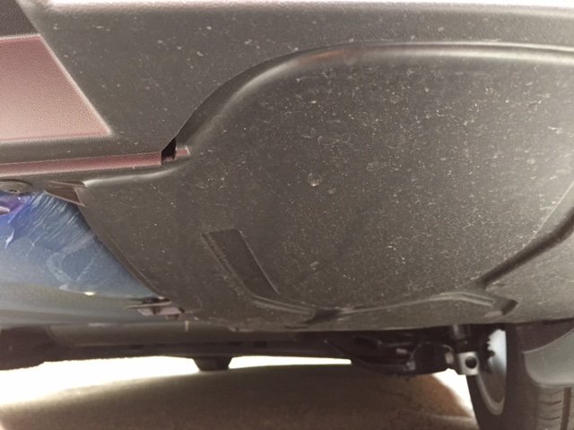

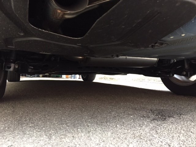

So, i had a look underneath the car this afternoon... Is this it? is this the Rough Road Package? The whole floor seems covered except for the exhaust pipe...
Se the pics (taken from the front, facing the rear) below. If this indeed is the RRP, can this be the cause of my high ride?

Indeed it is. :)
You have just gotten yourself additional equipment free of charge. Should be thankful to your dealer actually. Springs can be always replaced with shorter ones, but this nice protection stays. Actually, since you're half way to Scout, I would look around to Scout factory wheels and buy them for the summer set.
Wow there you see... so this is positive i guess... having received the RRP without it being requested.
Changing the springs to "ordinary" ones will probably change the suspension feel then i presume?
Thanks to everyone for solving my mystery.
Springs and shocks would need changing to revert to normal probably. Could also affect alignment which is fixed at the rear, factory set. I've read comments that RRP is a little softer than standard and less crashy.
RRP is an option I would tick if ordering new.

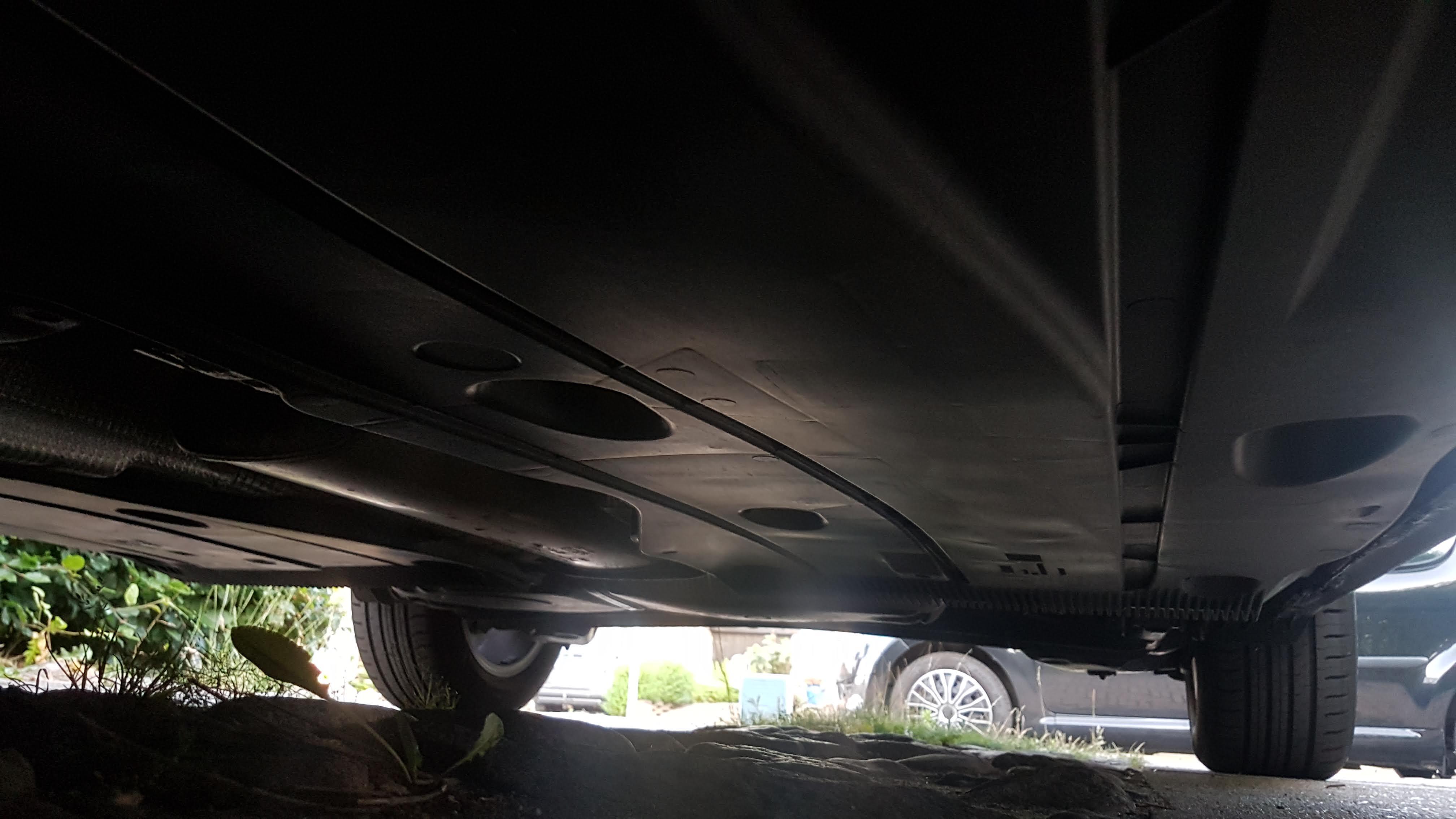

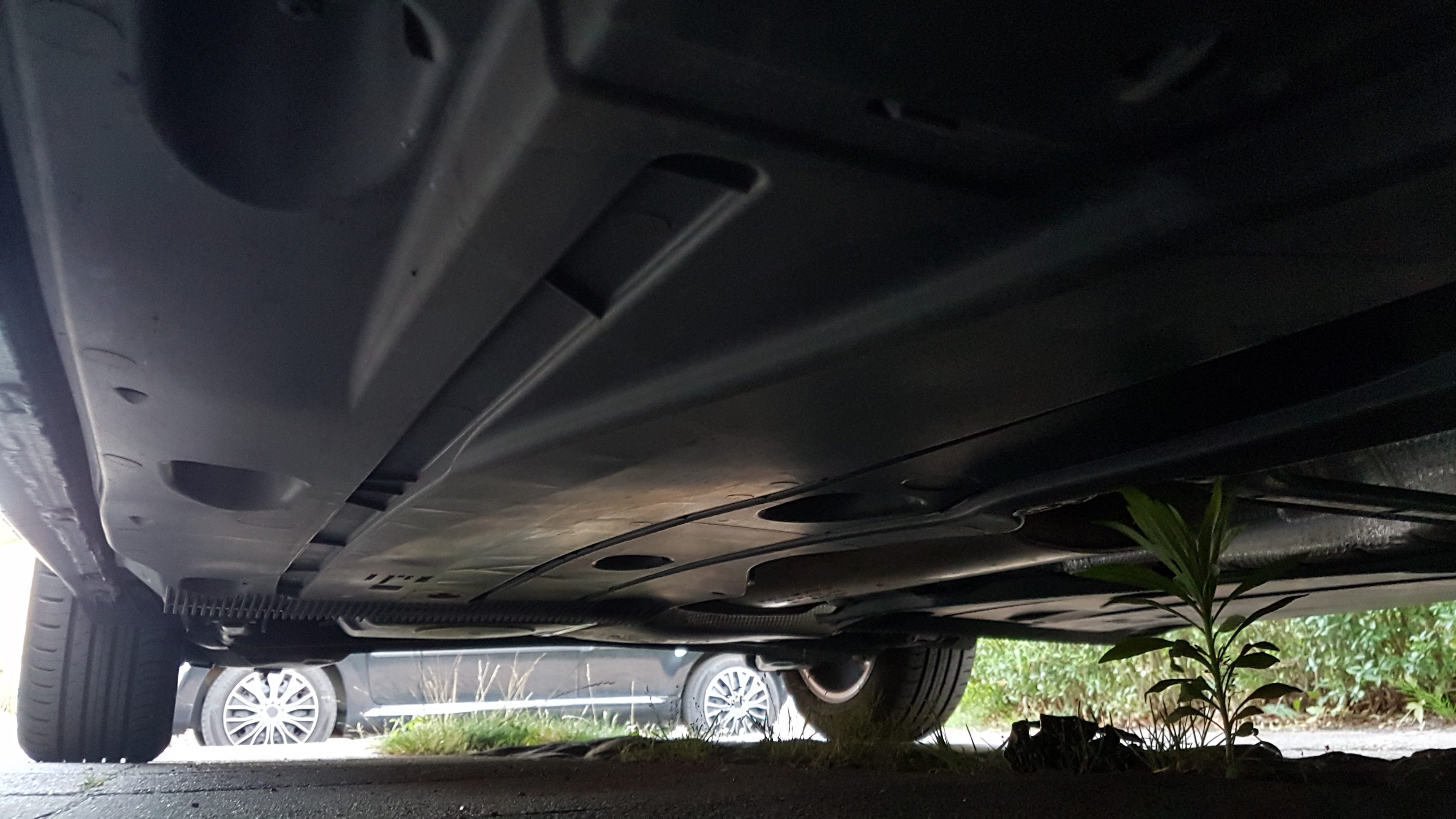

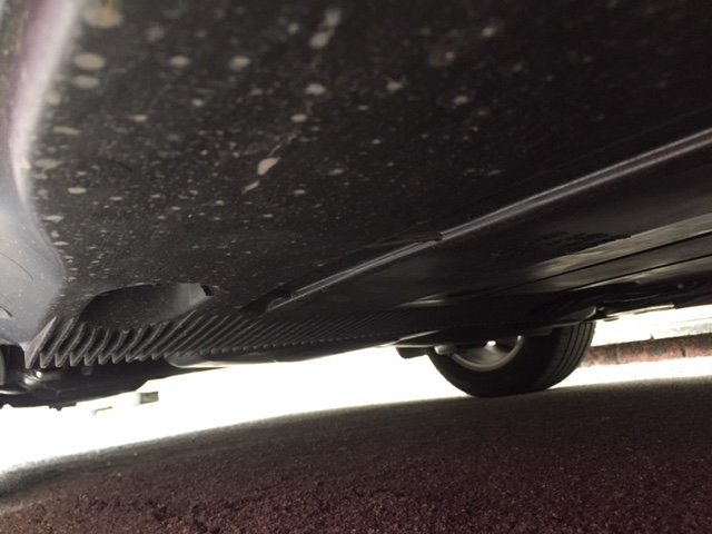

It would seem my new Octavia Estate also has this (sorry for poor pics).
