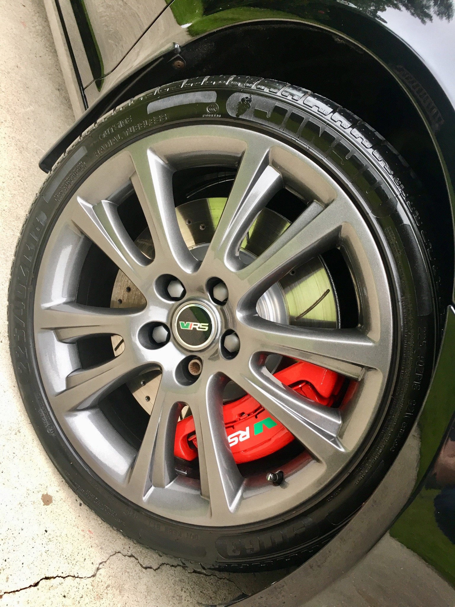

I have fitted 345mm set up to my mk 2 and it’s such an improvement
@Paulbrown Have you got details of what you bought and fitted please?
