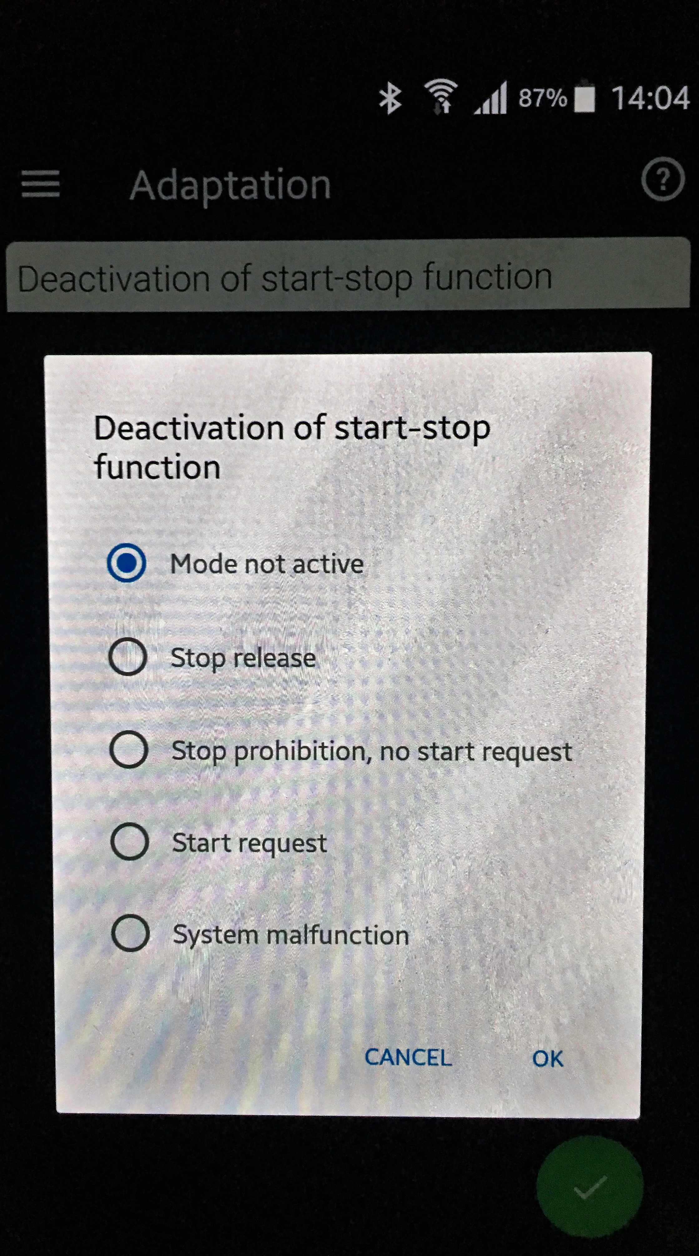

Does anyone know what is this adaption for from 19-Gateway? What are the options in your case?
Edited by ccosmin
