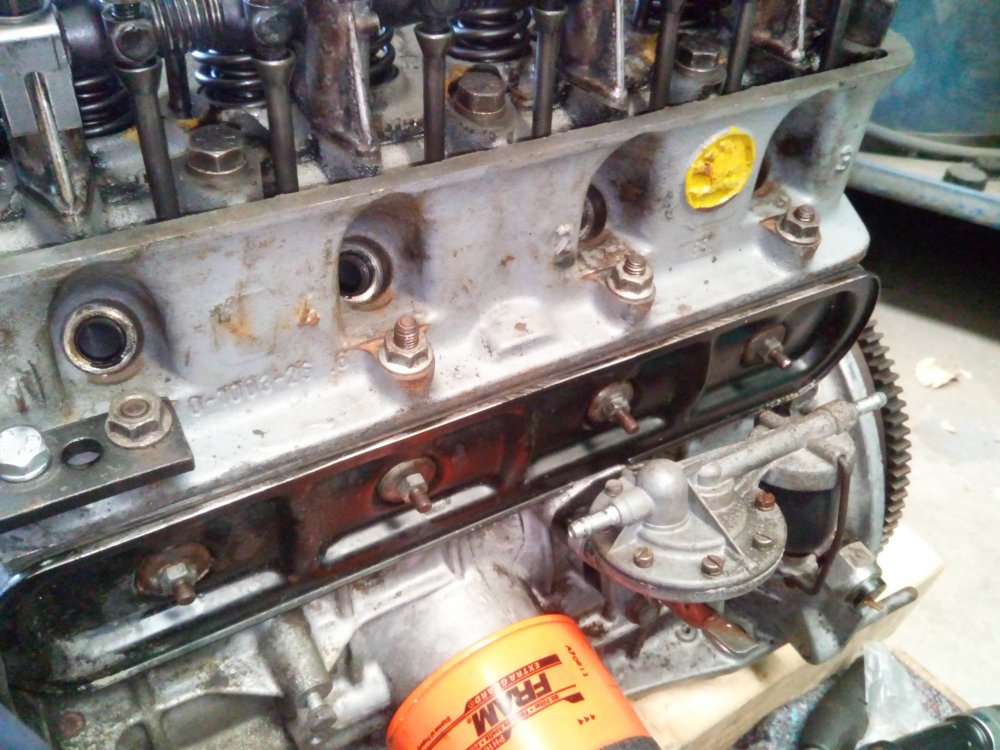

One more question:D.  These 4 nuts.. Do they need 55nm. Or only 28nm. It is not correctly specified in the haynes workshop manual:/
Without digging out the Haynes manual I can't advise on exact figures but I work in lb ft not NM and I add 10 lb ft to the Haynes figures. The nuts are not nearly as crucial as the bolts though.....you can pretty much do what you want and it won't make much difference.
Okey thanks mate.. :)

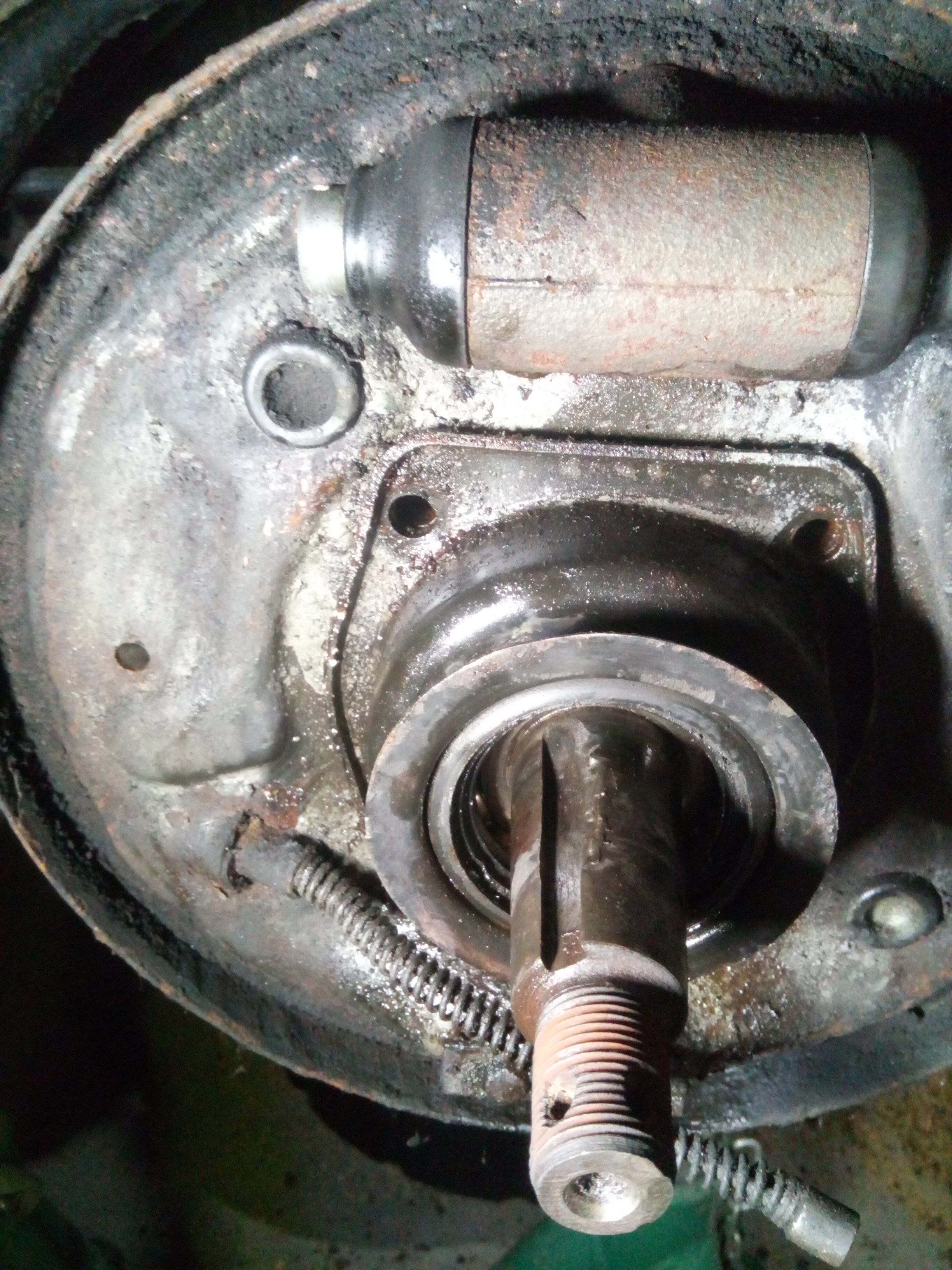

this tool mps-111 that I have to use to dissmantle the rear brake drums...  Is a hammer Ok to use? :D. I have new bearings and brake drums:)
Drum came out from right side just by a finger touch :/  which means the slot on the drive shaft en torn...  Next problem is that the bearing house is stuck:/
Any good tricks for it?
The drums sometimes do come off easily - it doesn't necessarily mean there is anything wrong. Gearbox wise.....I'm afraid I didn't build my own gearbox so I can't help. There are only 2 types though - trailing arm (usually 4 speed) and semi-trailing arm (usually 5 speed) and they aren't compatible without swapping over the driveshafts, rear arms and cross member.
I got a 5 speed and the new gearbox is from a 130 rapid so the drive shafts are different :/
but the drive shaft and bearing housing are still stucj on there :/  very sad

You must have a 120 L5 box which is a 4 speed box with a 5th gear added - they match up to the trailing arm set up - all other 5 speed boxes match up to the semi trailing arm set up. Why don't you just retain the gearbox you have?
sync rings are damaged, but I will just swap the gears around on the two gear boxes  it should be possible
but ofcourse I have to get it off the car first :D  which is a problem with these shafts :(
