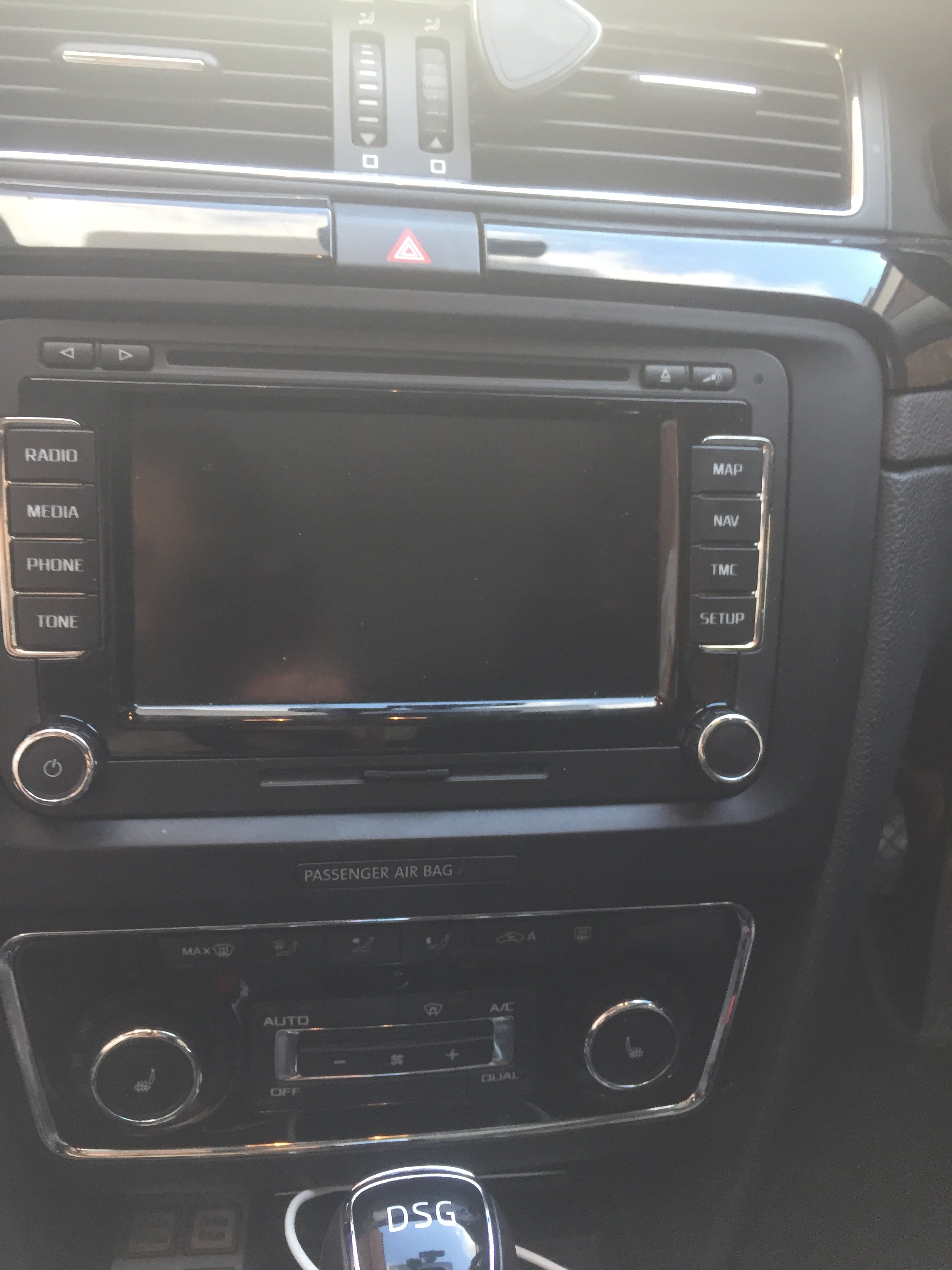

Scanning for faults is free mate, although as said above it's not likely to be the Bluetooth module at fault, more likely to be the head unit or possibly some wiring issue. What's the head unit in the car?
Thats the unit
A Columbus. If it's a fault with the Columbus I'll probably be able to fix it on the spot, or at least lend you one to keep you going if it needs to be left with me for any time.
