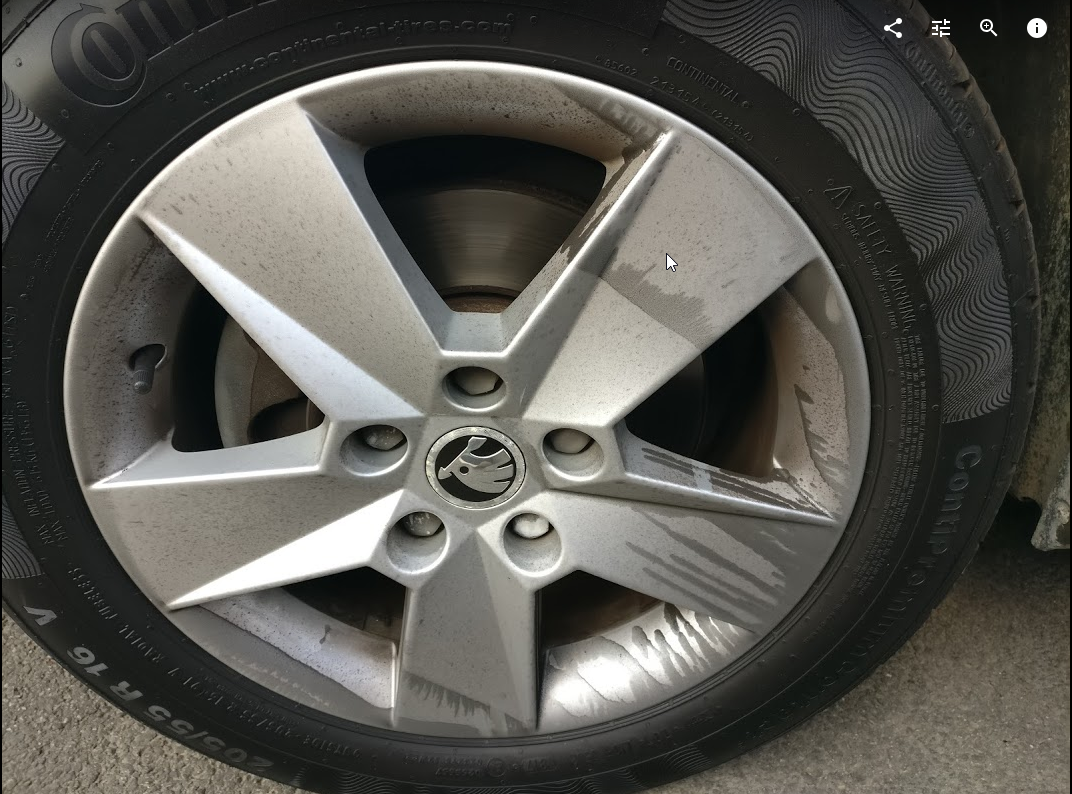

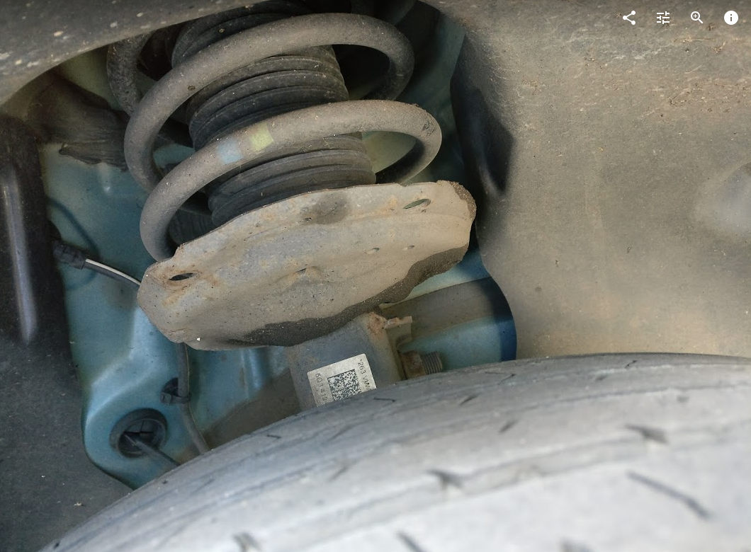

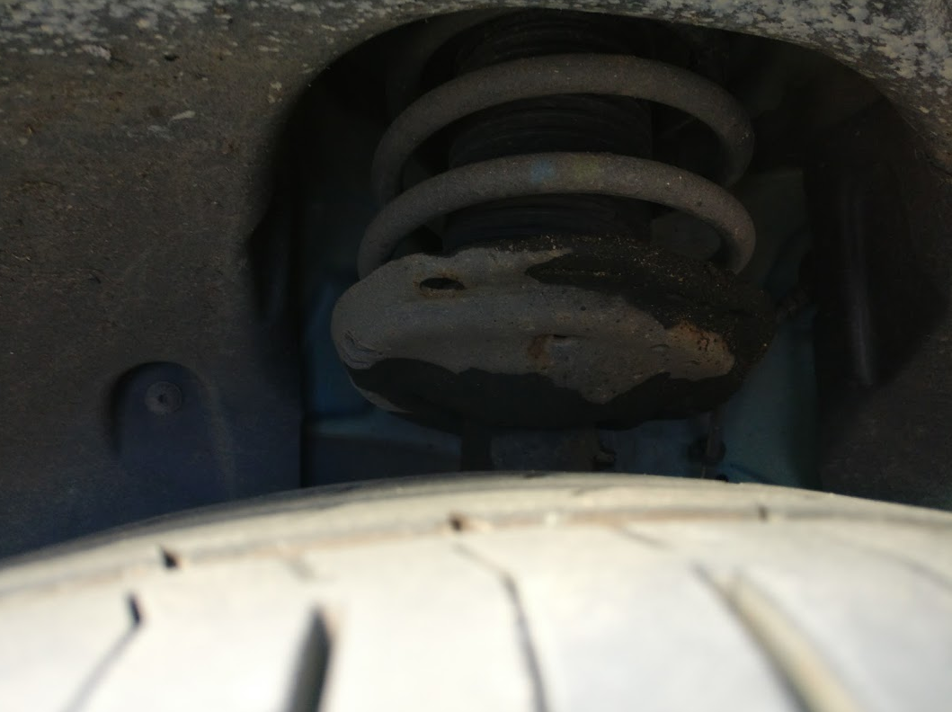

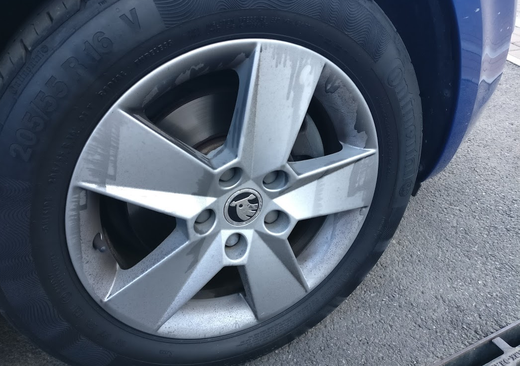

Just wanted to check if anyone has knowledge on what could be going on. I took the car to the dealers to take photograph of a leaky shock absorber for a warranty claim last Thursday (I did a major service a week before that) and after that noticed the steering having a bit more play (loose) than normal. On Saturday, I noticed there were oil stains on the alloy wheels. Does someone know what could cause this? I have attached some pictures of the same and the springs behind the wheels as far as I could get to without any other equipment. The brake fluid seems to be still above max level and engine oil is also ok.
That looks like tyre dressing has been applied a bit too liberally, and has run onto the rim and attracted dust.
Have you had the car cleaned recently?
You could turn your steering to full lock and have a butchers at your track rods and callipers, just to be sure, but I'm with pistonbroke - looks like it's run down from the tyre, rather than run out from the inside.

Thanks. The dealers cleaned it as part of the major service a week ago. So it might not be the things I have been reading about like broken drive shaft cover or anything like that which is good.

Thats exactly what I thought when I saw it.  Tyre dressing has liberally been applied and then not allowed to dry before being driven.  The 3rd pic clearly shows that some form of dressing has been applied to the tyres if you look at the sheen where it says Continental at the top left of the pic.

I had exactly the same thing on my Volvo a week after we collected it & were holidaying in Italy.
The high températures at the time (like you have in the UK now) caused the tyre paint to run leaving the same marks on the alloys as you have.
Its really difficult to clean off & in the end I had to use some of the chemical Wheel cleaner stuff which I dont like doing).
