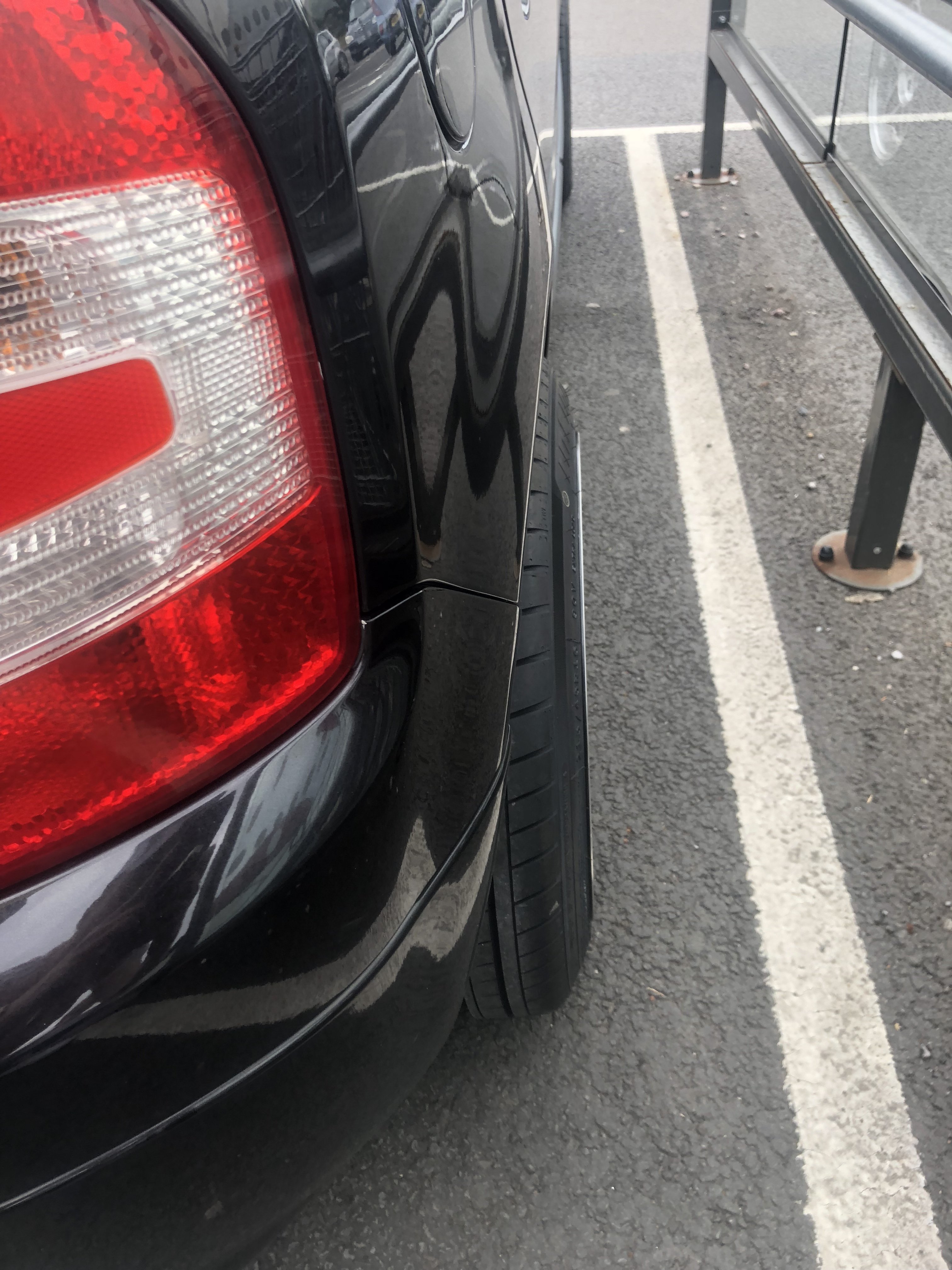

Hey as it says in the title I need to get tires for my new wheels. They’re 8J on the front 9J on the back 16s? Will be dropping it down 40mm so need fairly low profile has any got any ideas please? Can’t seem to find it anywhere and garages are useless

Hey just an update. They fit and plenty of room! I had 215/45 on there in the end!
@al3xhumphr3ys - Well, I said you'd have to "go stretch" and you have! Also, I'd expect the local "wooly suits" to pull you over for chats about wheels regularly, and keep a watch on the outside shoulders and arch lips for evidence of contact.
