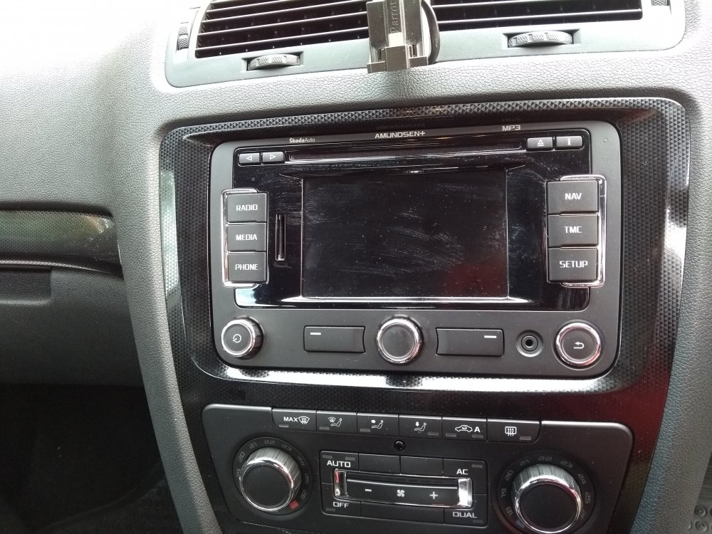

Hello everyone
Does this radio have blue tooth?
Can I play my Spotify / Google music through system ?
Thanks
What happens when you press the phone button?
Have you removed the unit and looked for a sticker which says: MAC: 00:00:00:00:00:00 or similar? If I remember correctly, if they aren't all zero's it has BT built in but may not be enabled.
Nothing happens mate ,.nowt at all
Was this  retro-fitted or came from factory directly?
I think direct from factory

Not sure - but normally factory options for bluetooth of that generation would have the BT module under the passenger's seat wired to the infotainment.
have you checked for anything like?
Pretty sure the blackline came with the Amundsen+ as standard and it typically can support bluetooth. It just isn't enabled by default.
You need to check the unit for a sticker saying MAC as I mentioned earlier. If it's present and non-zero, then you'll need to add a microphone and have the car coded to enable bluetooth. It can certainly do hands free but I'm not sure about streaming.
Currently, the phone button should just work as a mute button :)
Might be worth adding where you are in the world as a local member with VCDS can probably help.

Is it possible that the MAC address can be read by entering long-pressing setup menu?
I have a VRS Blackline that came with that.  It doesn't have Bluetooth and you will need the VAG Bluetooth module and will need wired in to the mic hole beside the courtesy light unit.  Will probably also need it enabled in VCDS.  I removed mine and put in into my wife's Fabia and I moved got my Columbus unit transferred over from my old VRS, along with the VAG bluetooth unit.
BTW - the VAG Bluetooth module is expensive, but more affordable when bought 2nd hand on ebay, but is the best solution.
Amundsen + units may or may not have Bluetooth. Also they may or may not have DAB radio, and they may or may not have the input connector for the rear view camera.
Generalised statements are pointless really as the next unit someone posts up a picture of will probably have different options. The only way to tell specifically for Bluetooth (as Langers has already pointed out) is to look for the MAC address on the sticker on the side.
The Blackline unit does have blutooth but it is not activated from new as i have a Blackline also. I had the dealer activate it by plugging in and bought the mic and plugged it in and all works good. Even play my music from ipod or iphone via bluetooth through it.
