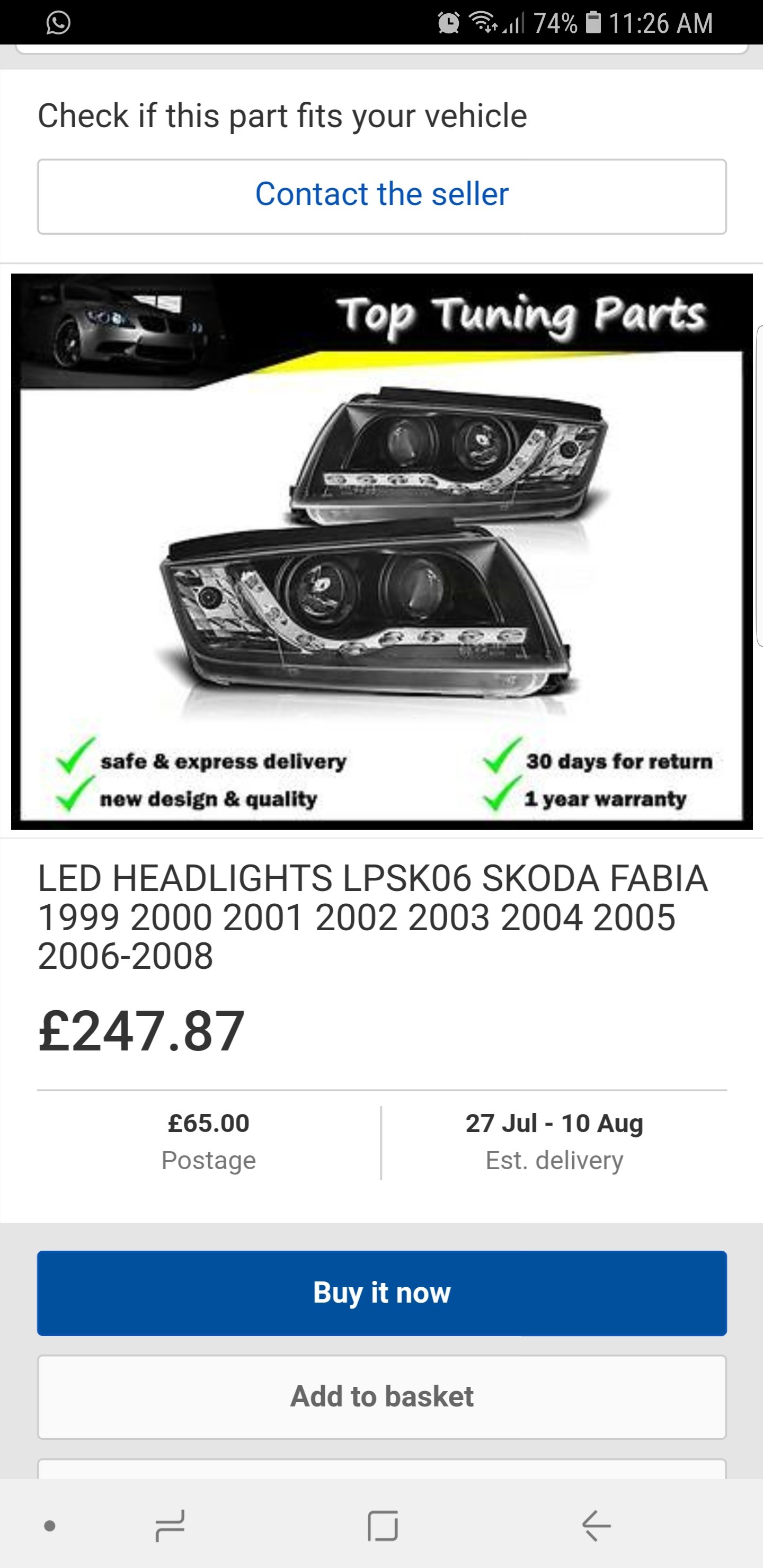

So I have a left-hand drive Skoda Fabia 2007 and I was looking for custom headlights. I found these ones on eBay.
So my question is:

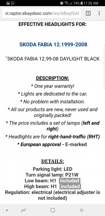

This headlights say are only for right-hand drive Skoda while mine is a left-hand drive car. Would they fit on my car? O there is something that will not let it fit on my car?
Edited by ArthurD
@ArthurD - The dip cut off will be on the wrong side for your wrong-hand drive car. You should fail any form of roadworthyness inspection that applies.

Those are only LED for the daytime running lights. The actual lamps are halogen. Probably still crap though.
