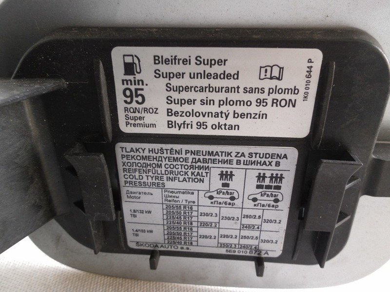

Is 95 ron not the minimum octane fuel for your car as shown on the Filler Flap?

Your Superb's filler flap should actually say that 95 is minimum octane that could be used in your car.
There are world regions where there are Skoda / VW Models that do show lower than 95 Octane as 'Minimum Octane' that can be used, New Zealand is not one of those though.
