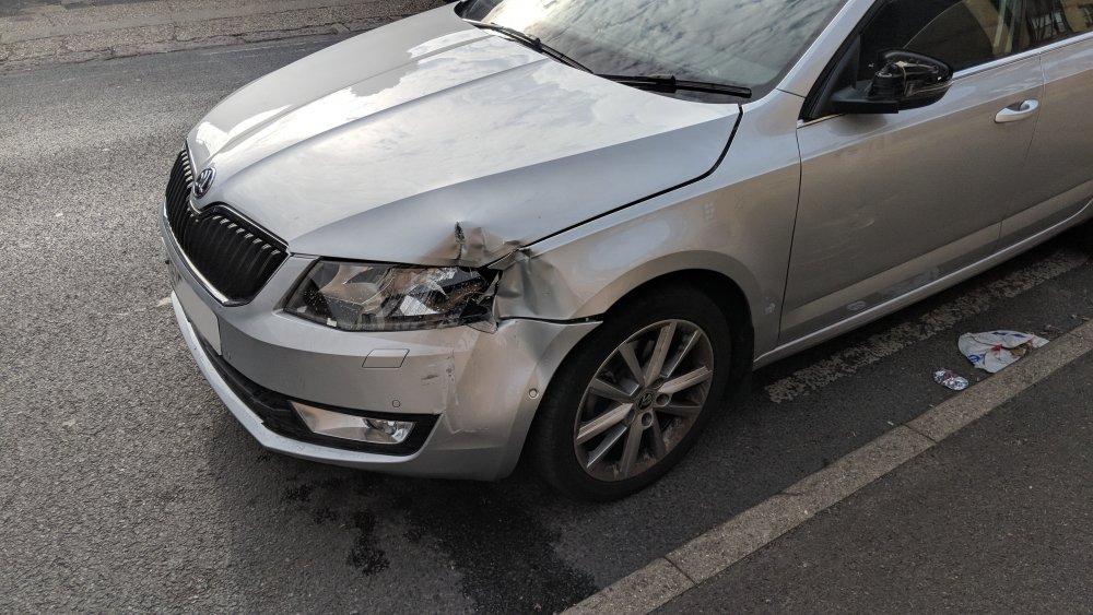

I've sadly been in an accident involving the driver of a parked car who spontaneously opened his door just as I approached at low speed. The damage is quite spectacular as can be seen in the attached photo. What you can't see in the photo is that the windscreen is also cracked as the wing mirror glass came off and flew into the car hitting the front windscreen. Also the car wet itself going through the ordeal i.e. there was water all over the damaged headlight and on the ground which is probably a washer fluid well under the hood rupturing.
So the reason for the request for recommendation is simply that this is clearly more than simple bodywork damage. The bonnet now doesn't sit properly, the headlight is in bad shape, lord knows what damage may have happened to internal components under the bonnet, plus damage to the techie parts of the car i.e. park assist sensors, electric wing mirrors, the passenger window refused to one touch close, it would reach the top and come back down again, and then windscreen has the clever rear view mirror attached. I'm just a bit worried about the competency of 3rd party accident repair garages that get offered by insurance, to identify and properly rectify all issues that arise from this accident.
Do I have control over where I get this fixed? Or do I just have to take up what the insurance company offers? Am i worrying about nothing or should this go to a proper Skoda garage to get fixed?

Looks like my concerns were not ill founded. The sensors all round the car is what worried me and it's exactly the same thing that's being cited in this article.
My Octy has park assist (and associated parking sensors) and my bumper has clearly been damaged, as well as Adaptive cruise control and associated radar unit which lives in the front bumper. This is all tech which I love and rely on so much and can't afford to go wrong after they do the repair.

So that Autocar article I posted is very telling of the complexity involved and I'm not wrong to think this should go to koda or a fully Skoda approved garage.
I suspect there will be quite a bit of work around the bumper to take it off and replace it. Taking the bumper off means properly handling the parking sensors and radar on the front which will need to be fitted back properly and will need re-calibration which is complex and expensive. If new sensors will be required they will need coding to the car at the very least.
There seem to be three category of repairers, 1) Insurance approved but not manufacturer approved; 2) Manufacturer approved third party 3) Skoda Garage
The first option I feel I shouldn't touch, second sounds decent enough - called one approved third party today and they said the approval is a non trivial and they get checked regularly by the manufacturers and are acutely aware and familiar with handling the above mentioned complexities and have the equipment to do this. The Third option is a bit harder as I don't think I'll find an Insurance approved Skoda garage.

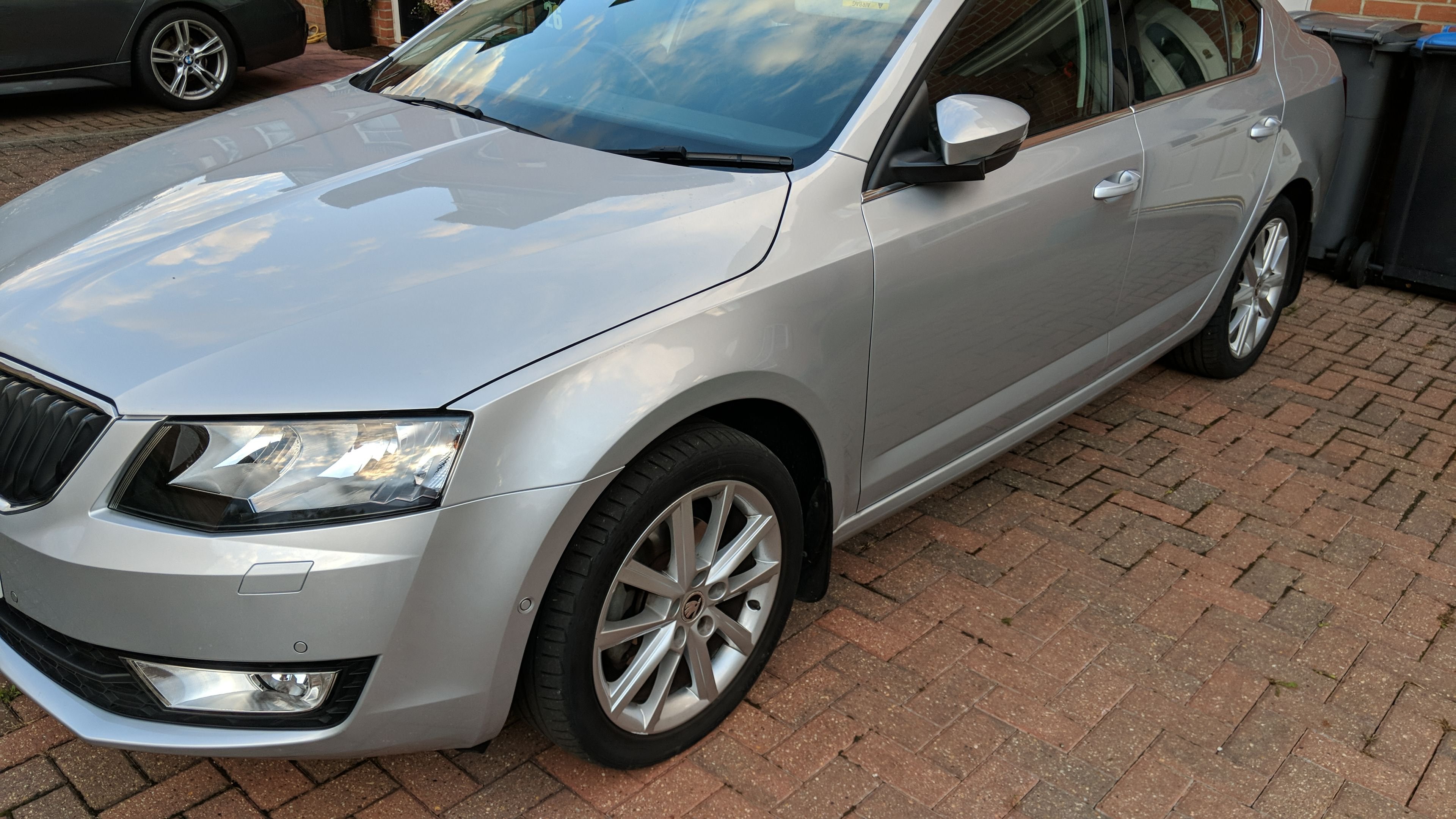

All sorted and like new! Great job done by Twickenham Accident Repair Centre.

Great news!
I hope you find that everything works as it should.

So far so good! Checked a lot of the things before taking back the car.
Obviously couldn't test the Front Assist Radar but they said they had it calibrated along with wheel alignment which has to be done as part of calibration. So just have to take their word for it. Took it on an A Road on the weekend and switched the maxidot to show car in front distance and seemed to be fine and didn't warn unexpectedly or slam on the brakes, so that's a good start.
...Take it somewhere nice and quiet and try a few emergency stops. Listen out for unexpected noises and keep an eye on the warning lights, too. Try at slower speeds, working up to, I would suggest, a min of around 30 but preferably 50 MPH*, if you can find a decent quiet place.
There should not be anything out of the ordinary happen at these fault modest speeds. Might also be worth doing a few very fast move-offs, too!
* I am NOT suggesting you break the law so find a suitable place. :whew:
