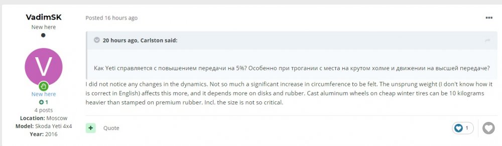

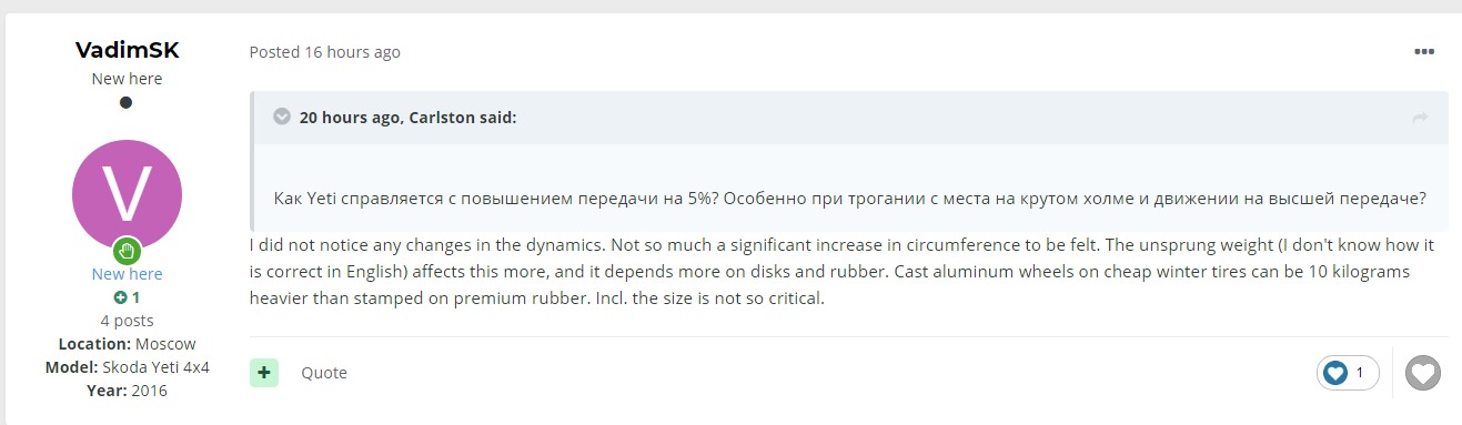

1 hour ago, VadimSK said:
I did not notice any changes in the dynamics. Not so much a significant increase in circumference to be felt. The unsprung weight (I don't know how it is correct in English) affects this more, and it depends more on disks and rubber. Cast aluminum wheels on cheap winter tires can be 10 kilograms heavier than stamped on premium rubber. Incl. the size is not so critical.
215/65R16 также будет хорошим выбором увеличенного размера, возможно, он будет установлен на диски 6.5Jx16 ET43 от Skoda Karoq. Есть хорошие шины AT (All-Terrain) такого размера, которые помогут буксировать караван по илистому полю.

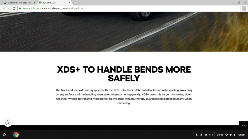

On 21/01/2021 at 13:15, Schtum said:
With VCDS dear James, dear James, dear James. With VCDS , dear James, dear James, with VCDS.   (It is still panto season isn't it...? :D)
More seriously, this procedure is thus....
In VCDS Select Control Module, go to (03) ABS Brakes, then (10) Adaptation, go to Channel:
Channel 09 Brake Assist (This will then activates Channel 36)
There are 3 settings:
0-center (stock setting)
1-small
2-hard
Channel 36 XDS
1-weak
2-strong
HTH

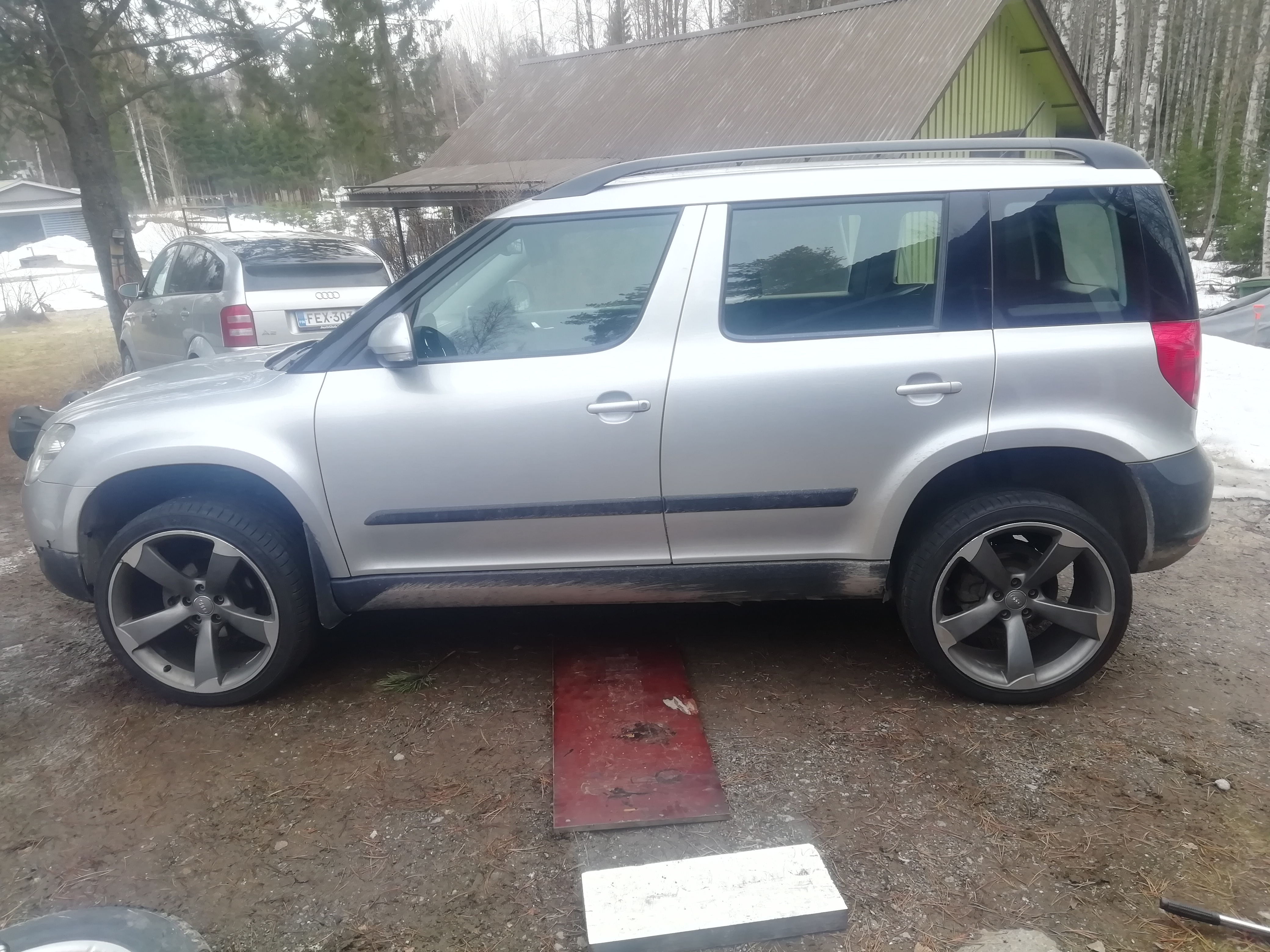

I had to try.
Didin't fit.
20x9
255/35/20
