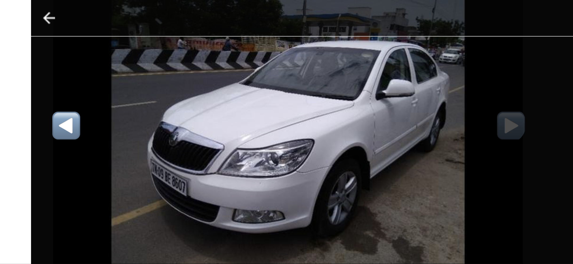

Hi what’s the strut diameter for my Skoda Octavia II 1.8 TSI 6speed manual 2010 model car?
I want to buy FK AK street coilovers and they are asking this question.
50 or 55 ?
I have attached my car picture 928295AD-96C7-45AF-B66D-0CAB3E2D58EF.thumb.png.2166ae62d65f980d0f18bb3c965cdf46.png
depends on your front brake disc size > 312mm or 288mm = 55mm struts   and 280mm discs = 50mm struts
Thanks a lot
so I should get 50mm because my disc  is small 283mm
You could always measure it ;)
Or even get a full list of PR-codes which will confirm, I think PR-G02 is 50mm and PR-G07 is 55mm for an Octavia...
What's the part number of the current shock absorber, that'll help too!
