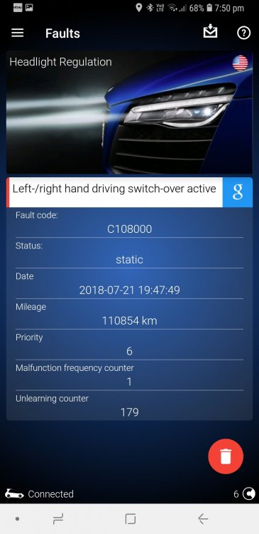

Checked and cleared most of stored faults, but I have a C108000 code come up I can not get rid of
Any ideas? Screenshot_20180721-195100_OBDeleven.thumb.jpg.47d42e658de59cccafc6d333845172db.jpg
Check in the infotainment settings under Vehicle and lighting the travel mode setting. Sounds like the beam pattern switchover has been activated. Should say "left hand traffic" for UK, suspect it's currently set as Right Hand traffic.
Thanks it appears it was
