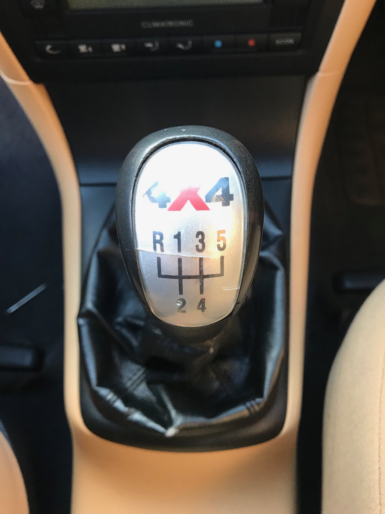

Got a pic of the gear knob?
It looks like I go into 2nd gear ok on the video, but it doesn`t even feel like its moving into a gear, if you know what I mean and you can see the shifter doesn`t self centre either... and even stranger there is a 6th gear...  when its a 5 speed gearstick.

I have a 4x4 too with 6th gear. Its an easy job to swap the gearbox alot of owners did it to improve mpg but not many swap the knob as they are hard to find and expensive.
